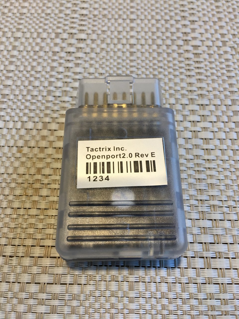

    Have a read. http://blog.obdii365.com/tag/toyota-techstream/
    I
    use this dongle. It’s the same one OV tuning uses and available on obdii365.com and is around $30. The Mini VCI won’t give you full access.
    okcowboy and French Avocado like this.

    Curious....what changed from a year ago when you initially recommended and then pulled recommnedation ? Have had a Mini VCI for a few years and it's held up well but always looking for better suggestions if they exist !
    Solution for the Mini VCI Diagnostic Cable not reading data
  9. Sep 22, 2021 at 9:26 AM
    #2229
    Ruggybuggy
    Ruggybuggy Seasoned Veteran
    Sep 23, 2019
    #36508
    3,692
    Dave
    NW ON, CANADA
    2016 Tundra OR
    I have both but the mini VCI was inconsistent in providing all the data. It was very much a hit and miss. The Openport is very reliable and is also the one OVtune uses in their programming.

    There are clones of the Openport that are junk. They work perfect for about a month then go dead. The one I bought from obdii365.com has been going strong for more than a year.

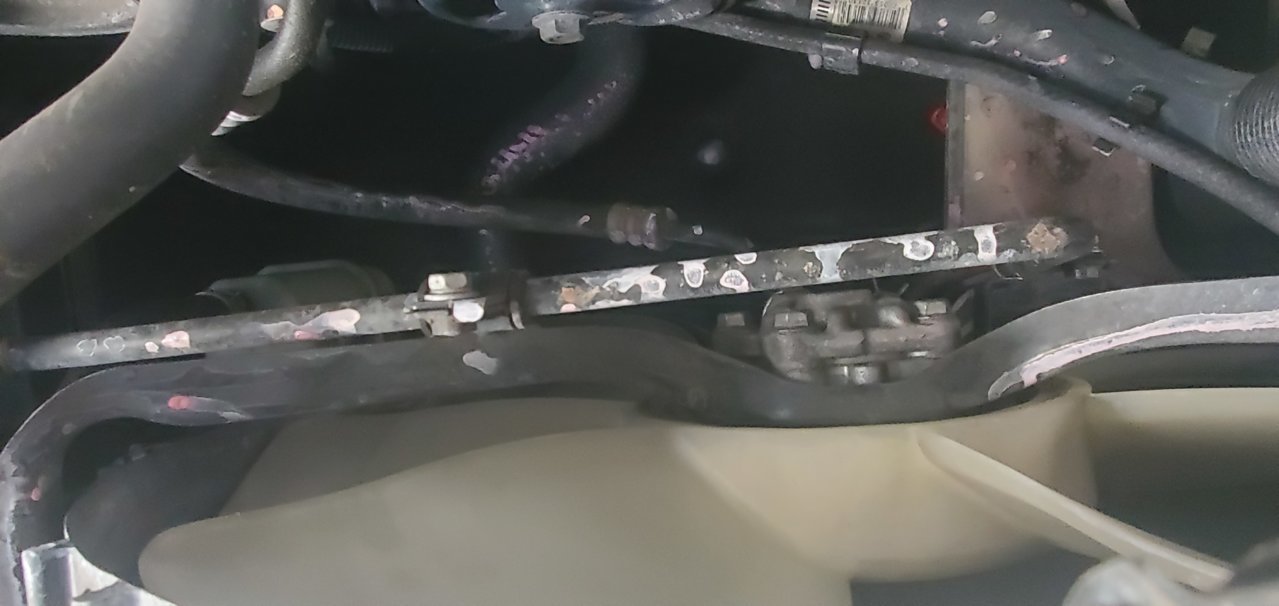

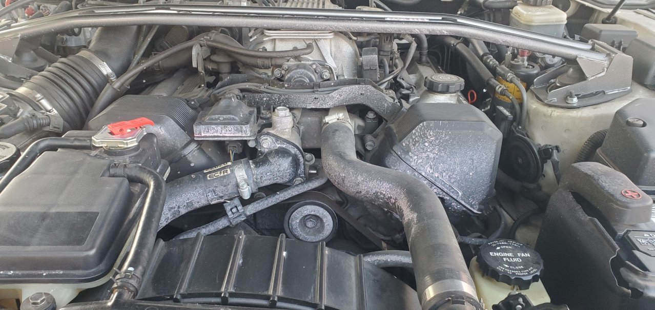

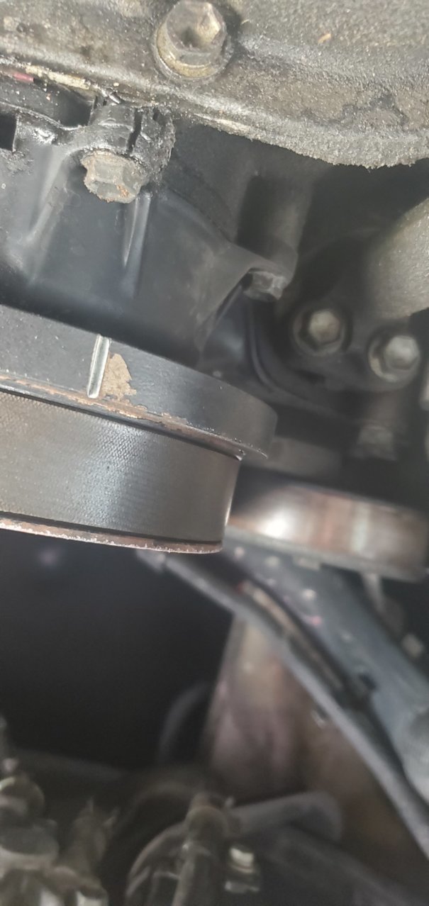

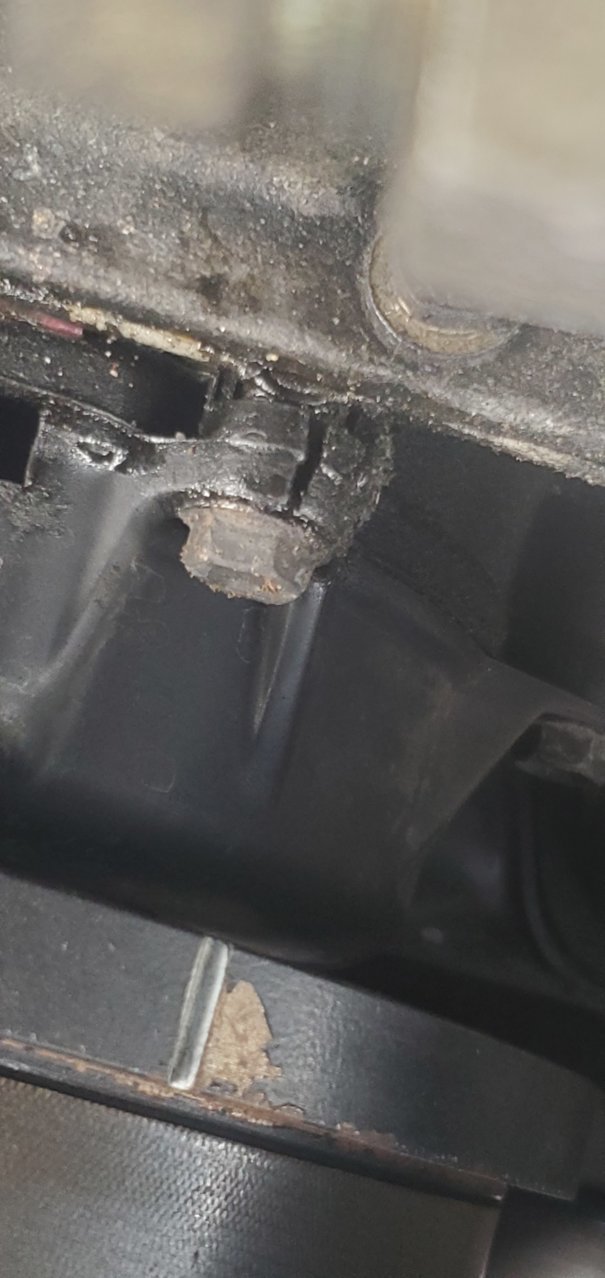

    Do you know if I should worry about this? Its behind the harmonic balancer 1uzfe.. doesn't appear to leak anything, then again the pan is caked..

    Honestly… no. It shouldn’t hurt anything unless the covers rubbing the pulley. The cracks typically are there if the little sleeve has gone missing from previous timing belt replacements

    If the leak is antifreeze the water pump is probably leaking and you should deal with it. If the leak is oil and it is just sweating it’s nothing to be concerned about but monitor it. If it’s leaking and forming a drip the timing belt can become contaminated and should be dealt with. The crack in the plastic is from a missing spacer that was left out when the timing belt was changed, as already mentioned. If it was mine I would find the correct spacer and install. The bolt tightening up to the spacer is what keeps the bolt tight. If the bolt falls out the plastic cover could come out and contact with the harmonic balancer. The spacer is cheap, not so cheap for the timing cover.

    Awesome will look for the spacer... anti-freeze was scattered out by the fan.. that's next on the to-do list.. leaks when its cold..

    Do a forum search on Techstream to obtain a free copy. You will need an obd2 dongle. Some won’t work properly but look back a little on this thread and I’ve listed one that works perfect. GL.

    Hi I got the tactrix cable now, but seem to have issues with getting the right driver to work. Using techstream 64bit patched on wind 64bit. The mvci driver fails to install. Or do I just use openport 2.0 driver?

    Go to the Orange Virus Tuning website and download the software for the openport. That what I have been using since I had his tune for my Tacoma. When you open up Techstream you should see the option for the openport. The MVCI won't work.
