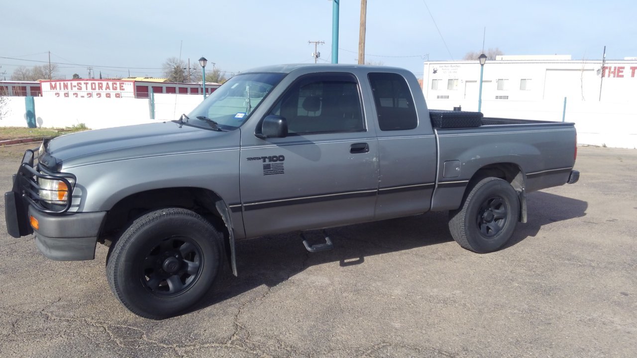

    Toyota related, not Tundra, '97 T100, right side of transmission, above the pan towards the front, just had transmission fluid changed dropped the pan, clean the screen out, now this is leaking, never leaked before

    I can't remember when the last time I worked on a T100. I thought most of them would have gone to the crusher by now.
    It's a coincidence that it's leaking now after the pan removal. The part that's leaking is for the band adjustment. You could remove the outside lock nut but make sure you don't change the position of the inner screw. Add a O ring to the screw and reinstall the lock nut.

    I was serious about the T100 being in the crusher. They had a serious rust issue and most of them have turned into dust. I see he's from Texas so that probably saved it. Wouldn't mind seeing some pictures.
