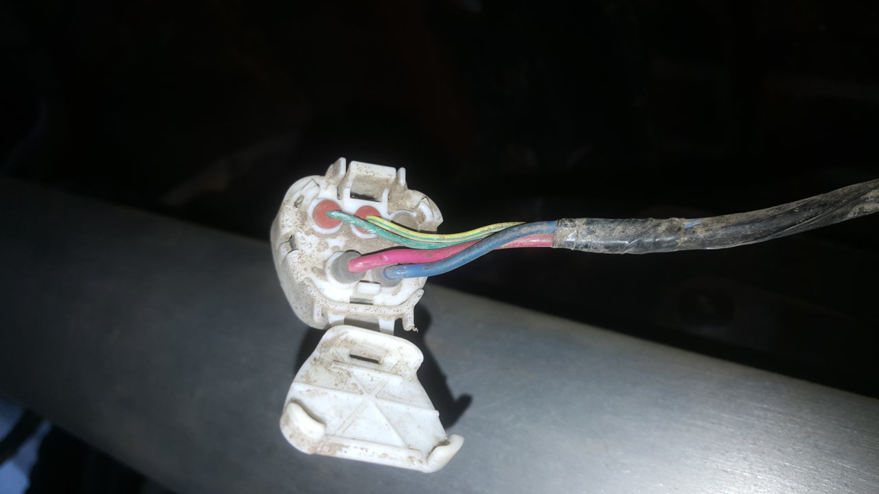

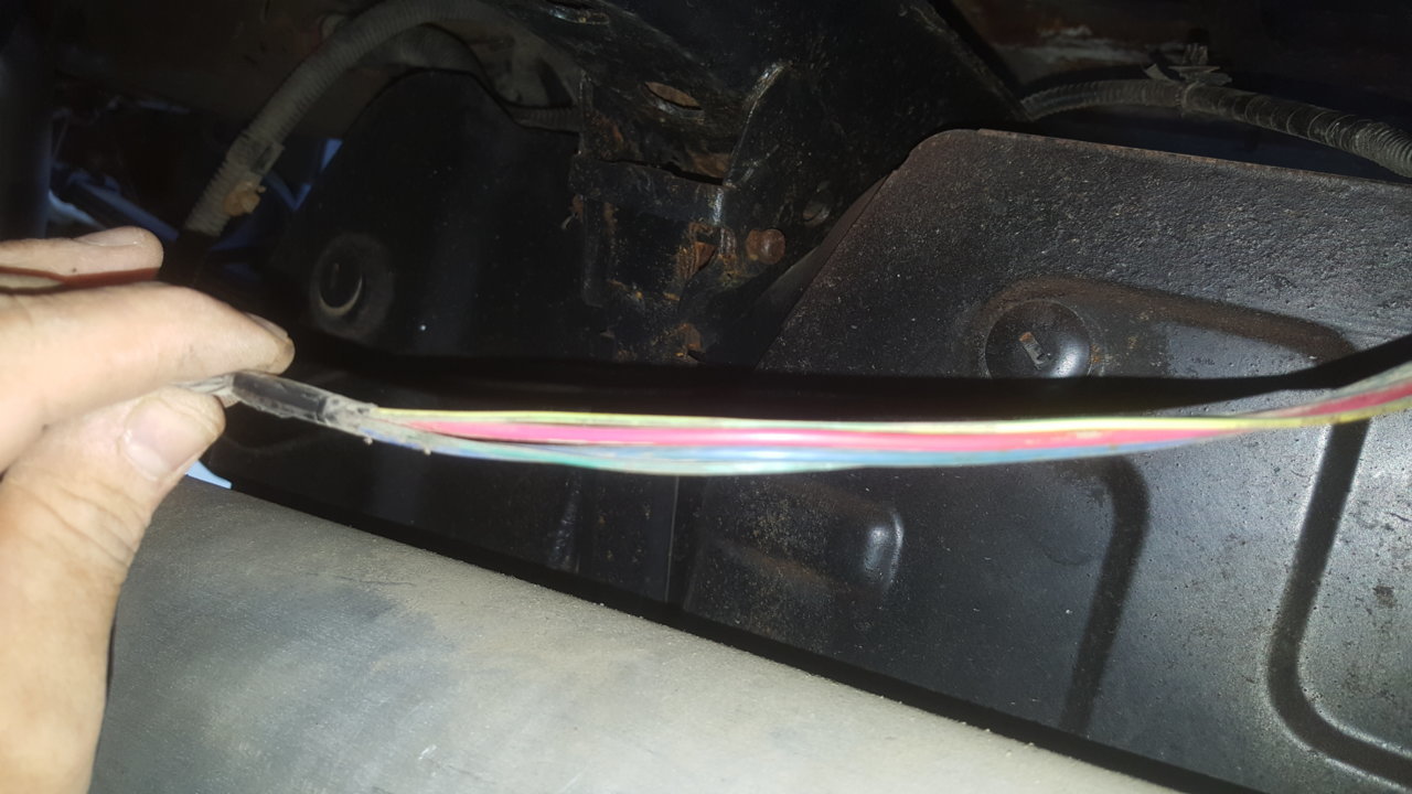

    So, I pulled the harness, pulled back the loom, no corrosion that I could see; the wires are in really good shape. I jumped from the fuel pump module fuel pump output directly to the pump and get nothing with key on. I also checked the resistance of the red and blue wire for the fuel pump and it's zero resistance, so I think the wiring is good.20200613_174309.jpg 20200613_174251.jpg 20200613_174245.jpg
  5. Jun 13, 2020 at 6:47 PM
    #1595
    Ruggybuggy
    Ruggybuggy Seasoned Veteran
    Sep 23, 2019
    #36508
    3,747
    Dave
    NW ON, CANADA
    2016 Tundra OR
    If I understand correctly. You did a resistance check between the red and blue wires while plugged into the fuel pump and get nothing, as in an open or infinite resistance? I'm assuming your testing at the module connector while its unplugged.

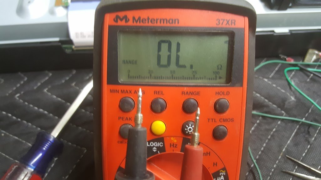

  6. Jun 13, 2020 at 7:24 PM
    #1596
    sandpiper
    sandpiper New Member
    Dec 23, 2018
    #23413
    18
    Resistance test red on both ends of the plugs and blue on both ends. Meter reads "OL" if no continuity, I get zero resistance through the 2 wires but have continuity. I took the red and blue wire out of the equation by jumping directly from the ECM to the pump (brand new pump that I know works) and the pump doesn't go on.
  7. Jun 13, 2020 at 7:45 PM
    #1597
    Ruggybuggy
    Sep 23, 2019
    #36508
    3,747
    Dave
    NW ON, CANADA
    2016 Tundra OR
    Zero resistance is an open do why do you think you have continuity?
    For shits and giggles plug the harness into the pump. With the other end apply 12V from a battery. Red to + and blue to -. Verify the pump runs.

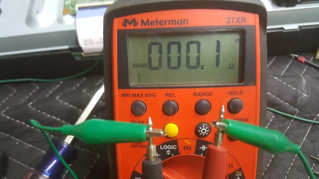

  8. Jun 13, 2020 at 8:07 PM
    #1598
    sandpiper
    Dec 23, 2018
    #23413
    18

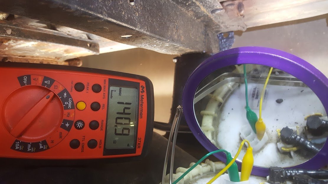

    I'm sure there is some resistance, my meter only goes to tenths. Meter will read "OL" for an open circuit, it beeps and give you the ohms of resistance when the circuit is completed; continuity (see pics)
    I did plug in the harness, no the pump doesnt run with key on. The new pump is outside of the tank, so i can access the soldered connections inside the pump. When I plug the harness into the pump, nothing happens, however, when I manually ground the negative side of the pump (red wire on connector/black wire in pic below), it runs.
    20200613_230333.jpg 20200613_230259.jpg 20200613_225838.jpg .
  9. Jun 13, 2020 at 8:33 PM
    #1599
    Ruggybuggy
    Sep 23, 2019
    #36508
    3,747
    Dave
    NW ON, CANADA
    2016 Tundra OR
    Your mudding the waters a bit. Plug in the harness to the pump that is installed in the tank. Use two thin wires and insert them in the connector end that would go to the pump module. Use a separate 12V source (spare battery) and try to run the pump. If the pump runs the harness, connector on the pump and the fuel pump are all good. If the pump doesn't run then we will look at the harness and pump circuit. If the pump does run them the problem is from the pump module and back to the ecu. I'm just trying to isolate which end of the circuit the problem is.

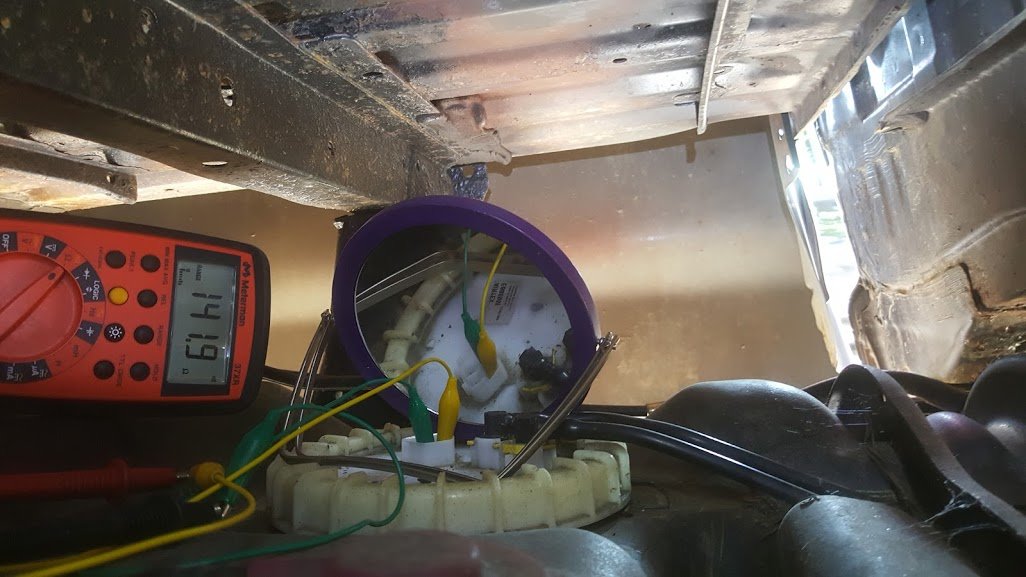

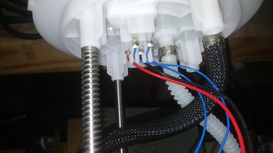

  17. Jun 14, 2020 at 7:53 AM
    #1607
    sandpiper
    Dec 23, 2018
    #23413
    18
    Morning,

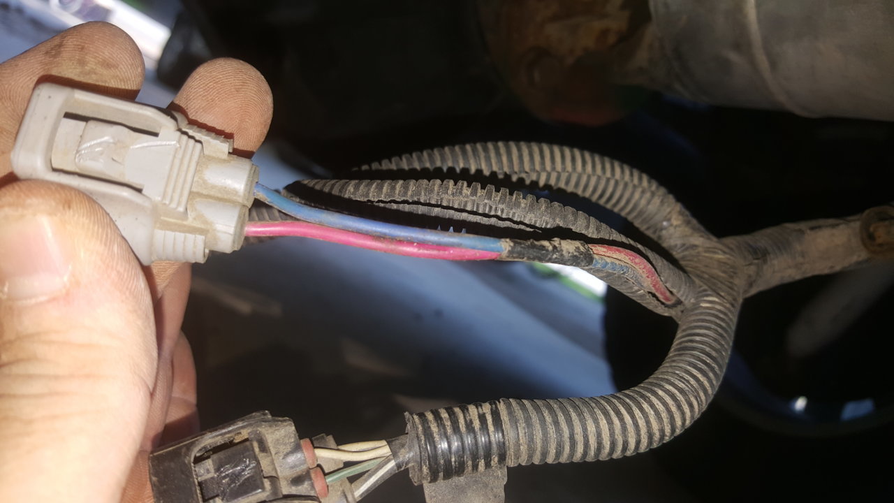

    So I applied 12v to the pump through the harness, then tried directly to the pump, still doesn't turn on. I did check the resistance across the pump leads (see pic) and it was 140 ohms, also, across the sending unit circuit, it was 161 ohms. I compared that to the new pump I have, and it was about 6 ohms (see pic).
    As a side question, see all that room I have? I know we aren't there yet, but if I end up having to, is It possible to get the pump out without dropping the tank? Ever seen that done?
    Thanks, Eric
  18. Jun 14, 2020 at 8:20 AM
    #1608
    Ruggybuggy
    Sep 23, 2019
    #36508
    3,747
    Dave
    NW ON, CANADA
    2016 Tundra OR
    Good morning,
    Now we are getting somewhere. You now know the problems is in the harness or the pump. Do one more thing. Plug your harness in the original Toyota pump that you have out. Apply voltage to the connector end. Does the pump work.
    Unfortunately the tank has to come down if you have to change the pump or the truck box has to be lifted off.
    I'm curious as to why the original pump was changed?

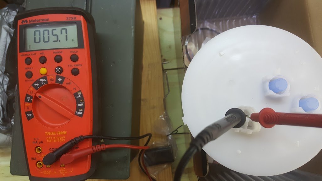

  19. Jun 14, 2020 at 1:11 PM

  21. Jun 16, 2020 at 5:59 AM
    #1611
    sandpiper
    Dec 23, 2018
    #23413
    18
    Morning,
    So I tested the new pump I have, out of the tank, when plugged into the harness and an external 12v is applied to the other end of the wire (connector that plugs into the ECM), it runs. So what's our next step?
    Yea, I dropped the tank when I changed it last time, just curious.
    So, when I bought the truck in December 2018 from a wholesaler in Philadelphia, it cranked, but no start. Replaced the fuel pump and that fixed the issue. It's been about 18 months and 8k miles since then.
    Thanks, Eric
  22. Jun 16, 2020 at 6:12 AM
    #1612
    Ruggybuggy
    Sep 23, 2019
    #36508
    3,747
    Dave
    NW ON, CANADA
    2016 Tundra OR
    Good morning,
    If you absolutely sure the harness is good then your putting the original fuel pump back in. It's the only thing left. Like I said before the Toyota fuel pumps are extremely reliable and removing that aftermarket pump would be a good idea. Sure hope your tank is almost empty.
