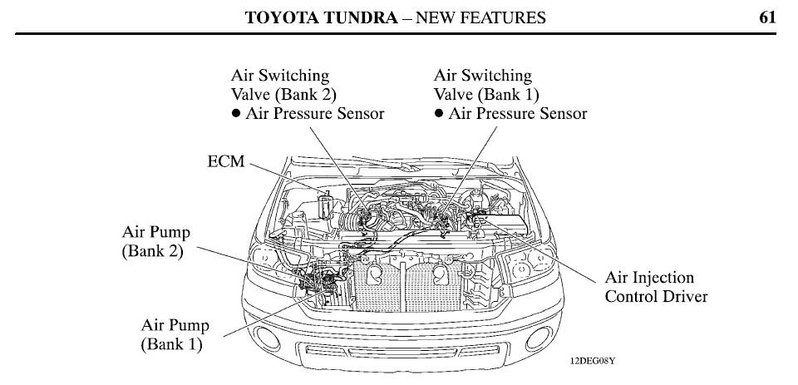

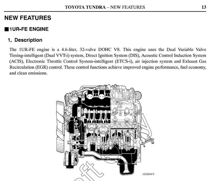

    I have the 4.6L. I looked at the Chilton repair manual and made my best guess as to which one to order based on position of the valve relative to the engine.
    Update, I cleared the codes 2 days ago and the code hasn't come back on. I'm hoping that the new pump cleared out any gunk that was stuck in the valve. I'm crossing my fingers that I don't need to replace that valve but I'll go ahead and keep the new one when it comes in just in case. "Hope for the best, plan for the worst."

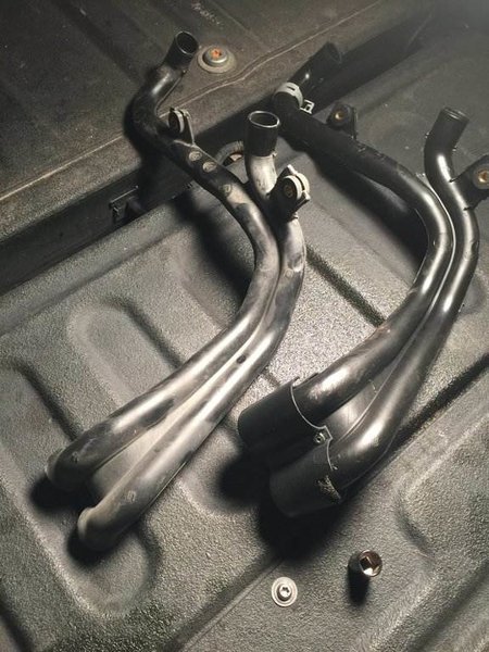

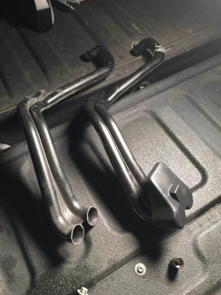

    Also, forgot to upload these earlier, this is the design flaw that has given us all so much grief. You can tell which one is the redesign to prevent water ingress.

    Cool^ we don't see many 4.6l around here... your valves are seperate? So one on each valve cover like the earlier 4.7?

    Yes, these were helpful that I found. Is 4.6L not that common?
