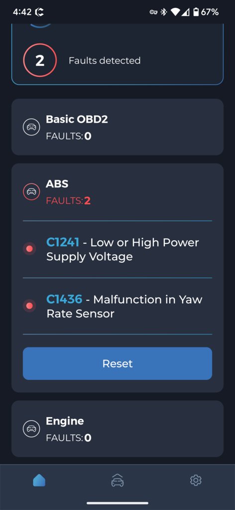

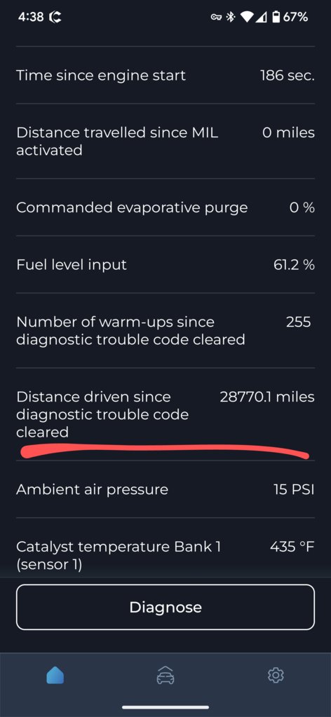

    Hello. I just ran a test on my odb2 and saw this. Should I be concern?
    I just bought the truck recently. No check engine lights, no problems driving etc. I'll run a voltage test tomorrow on the battery. But I think it was showing 13.6v on the app

    I would clear the codes and see if they come back. The low or high power supply voltage can happen after the truck sits for awhile and get a low voltage when starting. Yaw sensor failure would set a hard code and turn the light on.
    phabej[QUOTED] and Wynnded like this.

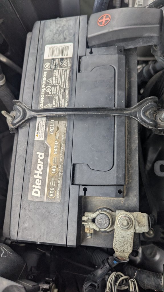

    As for the voltage, I tested the battery and alternator. It seems they are both good. 12.4v before starting the engine, 14.06v idling, 13.98v with lights, radio, AC on.
    Hopefully the yaw sensor doesn't pose a expansive repair of it lights up the dash.

    How old is your battery? Doing a voltage reading is not a good way to determine a batteries health. The proper way is a load test. When the engine is cranking it can drop the voltage down on an old battery to a point were it can throw codes. The yaw sensor sits behind the steering wheel clock spring (spiral cable) and is easy to change.
    If you know your battery is in good condition, just clear and see if they come back.

    I don't know the age of the battery. I just bought the truck a couple weeks ago. It doesn't have a month and date sticker on it either. It's a die hard battery.
    I'll see if I can reset the code with the carista app. That's all I have.

    You could stop in at an Autozone and have them test the battery. The truck isn’t turning on a light so I wouldn’t worry about it. If the yaw sensor was not working it would throw a hard code. If you’re really curious about it, Techstream can read the live data and you can see the yaw sensor.
