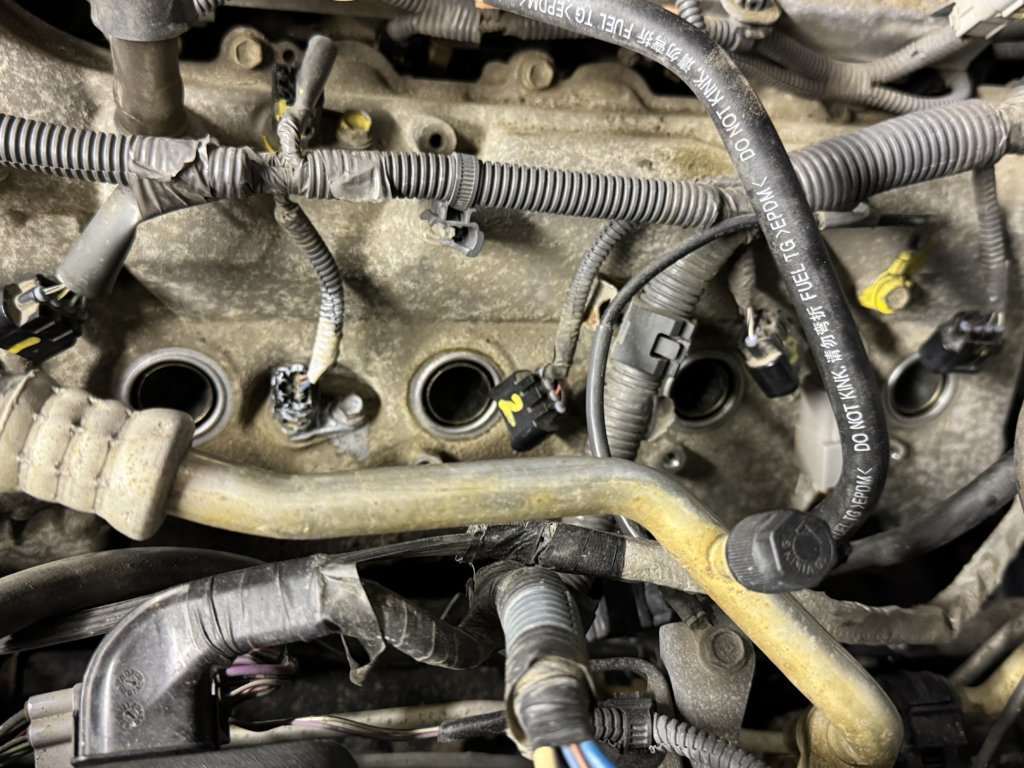

    I’m just now able to get into this. I ordered - FEL PRO VS 50742 R -gasket kit for the 5.7 valve covers and spark plug tube seals. I have oil in the #2 spark plug tube on drivers side. I’ll load pics. Here is what I think is the problem. It was suggested to stop oil from getting into the spark plug tube I needed to replace the spark plug tube seals which required removing the valve cover? I don’t know so I ordered and picked up the above kit.
    Two things - First: the spark plug tube on the #2 spark plug tube is proud of all 7 of the other spark plug tubes. The top of the tubes are all exterior of the valve cover and the spark plug tube seals are all external. I only needed 1 spark plug tube seals which but I now have a full kit. Second: these aftermarket seals are thicker and I don’t see them clearing the tab on the coil tube. I don’t think them clipping on is a big thing but is this a normal thing for aftermarket tube seals? Here are pics to explain.

    Well, one question asked and answered, the spark plug tubes are screwed in with sealant. So valve cover removal is required
    to screw it back in tight. So I've forgone that for now. I need to get rid of the rat under the intake issue first, so I'm
    starting that now. Only dropped one 10 mm bolt on the back so far - maybe find it later. My intent and practice is to remove
    bolt, slide item out of the way, reinsert bolt. That way the bolts on the top don't get lost or mixed up.
    Corndog123 likes this.

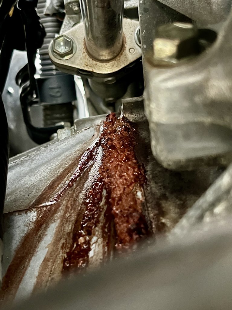

    Notice a spot under my truck today that hadn’t been present prior. For reference, the truck is a 2016 with almost 219k miles. Coolant and transmission flushed by Toyota about 2 months ago.
    After crawling under to investigate it looks to possibly be coolant, but is stemming from the rear of the engine near the transmission. Is there a plug back there that potentially didn’t get closed adequately?
    It’s a tight spot so the below is the best picture I could get. Any insight would be greatly appreciated. Long time Toyota guy, but Tundras are new to me.

    Quoting myself here. Based off my research over the last 24hrs my issue sounds very reminiscent of the coolant valley leak that is a known issue on other Toyota/Lexus engines. I had no idea the same problem could exist on the tundra 5.7, how naïve of me :facepalm:

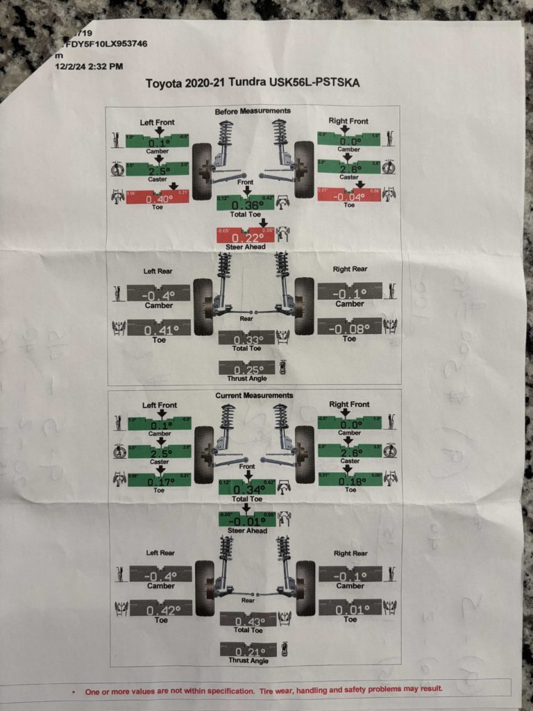

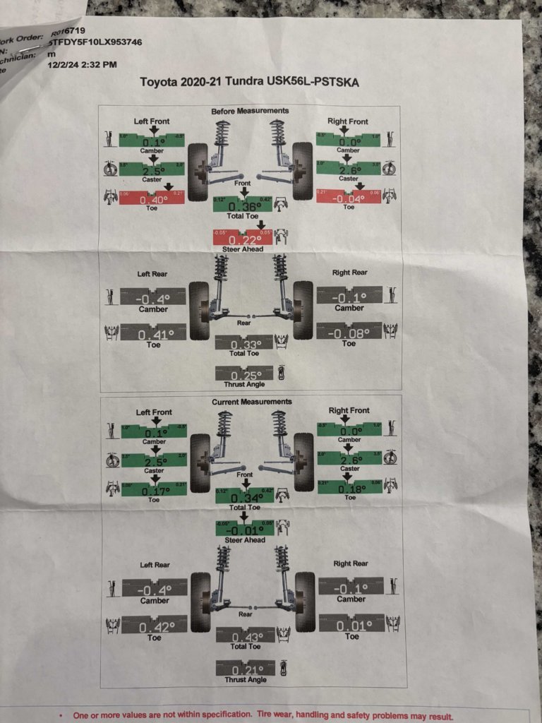

    A coworker, who in the past year bought his first Tundra (2020 XSP) is experiencing premature tire wear on the outside of one front side. He has been to two shops who supposedly have "aligned" it. On to his next set of tires and doing the same thing. He's ready to sell but I told him it has to be suspension, tie rod, hub runout or something causing it. Am I missing anything? Might have to pony up some cash if he is selling his truck even though I already have one. It's too nice of a truck to get rid of.

    Post up the alignment sheet.

    front right

    I would try lowering the toe as it’s pretty high but still “in the green” so the techs will say it’s perfect. Go about .1 degree lower for around 0.08 toe in.

    Thank you for your input. I'll pass it along to him and hopefully he doesn't sell his Tundra! ;-)

    Oh and tire rotation at every oil change. I’ve had tires cup like that when I didn’t rotate and went 10k miles.
