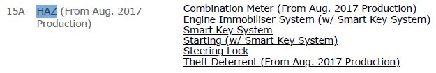

    I'm trying to hardwire a Viofo A229 Pro three channel dash cam in my '19 Limited DC. The kit includes a wire harness that starts at the camera, goes through a voltage cutoff box, then has three wires: ground, ACC, and battery. I tried connecting the battery to the Hazard fuse and the ACC to the Door R/L fuse in the box under the dash by the drivers door. No matter the setting on the voltage cutoff box (12v cutoff), my battery drains overnight. The idea is that the daashcam operates while parked in case of someone hitting the truck or trying to break in. Note that the kit has two fuses on each of the Battery and ACC leads one for the truck, and one for the camera:
    None of the fuses are blown. I thought the voltage cutoff box might be bad so I got another one through warranty, but have the same problem. Are there better circuits to use for the Battery and ACC leads? Thx!

    I’m not sure what you mean by voltage cut off box? Are you referring to the voltage step down transformer from 12v to 5v to operate the camera?
    The two circuits you selected, the hazard circuit would have power all the time to keep the camera operating. Does the door r/l circuit only have power with the ignition on? On the dash camera I installed it also has the one wire for ground, one wire for constant 12v and one wire for 12v with ignition on. The camera will operate as soon as the vehicle is started but when the vehicle is shut off the camera powers down and will only operate when there is an event when someone tires to break in or someone was to hit the truck. It has a shock sensor. Did you wire the camera wrong and mix up the circuits so the camera is constantly ON?

    Did you ever figure out the issue? I'm currently in the process of hardwiring my 2 channel dashcam and trying to decide on the fuses to tap into. I'm looking at tapping Battery into the RADIO fuse and ACC into the P/OUTLET NO2. Would anybody suggest not to use those?
    I'm hesitant to tap into HAZ because it looks like steering lock, turn signals, and wireless door lock control are tied into HAZ.

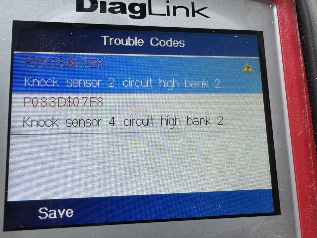

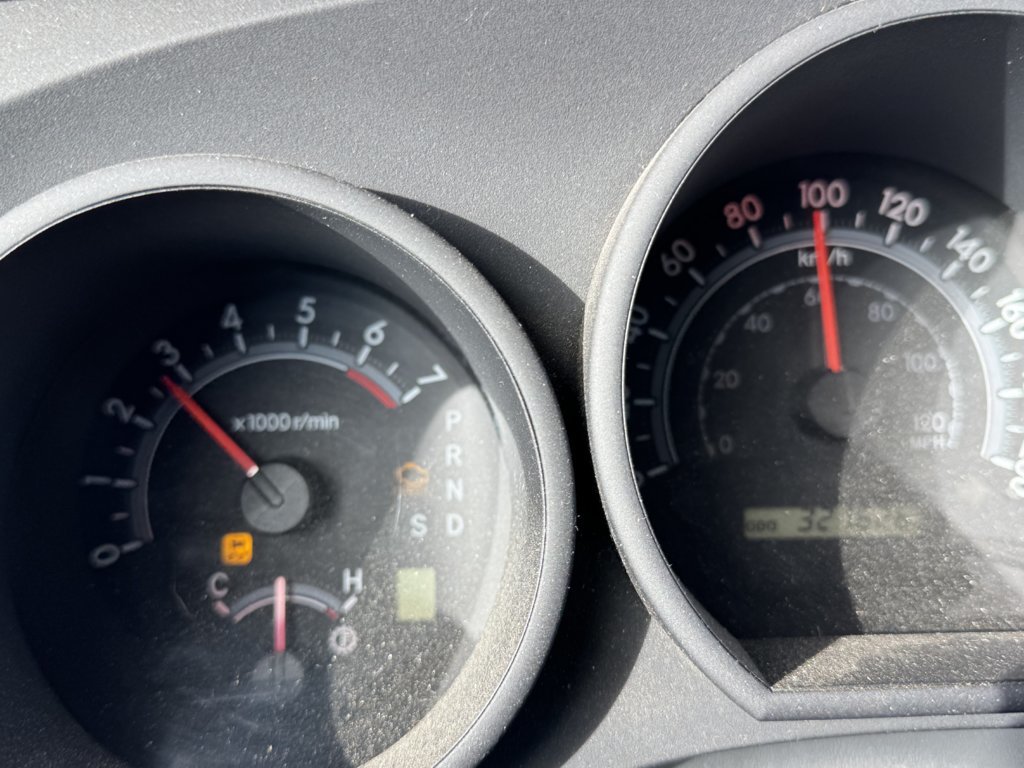

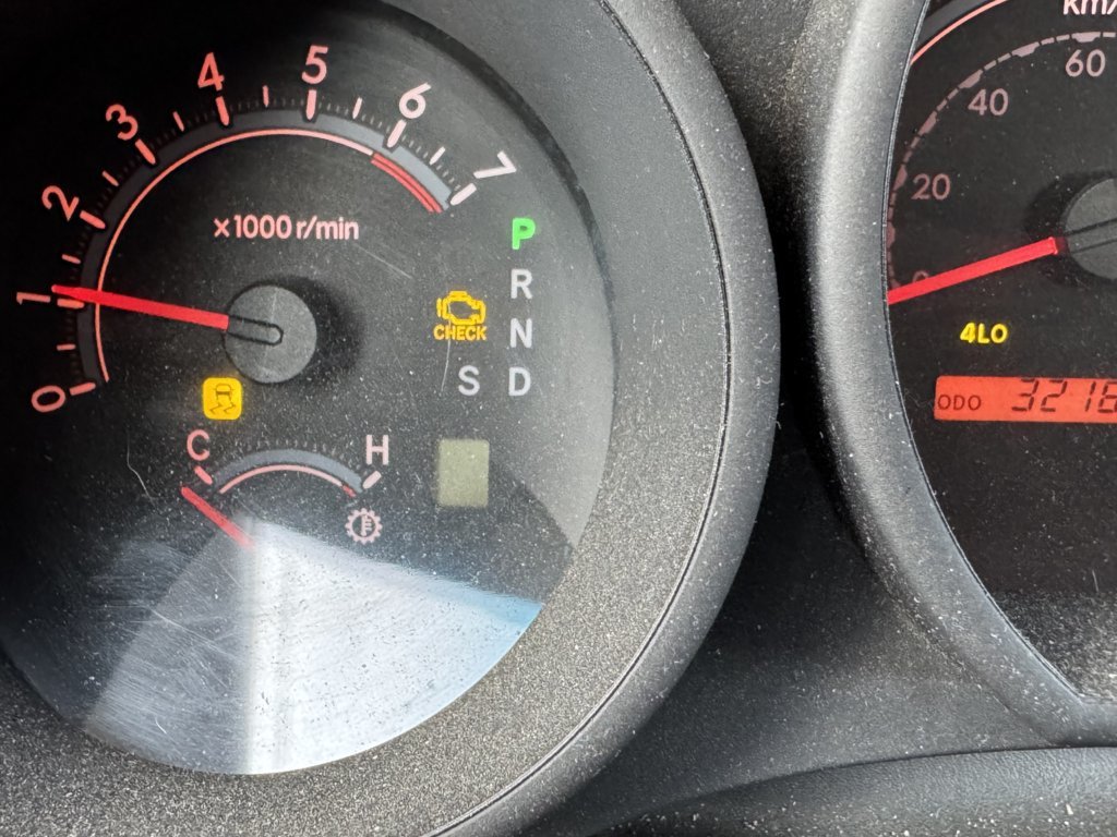

    Started my 2010 5.7 6 spd RCSB. Engine light, 4Lo flashing and beeping, yellow light with skid marks. shut it off, turned it back on.
    4Lo beeping went away. Shifted into 4Hi, then 4Lo while in park. shifted to N. back to P. turned the truck off and then back on. So
    now I have continuous engine light, yellow skid mark light and 4Lo light. Plugged the Autel and ran code search.
    Knock sensor 2 circuit high bank 2
    Knock sensor 4 circuit high bank 2
    Drove to the dump and back as the reason for going today. Transmission will shift normally 1-2-3-4 with appropriate rpm drops.
    But it stayed high until I pulled on to the highway but normal since it's not far. Wouldn't shift above 4th. I accelerate slowly most
    of the time, so it again sequenced 1-4 but once I hit 80k / 50 mph it didn't shift up. 100k / 65 mph tach sits at 2800 rpm.
    Pulled the lever to manual shift. indicates 4th gear no change to rpm. toggled up to 5th and 6th no change to tach, 2800 rpm.
    couple of stop lights, manual shifted holding rpms and again sequenced 1 - 4th, all normal. Won't shift above 4th gear now.
    No obvious wiring damage, don't think a rat did this. but haven't actually gotten all muddy crawling underneath.

    Can anyone tell me where the physical knock sensor is located?

    There are four, and they're located on top of the engine block under the intake manifold.

    What do you think might cause the 4Lo light? My friend has suggested fuses might be an issue? I used 4Hi yesterday but not 4Lo

    It has been said that Toyota likes to turn on some extra dash lights and disable some functions, like 4lo, beyond just the Check Engine Light, because people tend to just ignore it and it tends to make owners seek out a dealer for resolution for their "dash like a Christmas Tree" sooner rather than later.

    Ok, here is the reason for all this I think.
    I failed to come to a full stop when I pushed the 'Auto LSD' button. I was just slowly heading up a rough back road
    and didn't want spin as it had started doing the auto brake banging away in the back end.
    When I drove up the light was red. I stopped at the top, shutdown. When i came back down the mountain
    there were no lights on. I was curious about the LSD so I pushed the button another time. Nothing happened.
    I think this has resulted in it going all nuts when I got home and turned everything off for the night.
    Understand I didn't get any issues initially when I came home. I switched to 2Hi and drove home.
    All the lights and BS came on the next morning as soon as I started the truck.
