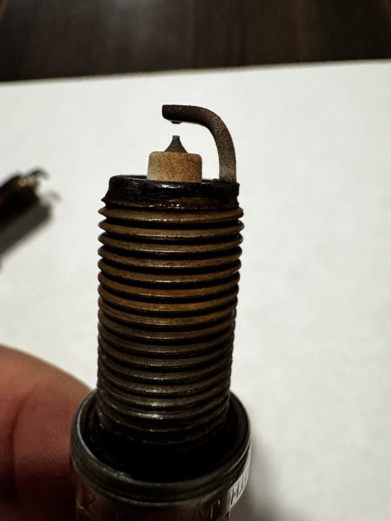

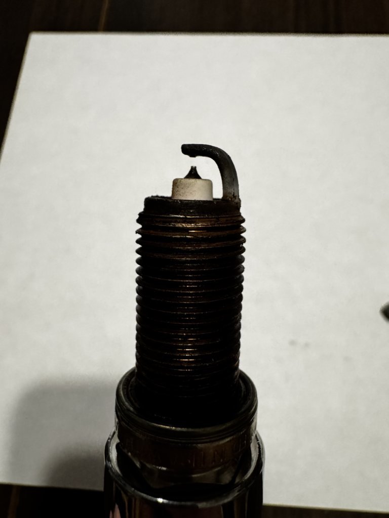

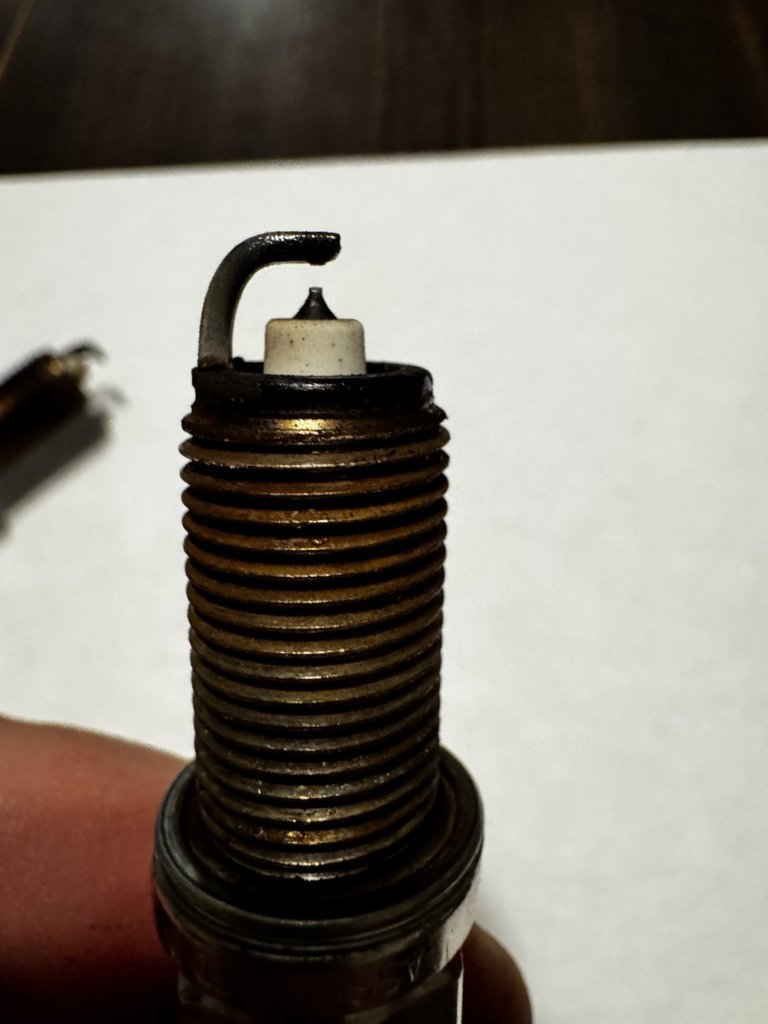

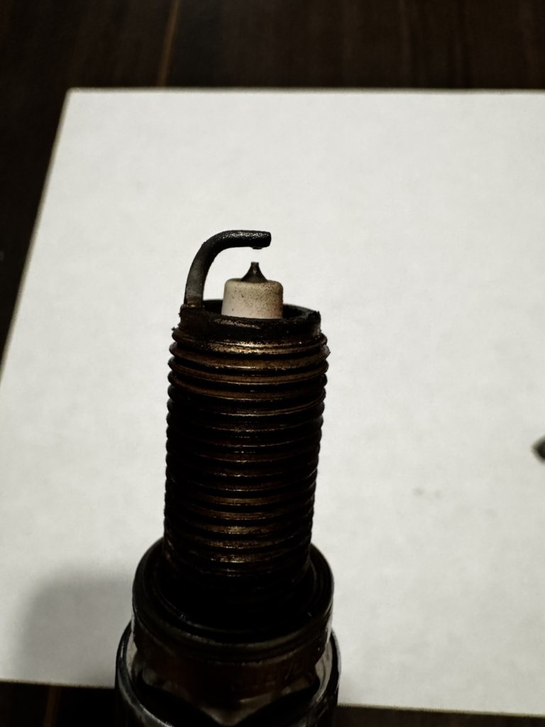

    I did about 700 miles over the holiday weekend. Filled up with gas on Tuesday then the problems started on Saturday morning. I haven’t driven it as much this fall as during the summer but it usually gets run every few weeks.
    Coolant res is currently at the line for low but I’m not sure where it’s normally at. I haven’t touched it since I purchased it in 2019.
    Here’s the plug in 5
    and 1 for comparison
  30. Dec 17, 2024 at 3:05 PM

    Personally I would switch one and five plugs around. Fill the coolant reservoir to the full mark when cold then monitor the level. See if you can duplicate the issue. Let the truck sit for a couple of days after a drive. If you have a radiator pressure tester you could pressurize the system, wait and see if the pressure drops then start the truck to see if you have a misfire.
    No Techstream?
    Number five is definitely “not like the other” but isn’t indicating it’s burning coolant. They look “like new” when eating coolant.
    Have you been changing your coolant?
    https://youtu.be/dfGTI0sWozc?si=84N1hKV98EDNRSVC
