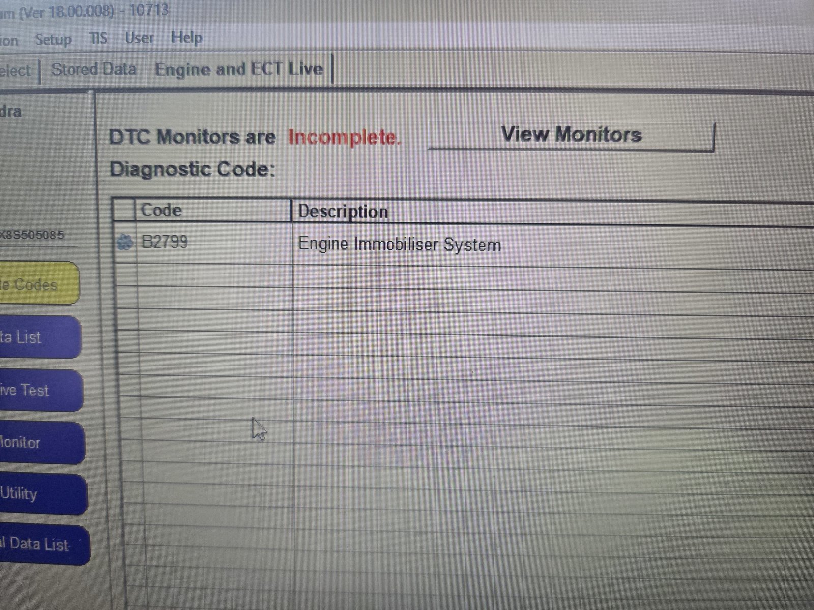

  3. Jul 1, 2024 at 1:22 PM
    #3003
    ASwan73
    ASwan73 New Member
    Jun 22, 2024
    #118818
    11
    Anthony
    2008 Toyota Tundra TRD

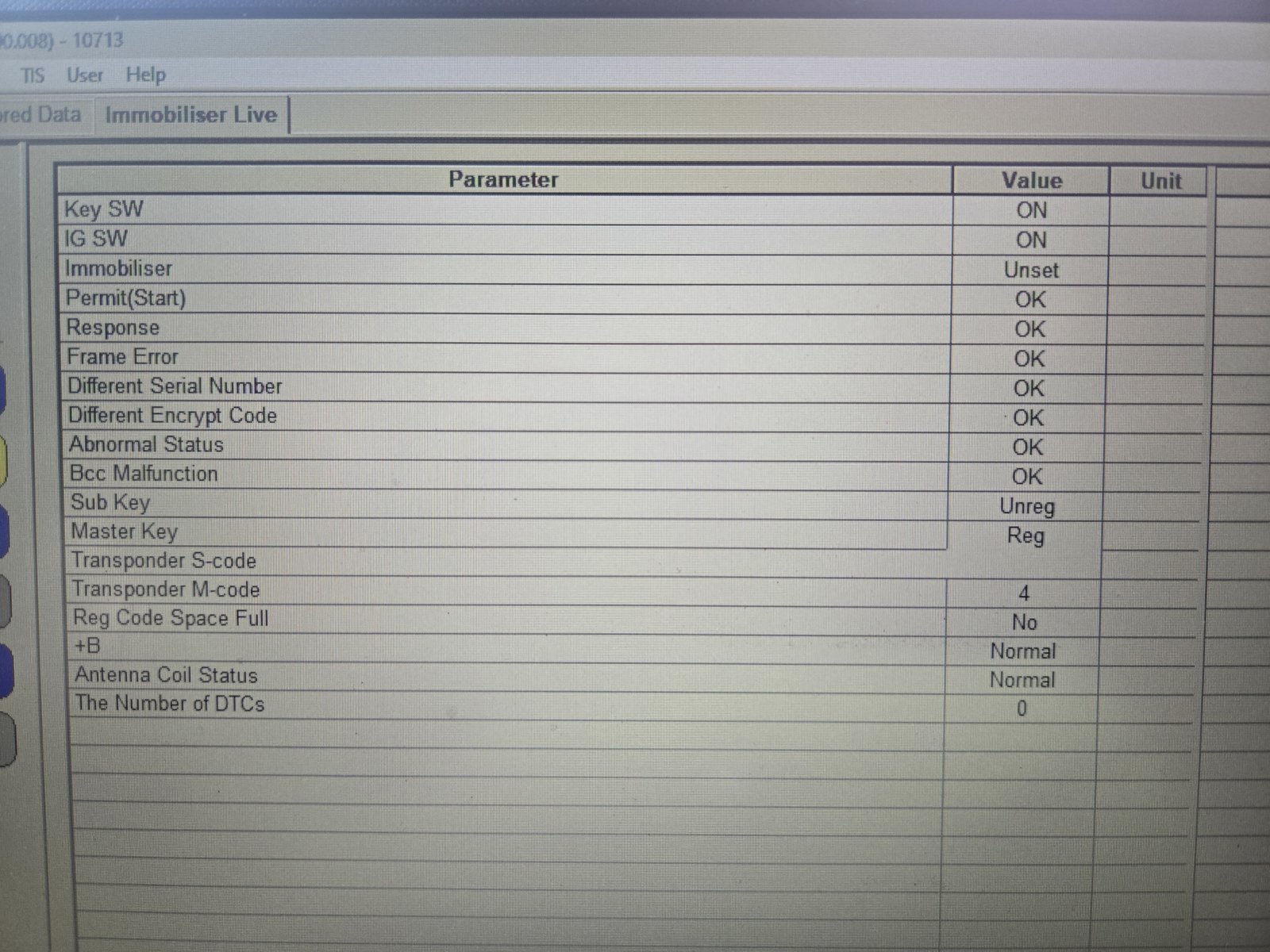

    3.5 lift, aftermarket exhaust, off-road tires.
    This is what my techstream shows. Gonna upload a video of what is turning on and shutting the truck down. Nevermind. Can't upload the video as it's an mp4 format.

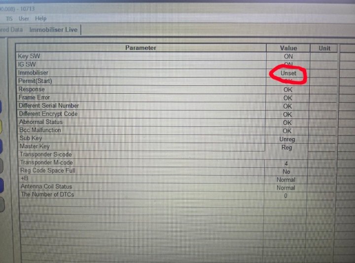

    2016 Tundra OR
    Your immobilizer says unset?
  6. Jul 1, 2024 at 2:21 PM
    #3006
    ASwan73
    ASwan73 New Member
    Jun 22, 2024
    #118818
    11
    Anthony
    It always does when the key is inserted. It goes to set when the key is removed. It will go to set after the truck has been running a minute or so also. The truck wasn't running in those pictures just the key was on.
  7. Jul 1, 2024 at 2:56 PM
    #3007
    Ruggybuggy
    Ruggybuggy Seasoned Veteran
    Sep 23, 2019
    #36508
    3,761
    Dave
    NW ON, CANADA
    2016 Tundra OR
    Mine is "set" when the key is in the ignition.

  8. Jul 1, 2024 at 3:03 PM
    #3008
    ASwan73
    ASwan73 New Member
    Jun 22, 2024
    #118818
    11
    Anthony
    Mine has been to unset ever since I've had a code scanner to put on it then it goes to set. Maybe it's something that the dealership needs to look at.

  12. Jul 15, 2024 at 4:16 AM
    #3012
    ASwan73
    ASwan73 New Member
    Jun 22, 2024
    #118818
    11
    Anthony
    OK guys, after doing some research, I believe my ECM may be what is causing the issues with my truck starting then cutting off. How hard is it to get the ECM synced with all the other modules after replacement? I can find a used one with the same part number and flashed with my VIN. I'd like to get it soon but don't know if that's gonna give me more trouble or not.

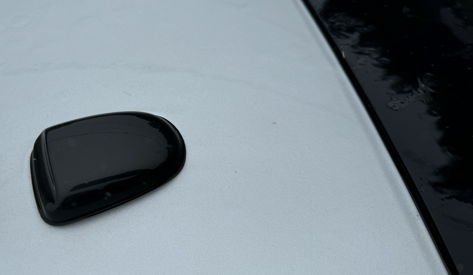

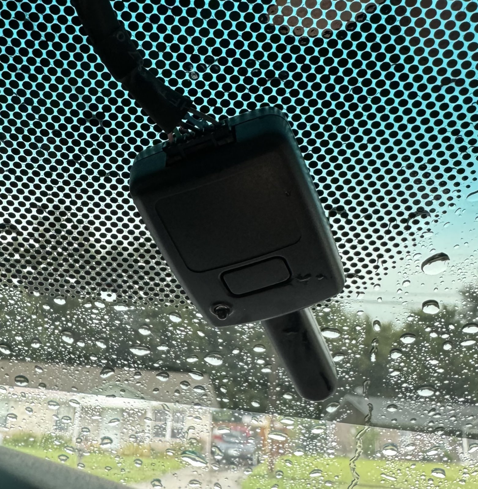

    My question is about a 2013 Tundra.
    Can someone tell me what these two parts are?
    The first one is key fob shaped with a button. It's stuck to the inside of the windshield by the rear-view mirror.
    The second object is a black plastic square mounted on the passenger side of the roof.
    Thank you in advance.

    The keyfob looking thing is part of a security and possibly remote start system. If you didn't get the key fobs, a good car security system dealer can help you out. The other is the XM satellite radio antenna.

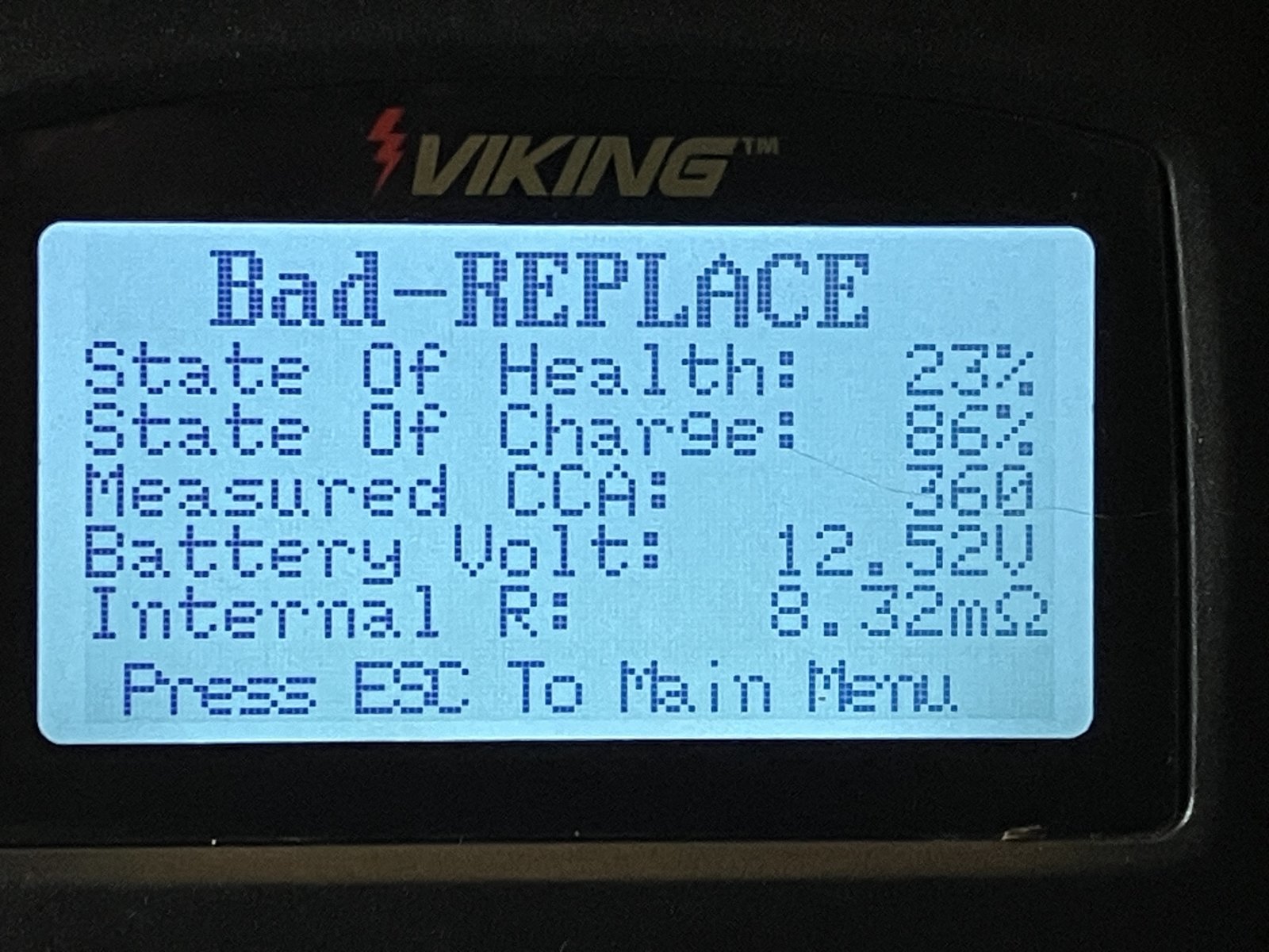

    A charging question.
    I picked up one of the battery/charging system testers. It works OK on an F-150 I'm babysitting, but claims that the battery (nearly new) on the Tundra is on its last legs.
    The charging voltage is 13.4 to 13.5. I know Tundras can't handle an AGM battery without the GM diode, but should the diode be used on a standard battery to keep the battery charged to full specifications?

    Following.....I've never heard of anyone using a diode with a standard battery.

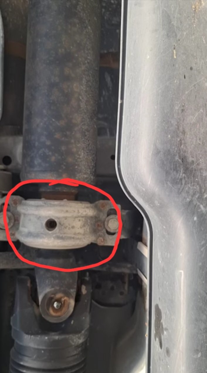

    My truck recently started making a clunking noise whenever I put it into drive or reverse. I noticed it only does it after sitting for a while like when I go to work in the morning. I greased all the u joints but its still making the noise. The truck only has 85k miles on it.
    I took a video of the noise here.
    https://www.youtube.com/shorts/QcVJ3DVybO0

    2016 Tundra OR
    Take the complete driveshaft down and check for a stiff U joint by moving it through it's full range of motion. Also spin the center support bearing while you have it out.

    2016 Tundra OR
    Just a thought, check the bracket on the center support bearing for rocks.

    2017 SR5 Tundra
    I'll be taking it down to look at it this weekend. Crawled under the truck earlier to check but didn't notice anything obvious. I'll update y'all later.
