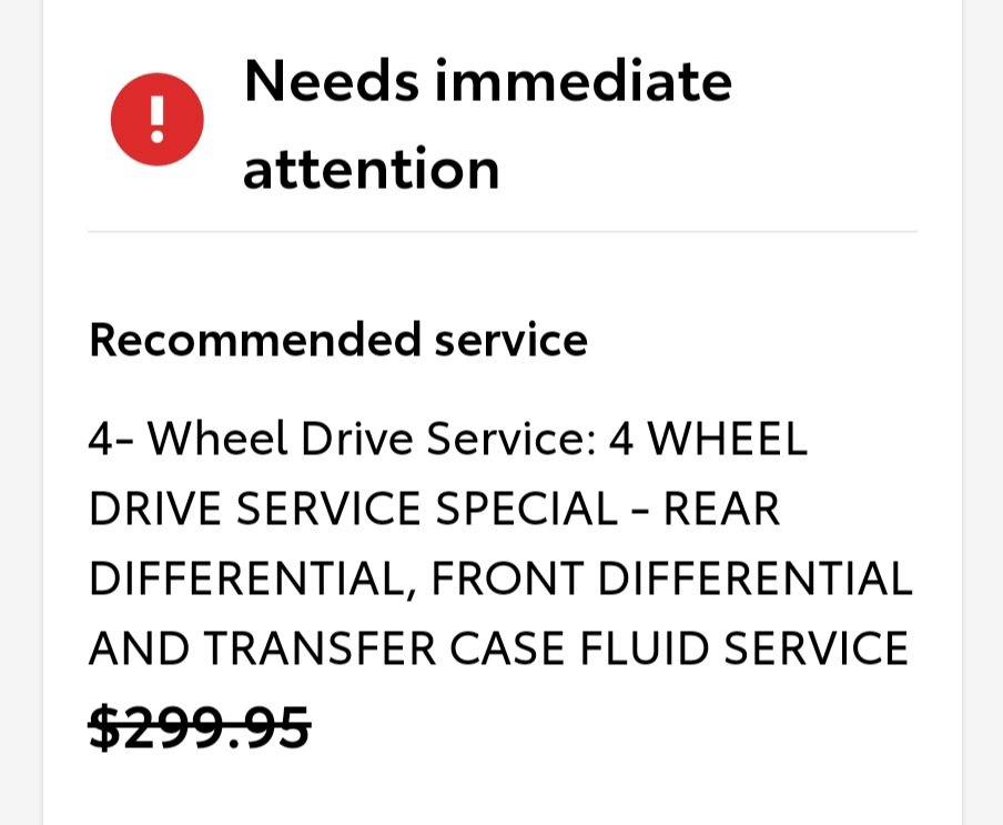

    Service writer not catching that it's a 2WD. The info comes up based on mileage and Toyota service recommendations. It possible the service writer entered the wrong VIN. The service writer job is a tough one. Low pay, dealing with cranky customers and a service manager always pushing to sell. At the dealership I worked at they usually lasted less than a year.

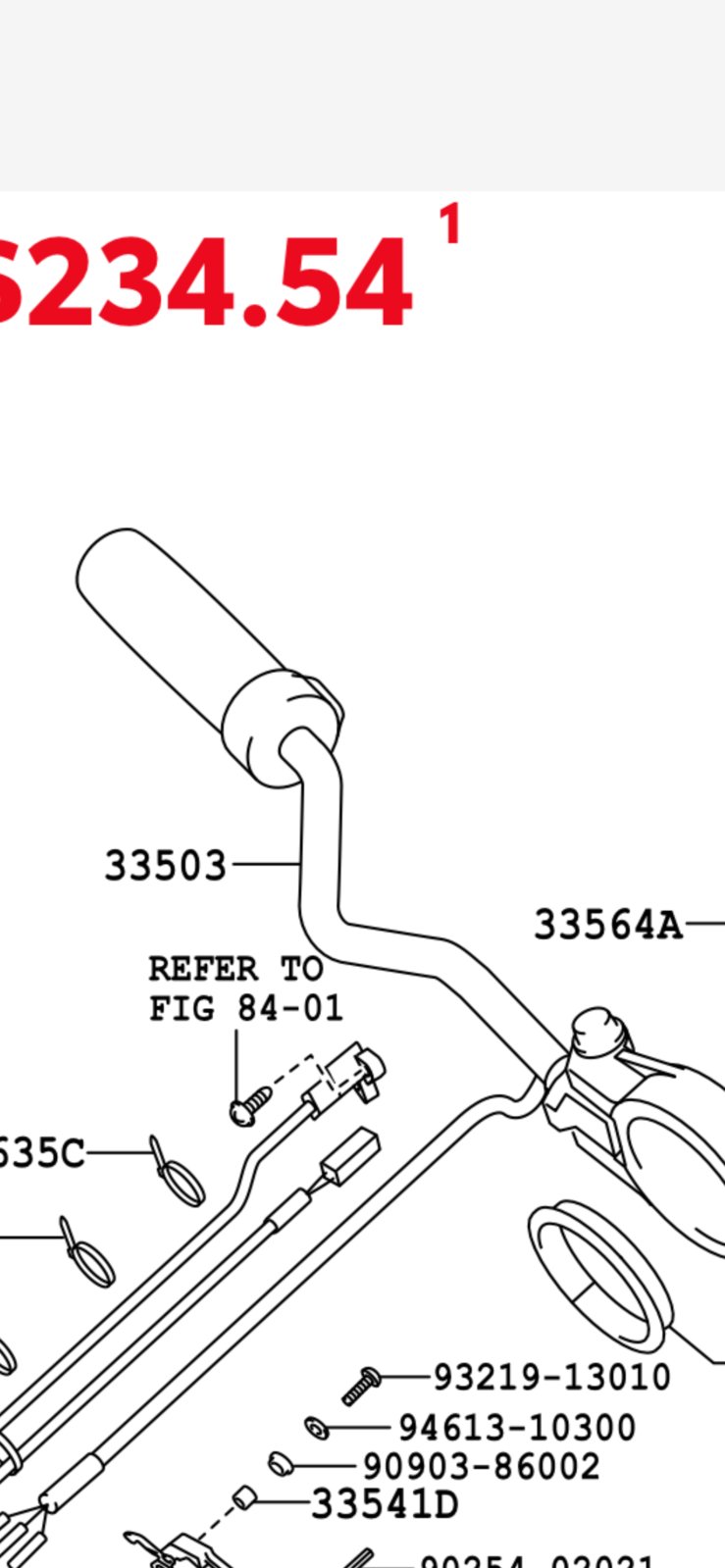

    I have to replace my broken sequential shifter and was wondering how difficult it is and roughly how long it takes? PN 33503
  17. Jun 30, 2024 at 6:17 PM
    #2987

    Sorry but I've never had to do one. I'm wondering how you broke it?
    Wynnded likes this.

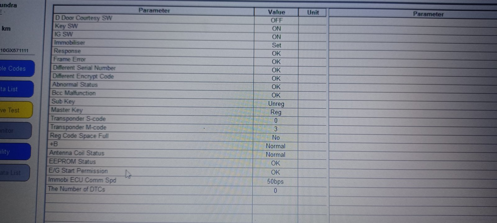

    When you run a health check with techstream what are the codes?
  23. Jul 1, 2024 at 5:46 AM

    Only code I get is a b2799 which is immobilizer communications error.

    Can you connect to the immobilizer and read data?
    Wynnded likes this.

    No codes on the immobilizer ecu. Just on the ECM. Everything on live data from the immobilizer is good.

    Check the wiring diagram for your immobilizer and check all the wiring to verify all the connections. Modules are very reliable so do a wiring check before replacing.

    Using the wiring diagram check every wire at the immobilizer connector for high resistance. You can use a light bulb to test. Youtube how to use a bulb to check for high resistance. Are your values the same as the one in this picture?
    After the checks if you confident that it need an immobilizer then unfortunately it will have to go to the dealership to have the keys registered.

    I will get on to it this afternoon and pull the data for it to show you.
