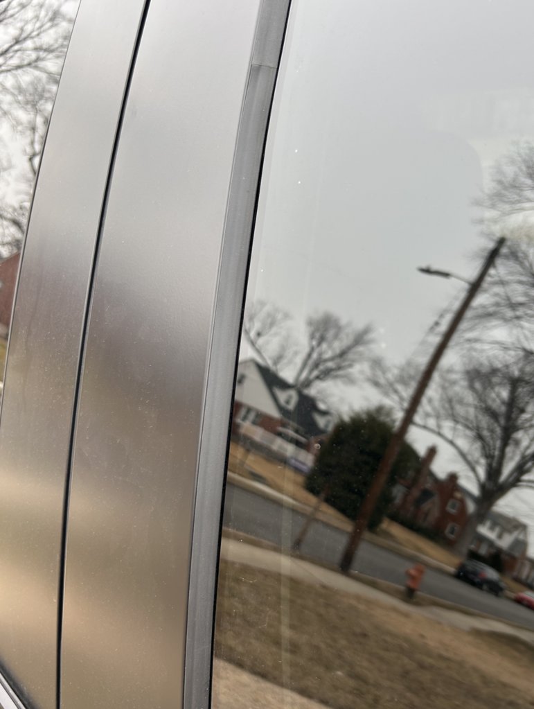

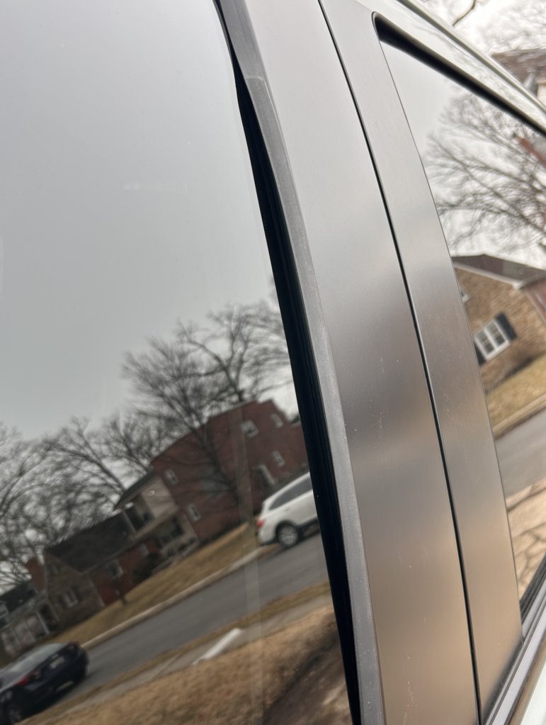

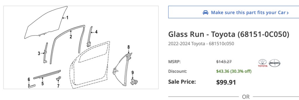

    So I had a very faint wind noise plus what sounded like a window 'shaking' in the frame (it was not physically moving) at highway speeds. Reported those concerns during my 5k visit and ended up with .. new glass run (part 68151-0C050; #2 in the image below)
    Just had it installed but the rubber is so new / deformed that it's not even sticking to the glass correctly. On a way home from the dealership, I could most certainly hear wind "gusts" even at speeds closer to 30 - 40 mph. I hope it molds back to the proper shape 'cause if not, I will have to go back...
    NEW RUN (driver's side):
    OLD RUN (passenger's side):
