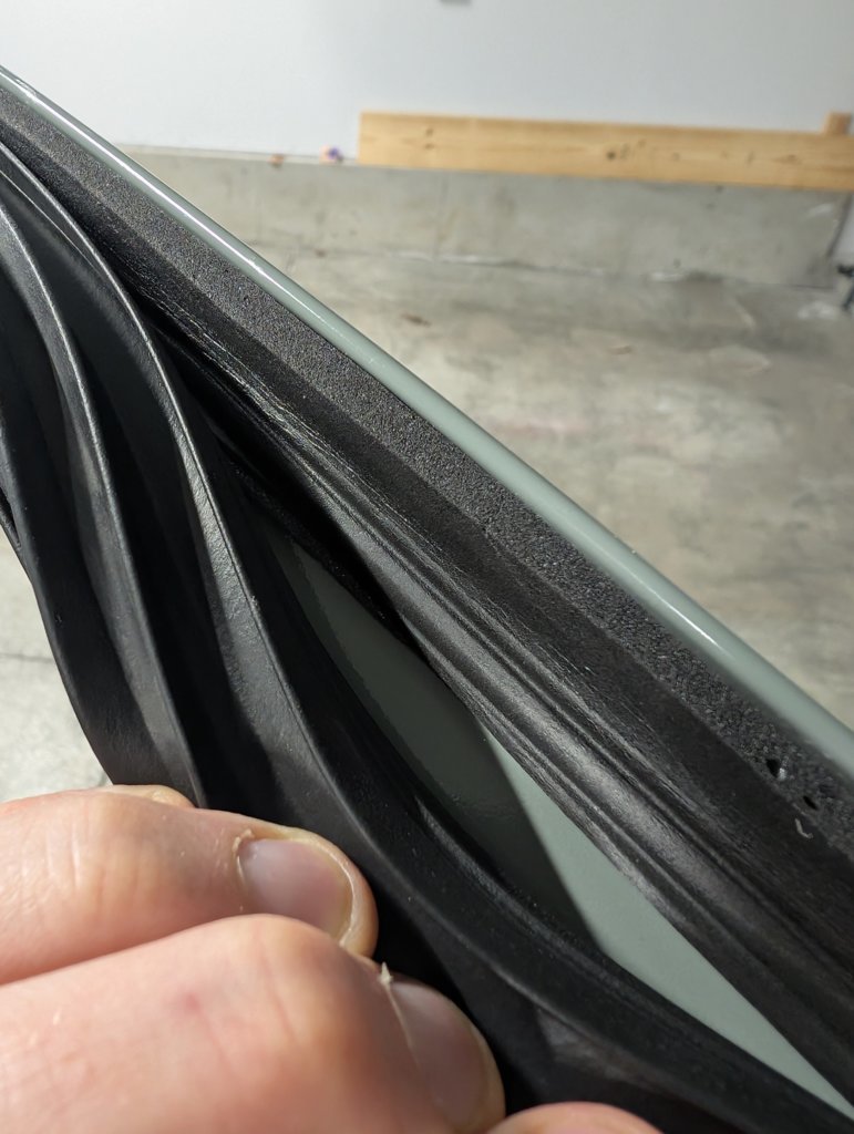

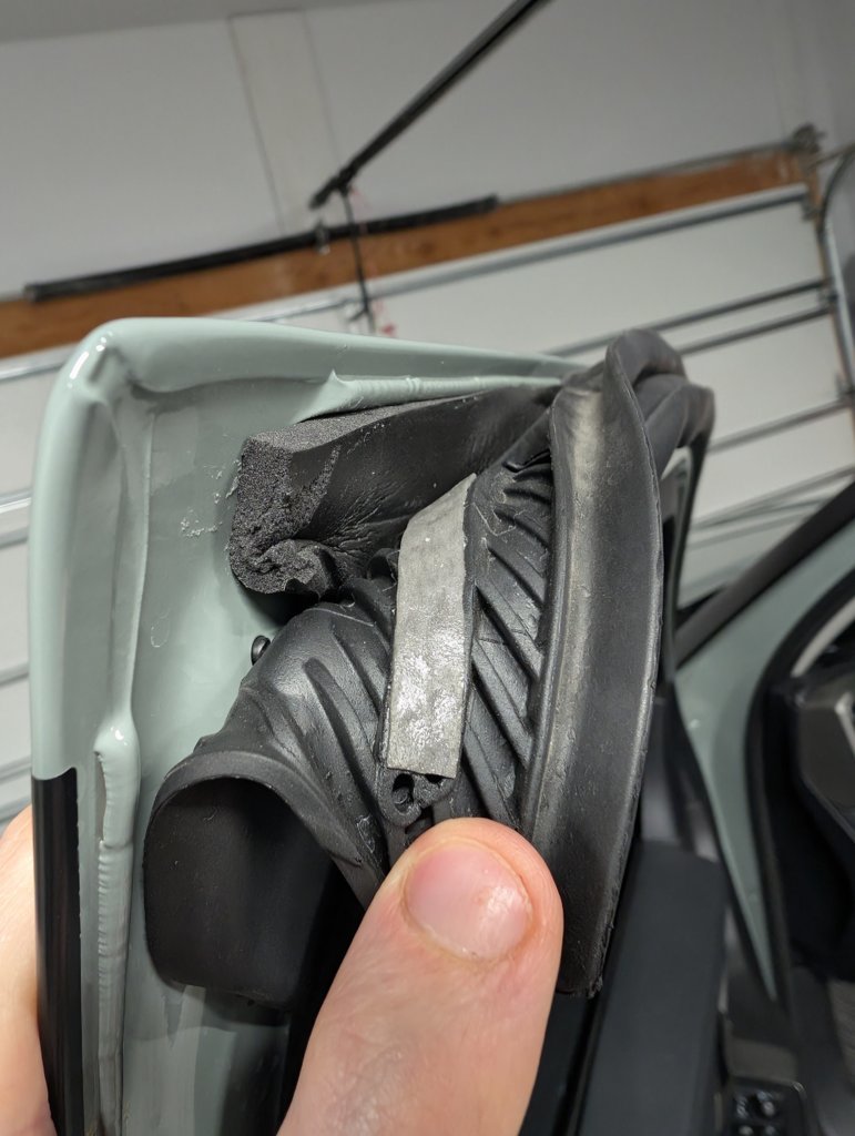

    To provide an update, adding 2"x1" foam adhesive strips behind the door seal has fixed the noise issue. I received the grease in the mail but will hold off on using it for now. The only thing I've noticed is that closing the door requires a little more force due to the tight seal.

    Do you have a photo of this? I bought the trim pieces from the OP, but they don't really do jack for the noise. Dealership replaced the door seals too, and that did nothing either.

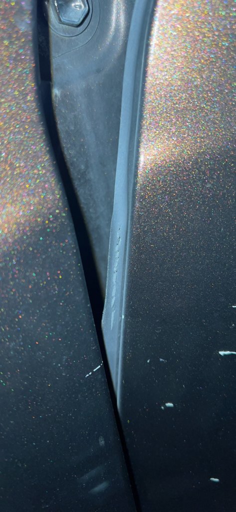

    PXL_20250121_164450575.jpg PXL_20250121_164441988.jpg PXL_20250121_164508668.jpg PXL_20250121_164550030.jpg
