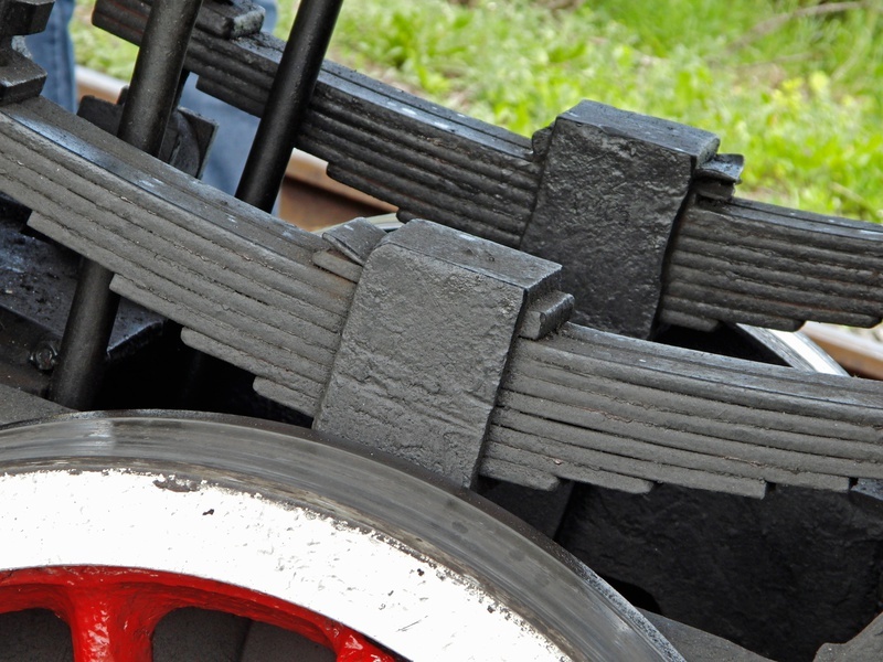

    Just imagine how these felt on the ole caboose.

    Hahahaha it took me 3 damn hours to get that bad boy off. It sucked. I've cleaned her up and waxed her and now I'm waiting on my part from toyota so I can drive again. Fucking firestone did an alignment and didn't put the lower control arms nuts back on, so it's sidelined until I get them and have it aligned AGAIN.

    Ouch. Talk about a stiff ride.
