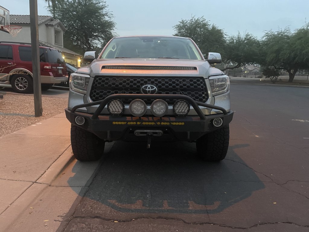

    I run the c4 front bumper (160lbs + winch and lights) and run the icon vehicle dynamics front coilovers, UCA's and 2 coachbuilder shims and shackles in the back.

    Thanks Dexter...I like the look of that bumper! How does it ride when you go over bumps or hit potholes...and driving down the highway?

    Rides great!

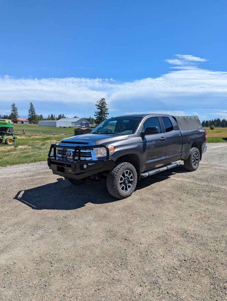

    14 Tundra 2.5 kings all around with remote reservoir and adjusters with 700# springs Total chaos bushing style control arms Camburg 1.5 inch lift shackles Coachbuilder polt bushings in leaf springs Bmc and front bumper trimmed 37x12.50x17 toyo MTs 17 inch Icon rebounds +25 offset 5% tint Winjet taillights True dual flowmaster super 40s ARB summit bumper Smittybuilt 12k winch White Knuckle Offroad sliders
    Currently running the arb with a 12k winch and now wko sliders. I'm running king suspension all around have 700# springs on the front does great for me
