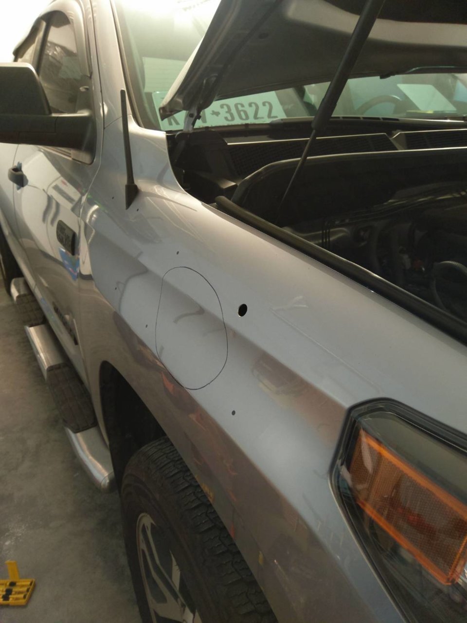

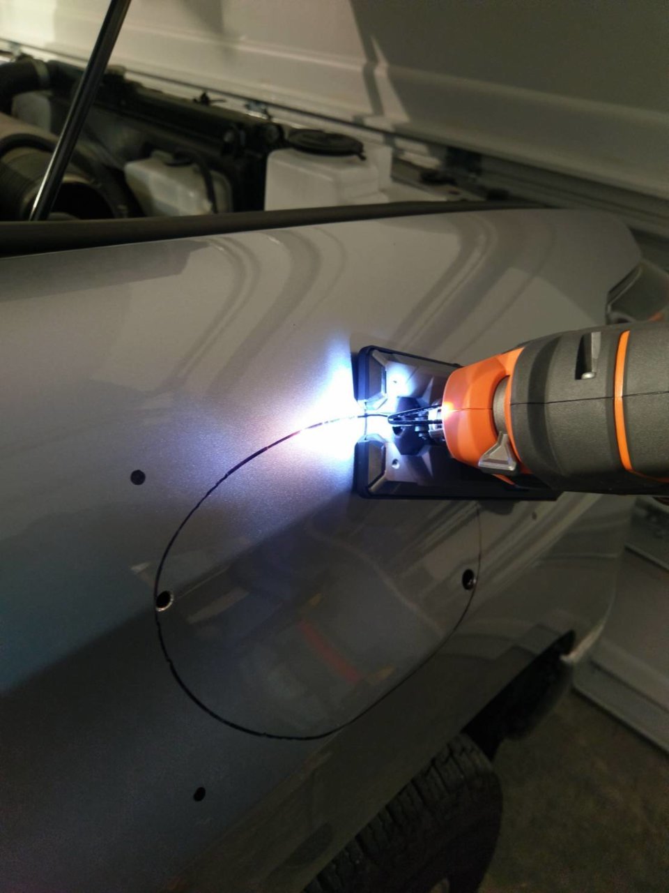

    Yes, sir. Those first drills and cuts would really get your heart beaten a bit
    ** expecting a "what she said" joke :rofl:

    Just seeing those pics raises my anxiety level some lol.

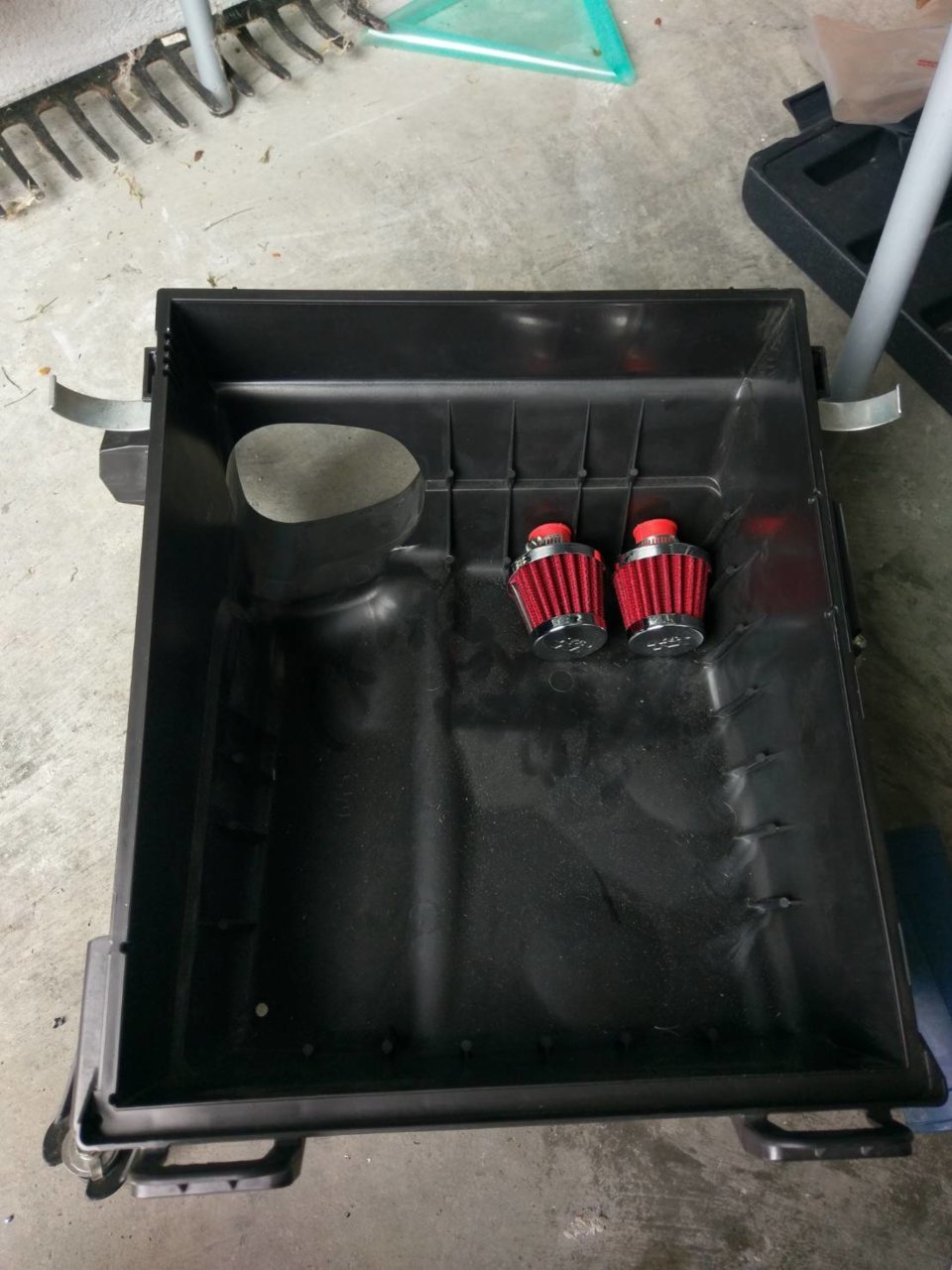

    Hey, guys, so as 831Tun is trying to help me figure out the 2ndAI for me (which I really appreciate), I have an idea that I'd like to run it by you guys. (Please see pix). I am thinking drilling the hole into the airbox base and connect the two breather filters this way. My only concern is the suction of the motor will be greater than the 2ndAI's suction which causes negative pressure where the 2ndAI never gets any air. What are your thoughts?

    I doubt that would be an issue..I'm sure theres not that much pressure generated in the intake box, but just make sure they are sealed as well. If not, kinda defeats the purpose of the snorkel lol
