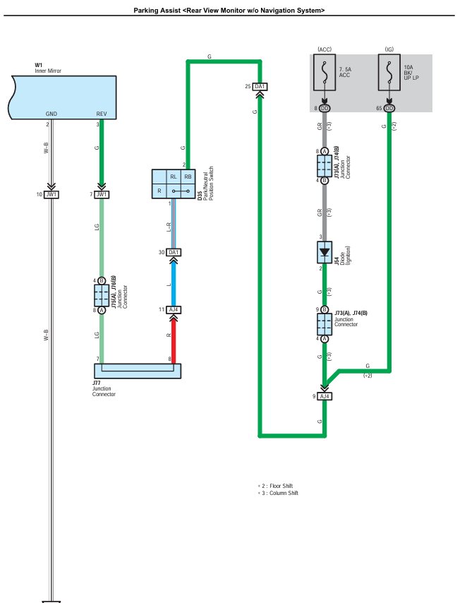

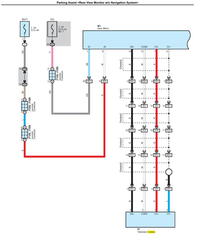

    Hey guys, 2013 tundra RW, double cab SR5, have the factory reverse camera in the rear view mirror. Was wondering now that I am getting an apple carplay headunit if I can mirror the output of the camera onto the new headunit as well as keeping the factory screen in the rear view mirror?
    does any one have the wiring diagram for the factory camera?

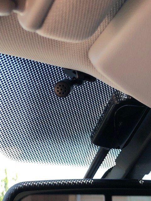

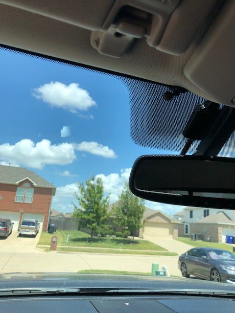

    another off topic question is: can i Use the factory mic location rather than having that ugly small mic most companies provide?

    Wiring diagrams found here.
    Ultimate TUNDRA Wiring Diagrams Collection | Toyota Tundra Forum
    You'll need to use the mic your HU comes with.
    It isn't that much of a distraction, you'll forget it is there.

    You will not be able to use both the HU and the mirror back up screen, not even sure why you would want to.
    Here is your wiring diagram although I don't think it's going to help much.
    Good luck.
