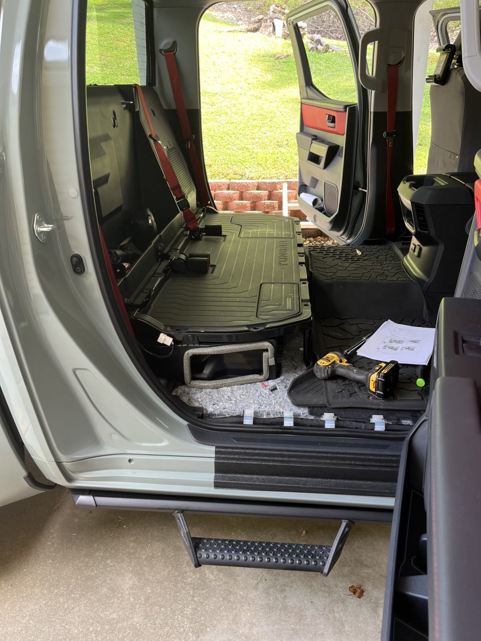

    4 bolts for rear seats

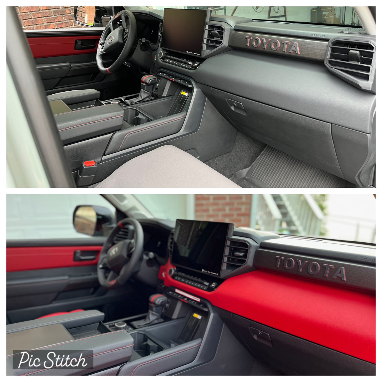

    Front dash before/after

    4 bolts and 3 connectors for each front sest

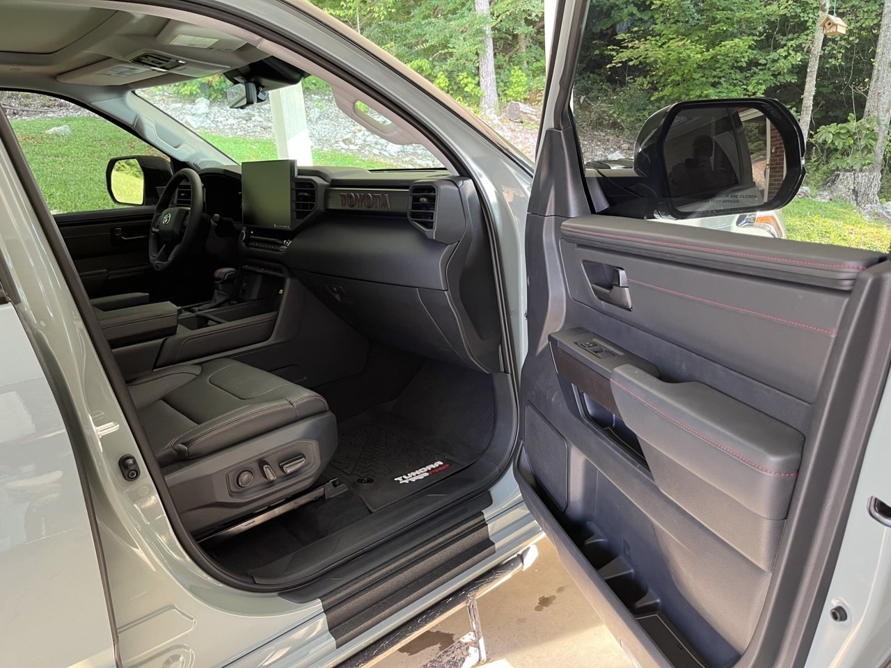

  12. Aug 18, 2023 at 3:51 PM
    #42
    LR Pro 2022
    LR Pro 2022 [OP] New Member
    Feb 12, 2023
    #91900
    75
    2022 LR Pro
    Door panels are a bitch, just feels wrong ripping them off, plastic studs etc
    iiawah808 likes this.

    But i do like the black better, alot better

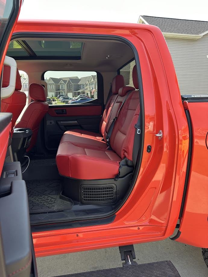

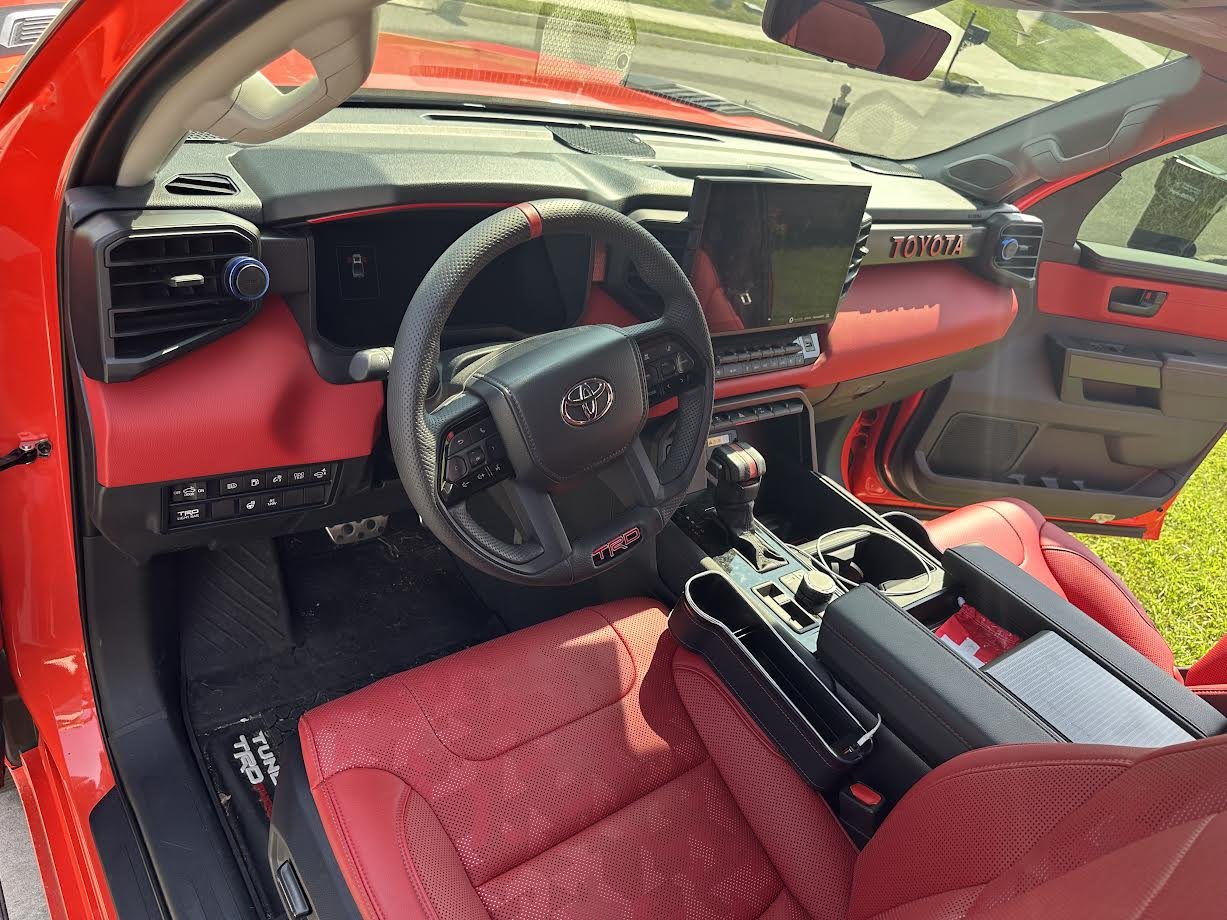

    #97901
    Here is what the Red interior looks with the Solar Octane...Beautiful in my opinion!
