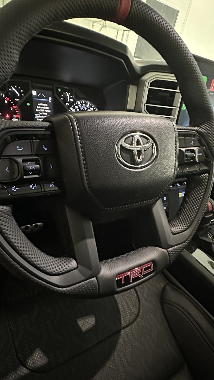

    Bye rubber wheel! You will need a 10mm hex to get the wheel off. No puller needed. It took two tries to get it dead center but not bad overall. I suggest not to fully click everything back together to make sure she’s center first since marking it will be a crude reference mark.IMG_2346.jpg

    This looks spectacular!!!! I can’t wait for mine to arrive!!! How was the installation overall, can you give a play by play of removing innards from stock wheel, and putting on new? Did you require the torque wrench and tools listed in the service documents? PS you now need the TRD shifter to match! I have the shifter already, and the steering wheel will complete the set!! ;)

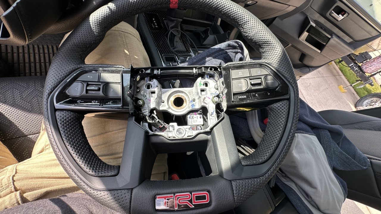

    Thank you for these awesome instructions. I got springs 1 and 2 popped on the airbag but I cannot find spring #3. I’ve removed the bottom cover and can see the airbag assembly. Can you let me know how to pop spring #3? Thank you!

    I got it! Couldn’t see the other side of the release knob with the wheel turned. Onward! IMG_7705.jpg

    Heated steering wheel works!! Superb wheel. With the TRD shifter it makes for a beautiful setup on the limited. Now that I understand it the install isn’t too bad, but some aspects (bottom airbag release spring, airbag power disconnect process, threading wiring through steering wheel) were confusing at first. Thank you @TundraTT for your instructions! Couldn’t have done it w/o your help. Suggestion of impact for wheel nut and marking teeth with sharpie was epic.
