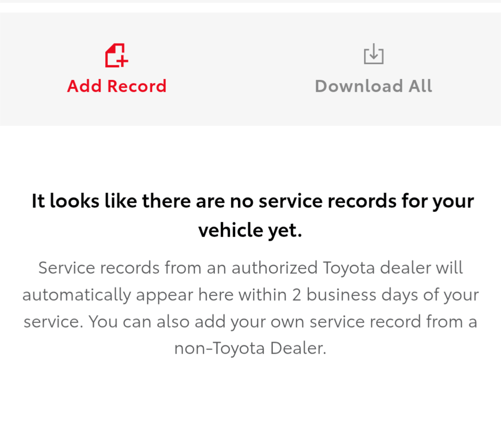

    Apparently their system doesn't sync with the Toyota Owners website which is sad. I logged in this morning and no service records exist for my 24. I have been to the dealership at least 5 visits for OC and recall stuff.

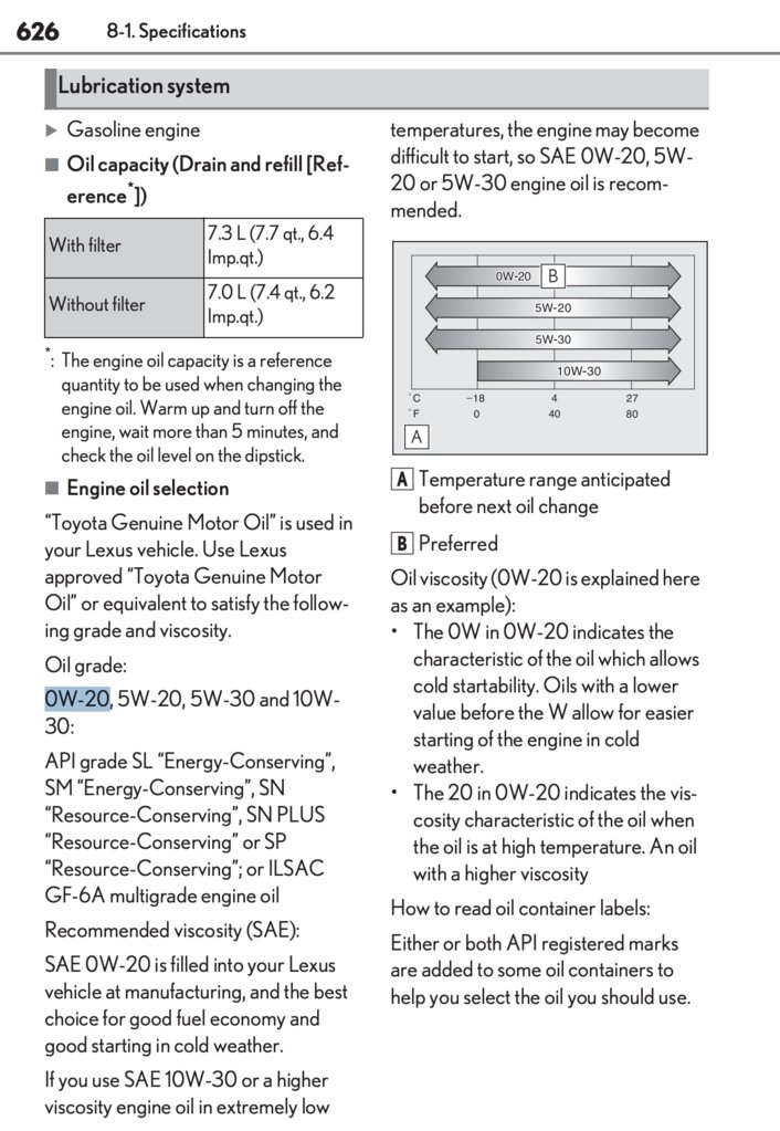

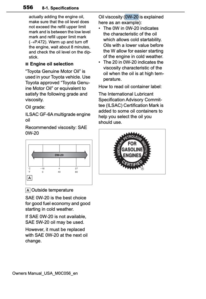

    Just for kicks, I just downloaded a manual for the Lexus LX600 sold in United Arab Emirates (https://www.lexus.ae/en/owners/owners-manual/). Same engine I believe (correct me if I am wrong). This is the detail about the engine oil:
    Shown below is a page from the US manual for our Tundra (used 2024 model year). This image matches the same page from the US based LX600 manual.

    Still the same for me and the vehicle image is what looks to be an Avalon even though it has my correct VIN. I tried logging out but now can't get logged in. Oh well, I was just hoping to we had a place to reliably see previous dealership and owner service dates... but I guess not.
    Anyway, sorry to derail the conversation.
