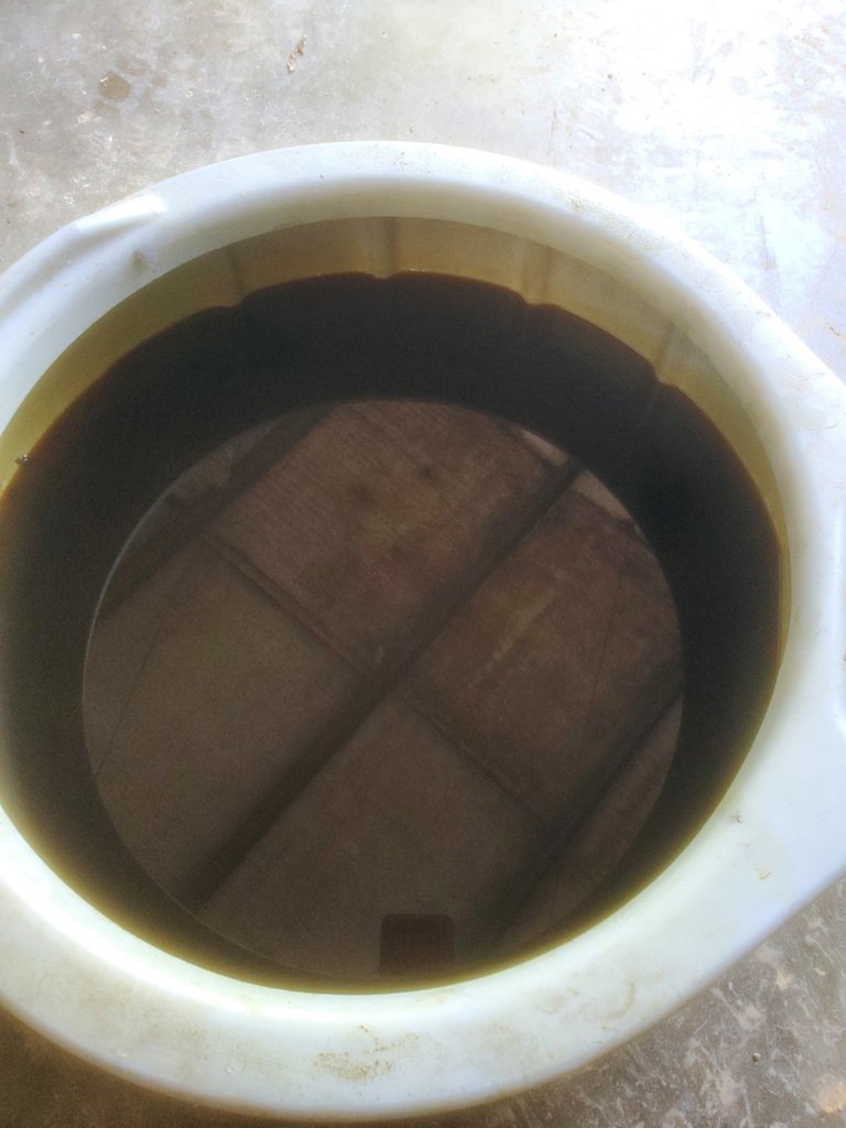

    Just changed my oil. First 500 mile change. Used quaker state full synthetic 5w30.
    Seems the Motor runs smother. Probably just a placebo effect.
    0w20 after 500 miles looks very dark and feels like water.
    Used QS because according to BTOG currently it has the best quality.
    raylo likes this.
