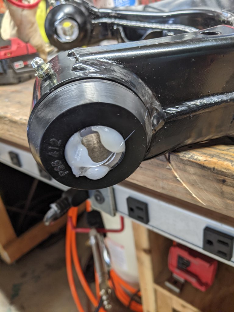

    They go through the bushing to grease the sleeve. You can see the hole in the bushing in one of the pictures.

    Thanks. They aren't pretty but should get the job done. It's hard to make things nice when you're using a drill press as a mill lol.

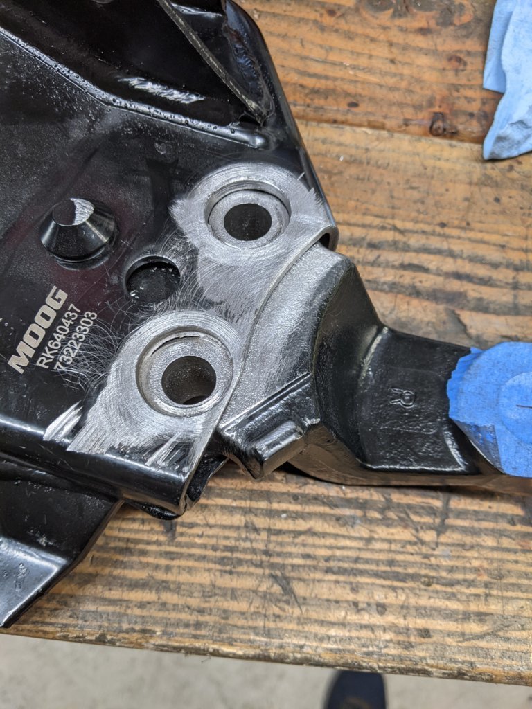

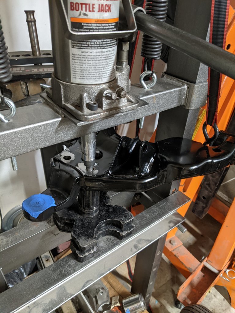

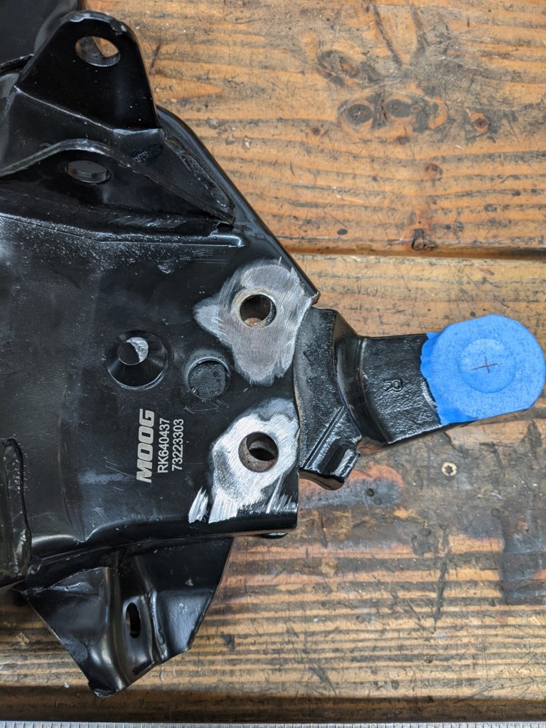

    Phase 2 has begun.
    Moving the ball joint forward a little to gain some caster. Last time I had it aligned with the caster maxed I ended up with 2.8°. Planning on moving it forward .5" which should add roughly 1.5° of caster. That should get me closer to 4° and free up a little adjustability with camber.

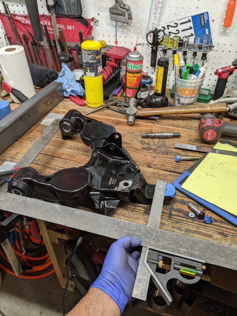

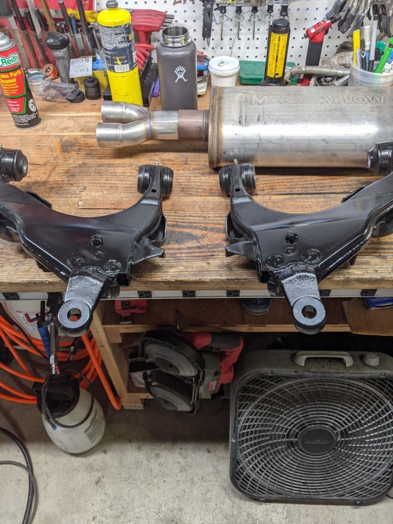

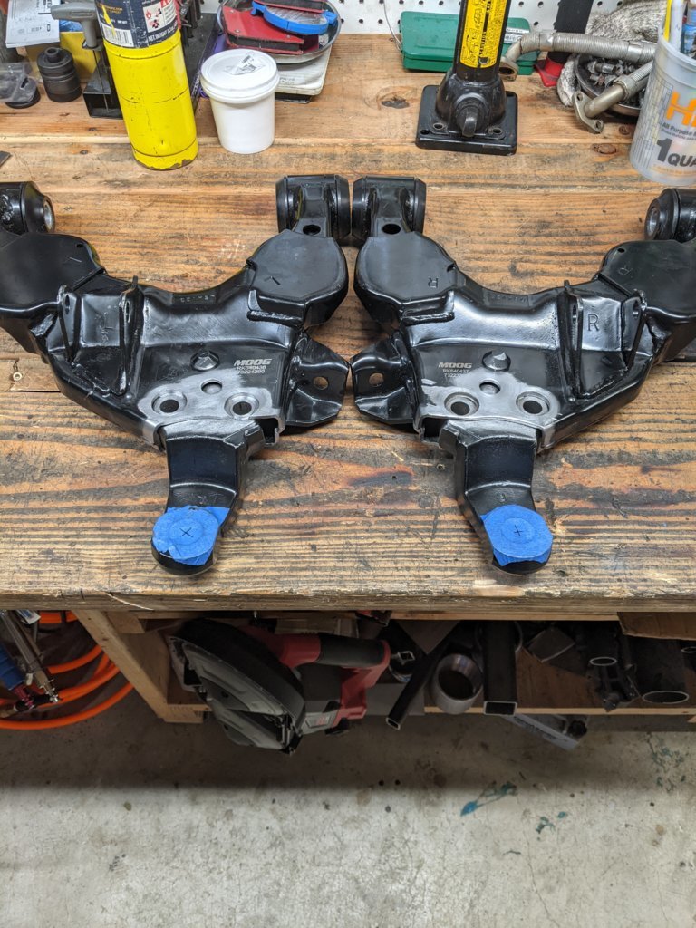

    Getting ready for welding. Things happen slowly when you have 3 babies.

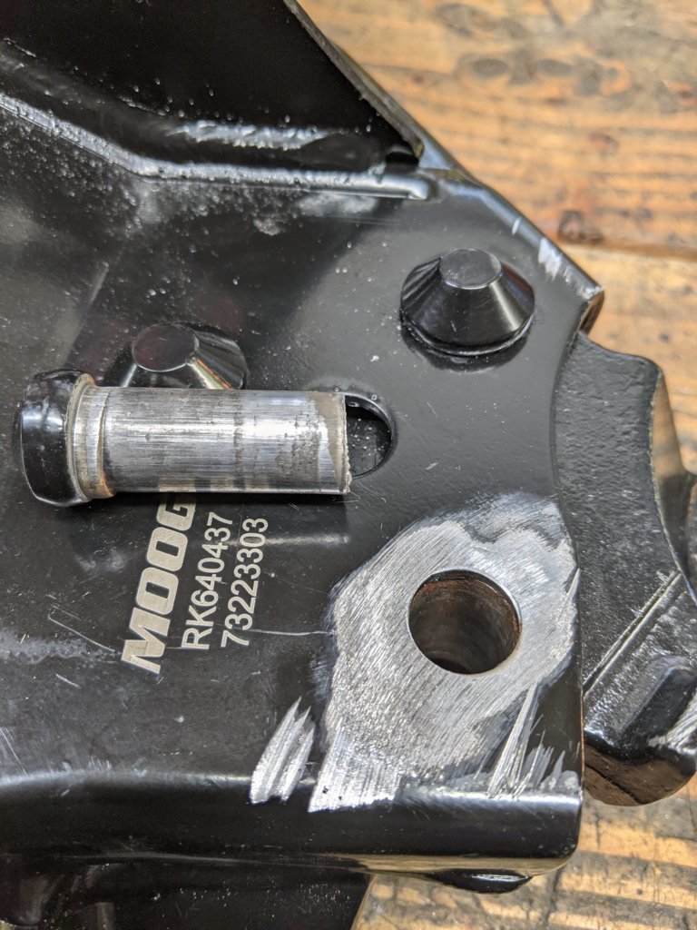

    So are you just re-using the fasteners you pressed out, and welding new "caps" on them?
    Did you do this to remedy an alignment issue?
  8. Jun 28, 2025 at 8:37 PM
    #38
    Turbocooker
    Turbocooker [OP] New Member
    May 17, 2025
    #135130
    22
    2006 Sequoia
    I won't be using any fasteners. Originally I was going to weld plates top and bottom and through bolt to sandwich everything together but decided it's just more unnecessary parts/labor. Just going to puddle weld the holes top and bottom and also going to weld the perimeter where the ball joint casting enters the arm.
    I did it to gain some caster back...... And I was a little bored. When you put a lift on you lose some caster because the upper ball joint moves forward as the control arm travels downward due to the arm being at an angle. The rig drives ok now but it does tend to want to follow the ruts on the highway so a little more caster will help with that.

    I will be puddle welding all 3 holes top and bottom and the end of the arm where the casting enters so it will be plenty strong.
