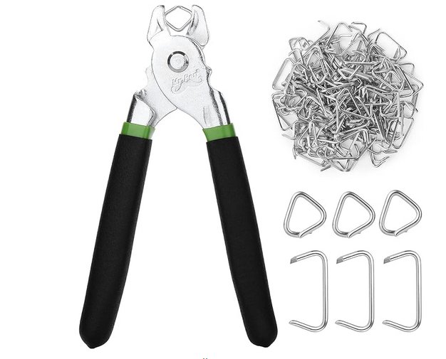

    I am not a fan of the plastic piece living in the Arizona heat so I use a pig ring to put in the slot. I was afraid wheeling that a tree branch or whatever debris on the trails could get jammed up in the skid plate and just worried me. The pig rings are thick, solid and will not fall out. I have a tool to help insert and take out when changing oil. call me paranoid but they have been on for 5 years and still holding strong

    Tony, can you please post a link or a pic of this, for those of us that don't know this term?

    Pig ring?
    Hog ring? :)

    This is hog rings pliers
    The rings can be round.

    Pig ring hog ring… you know. I used them to put wire under chain link fence and for barb wire connections to fences when I was in High School. I worked weekends for years before I graduated and the hog rings were what I used. I will take a pic when I get out to the garage

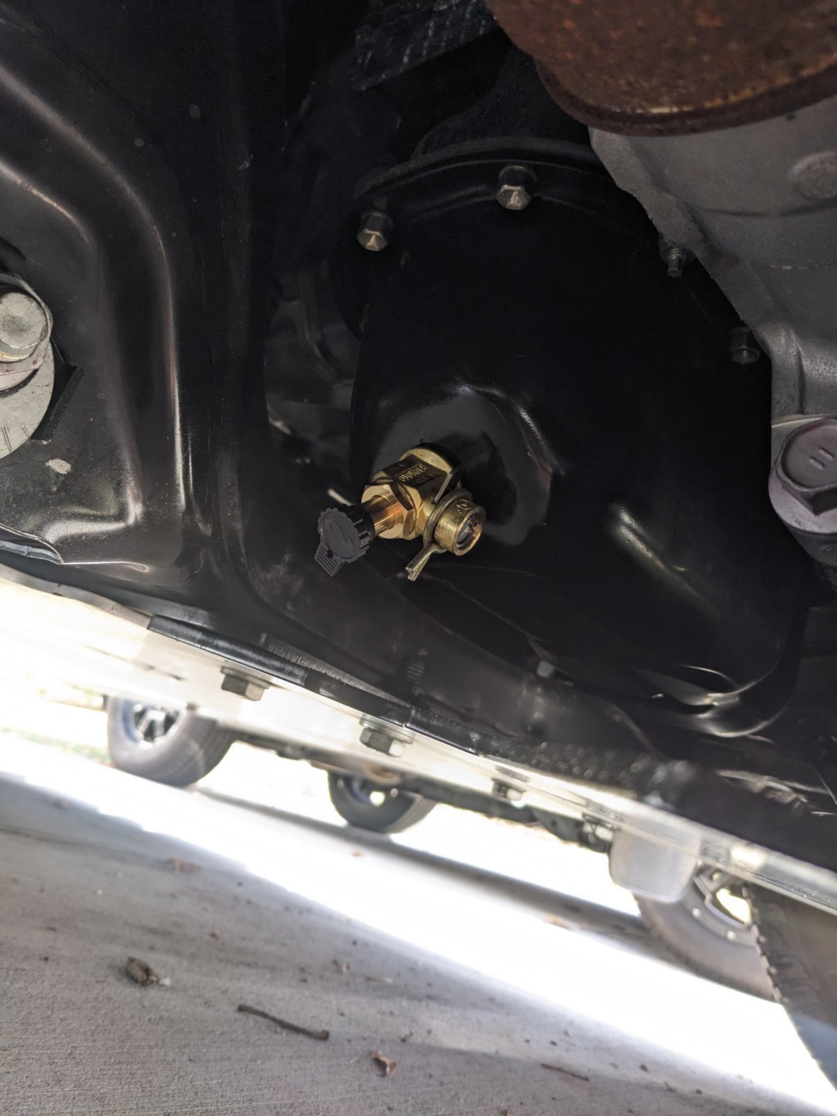

    Fumoto sells a lever lock to hold the valve shut instead of using the plastic bit. That's what I use and I need a pair of clamp pliers to get it on and off (it would require a catastrophic failure to come off on its own)
    Here's the link for it - https://www.fumotousa.com/all-products/f-lock.html
    coTony and FrenchToasty like this.

    Ok, so the F-lock is exactly what I ended up buying a box of and that picture shows exactly what my EZ kit looks like. I just have a rubber cap over the nipple

    I haven’t had one issue with my fumoto valve and haven’t been concerned about it opening……but now you guys have me thinking I need the f lock. Damn my ocd…..
    A $2 part with $5 shipping?!?!?!

    I have the valve but haven’t switched it yet. The valve accidentally opening under some crazy circumstance is my biggest concern. I just bit the bullet and paid the shipping after seeing there is a better lock out there for the valve over the plastic piece

    the plastic piece clips and locks in ; I would find it hard to believe that it could be lodged loose unless installed improperly. That said, I may get the f lock just to be sure

    I've had the Fumoto on other vehicles and currently have the ValvoMax on my truck. I really like its design. It doesn't stick out from the oil pan as much and has a cap on it should the valve fail. If you're worried about the Fumoto accidentally opening (which I don't think is very likely), then you should probably keep the standard plug or go with something like the ValvoMax.

    Agree. Very unlikely that the Fumoto valve would open on its own with out the plastic lock... I have the plastic lock. It hasn't come off yet , been on about 3 years ..
