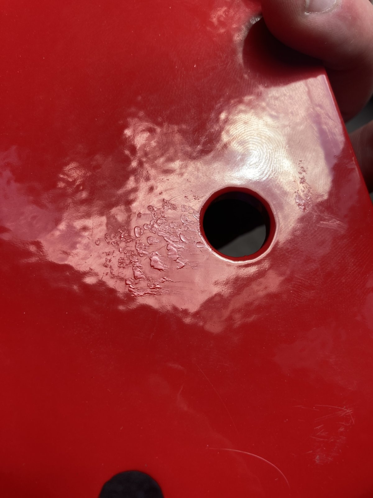

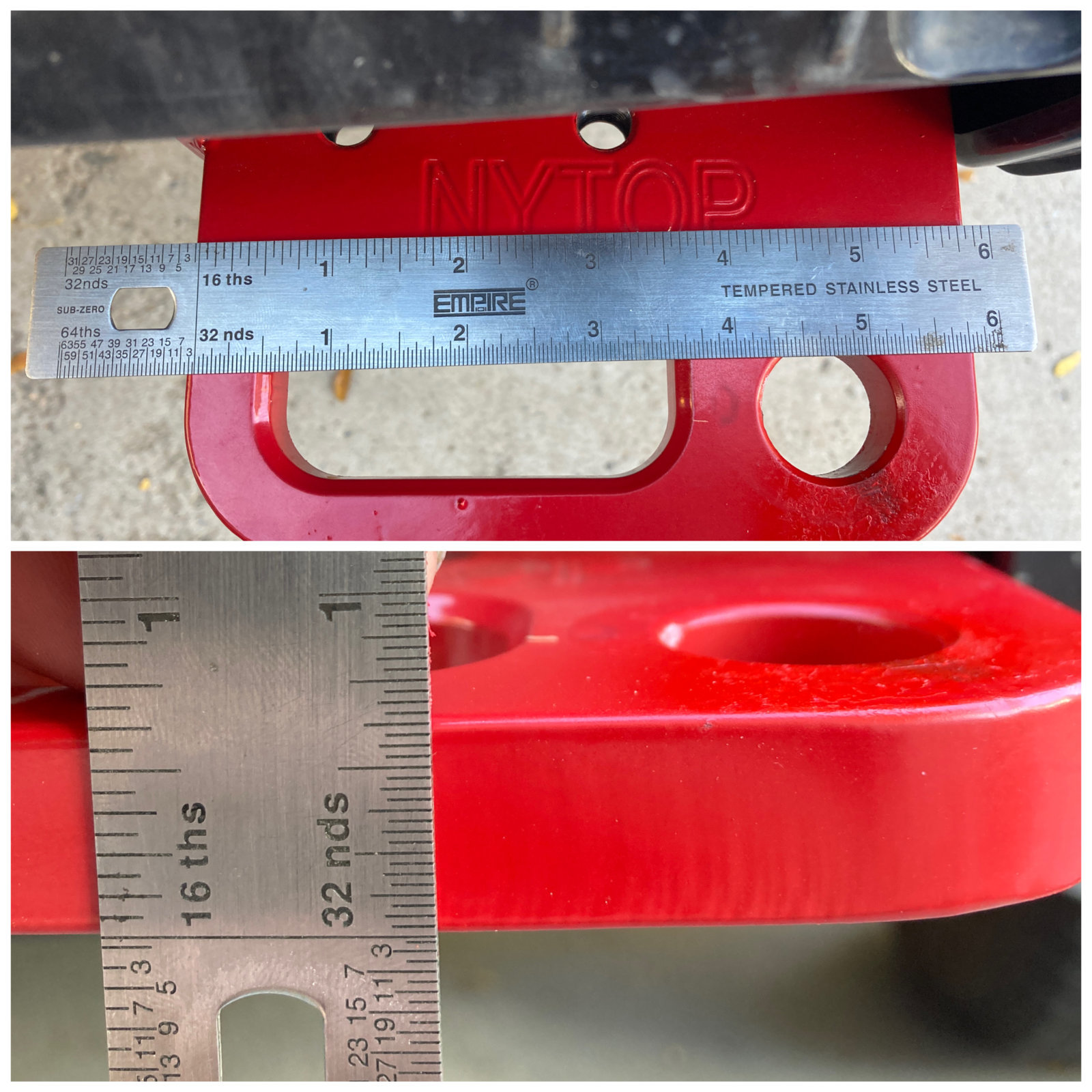

    So I finally got the NyTop items. Super solid. Each one is 8lbs and they made sure to pack them carefully. However one has three different blemishes in the paint coating. I’m going to contact them. If it was my company I wouldn’t have shipped this one. I’ll see what they say before I install them. No instructions with them but I’ll have to check the website again. I was expecting some instruction and hopefully a simple template for cutting for install.

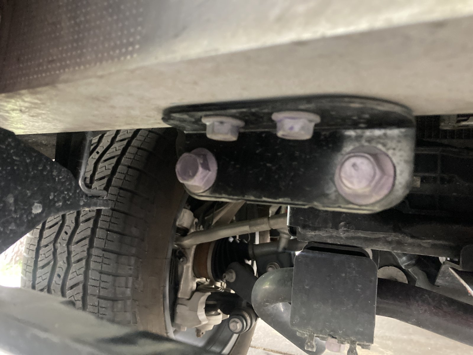

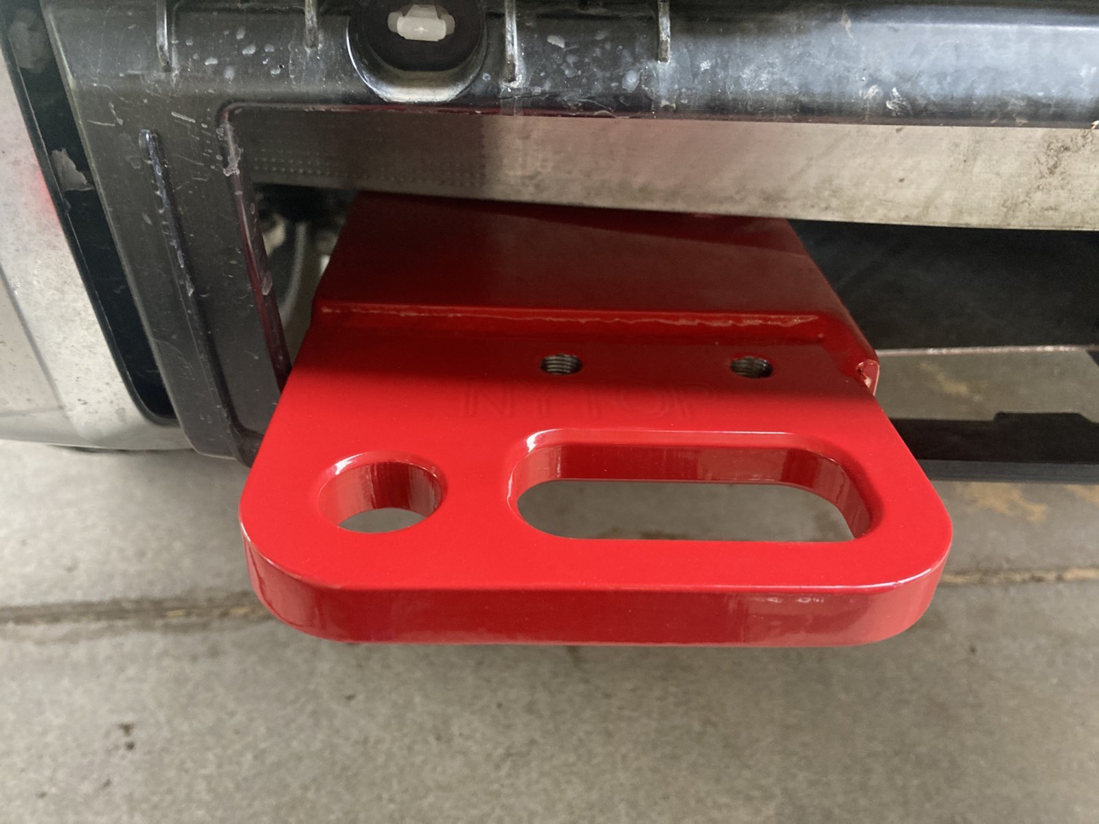

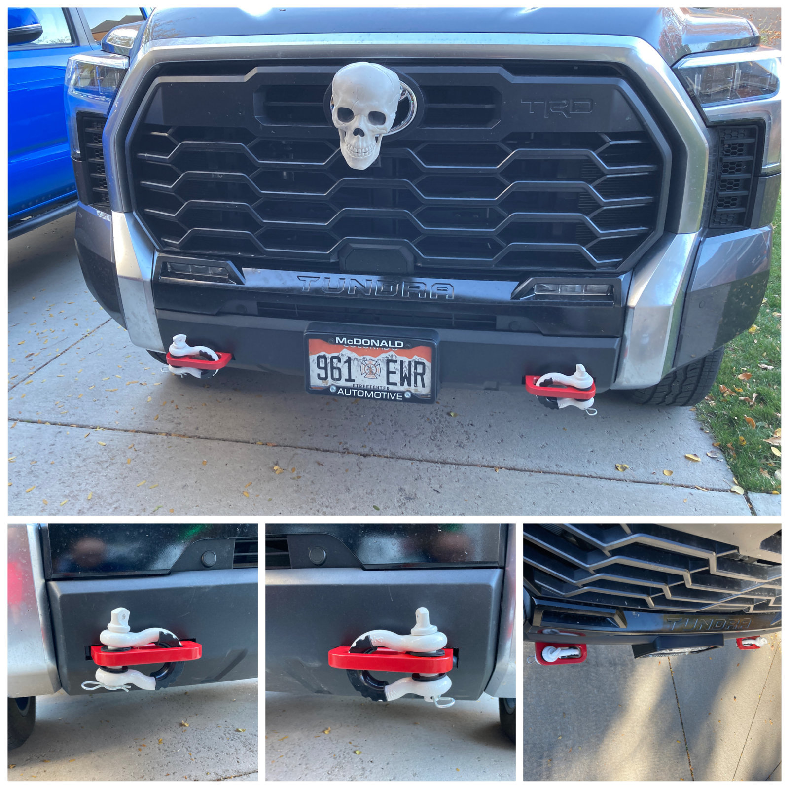

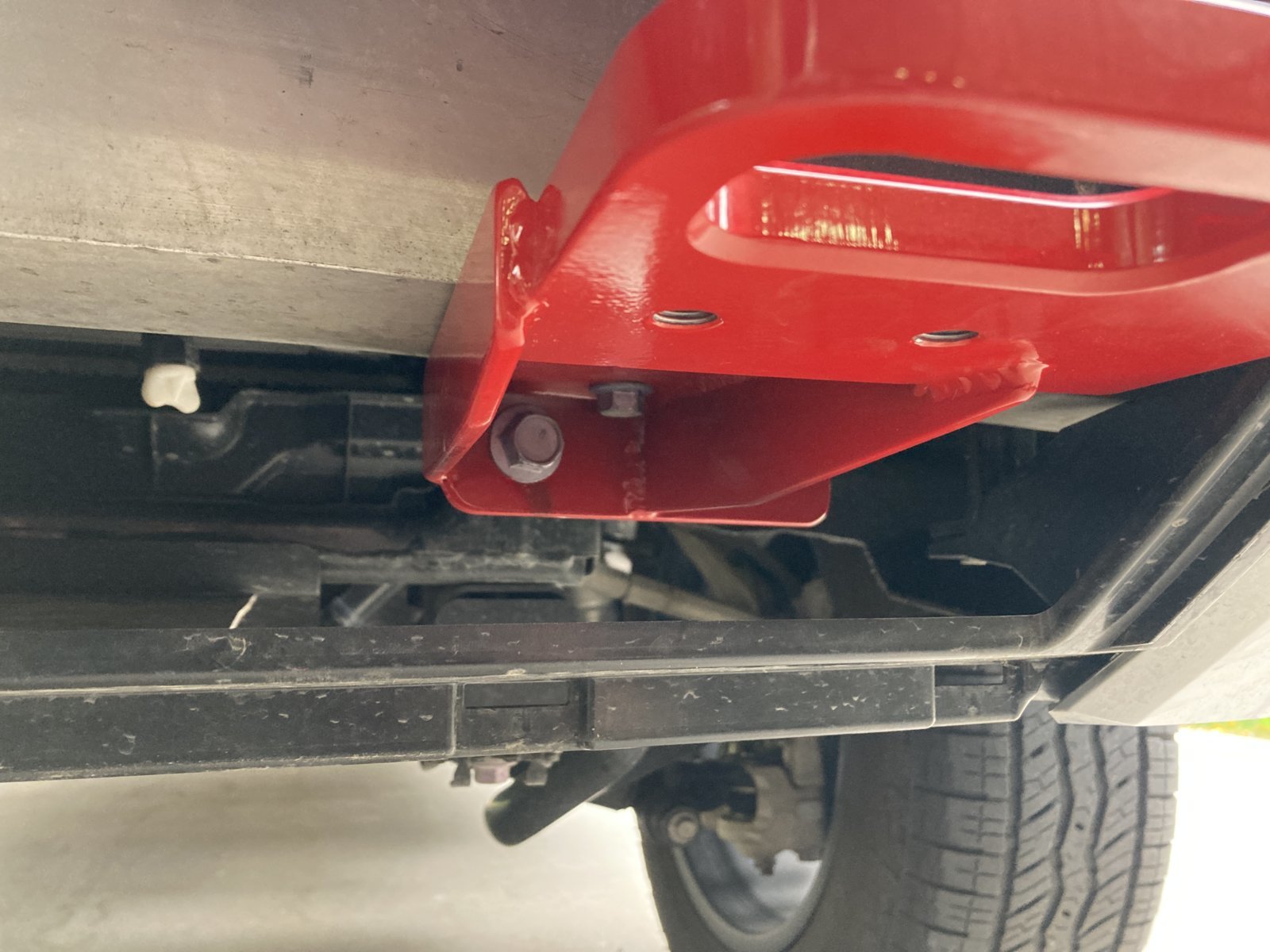

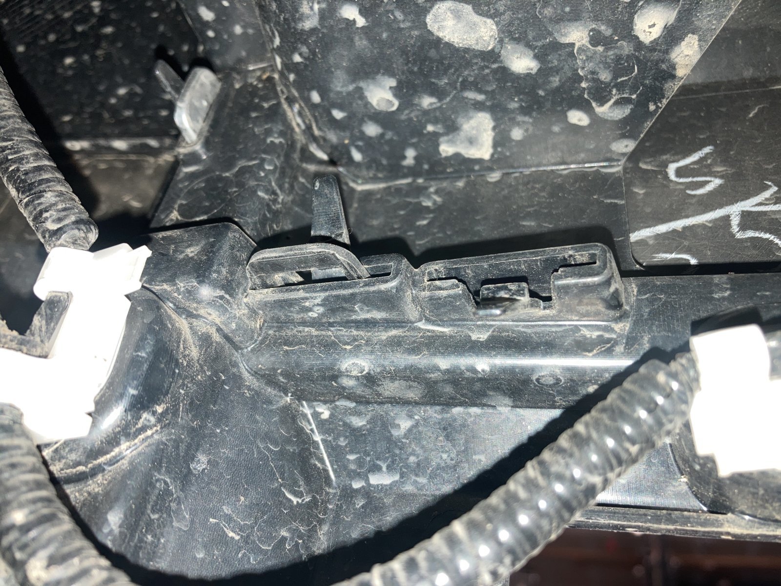

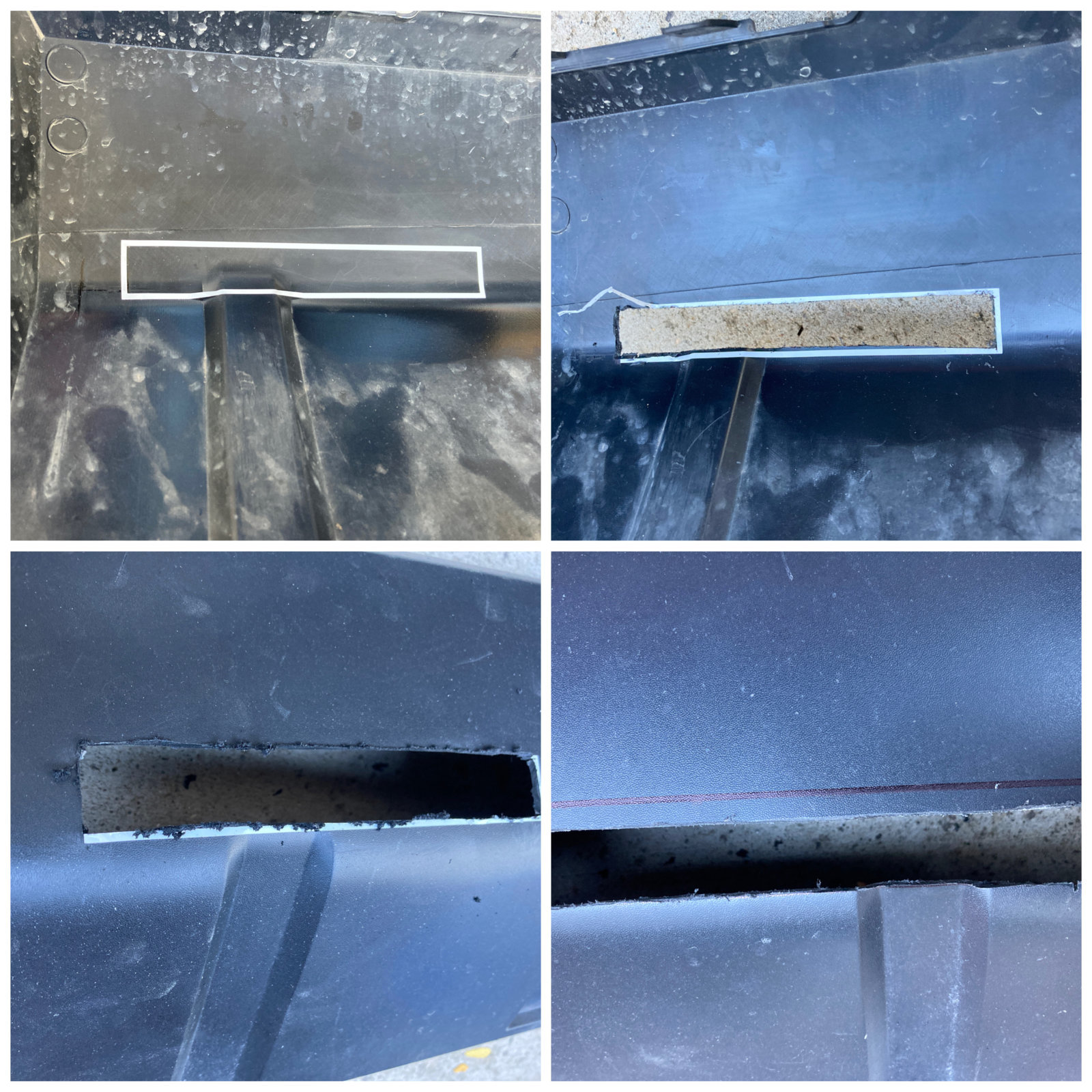

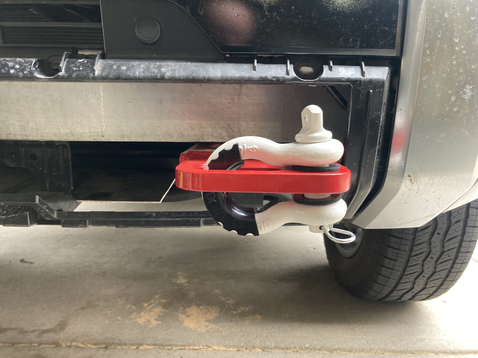

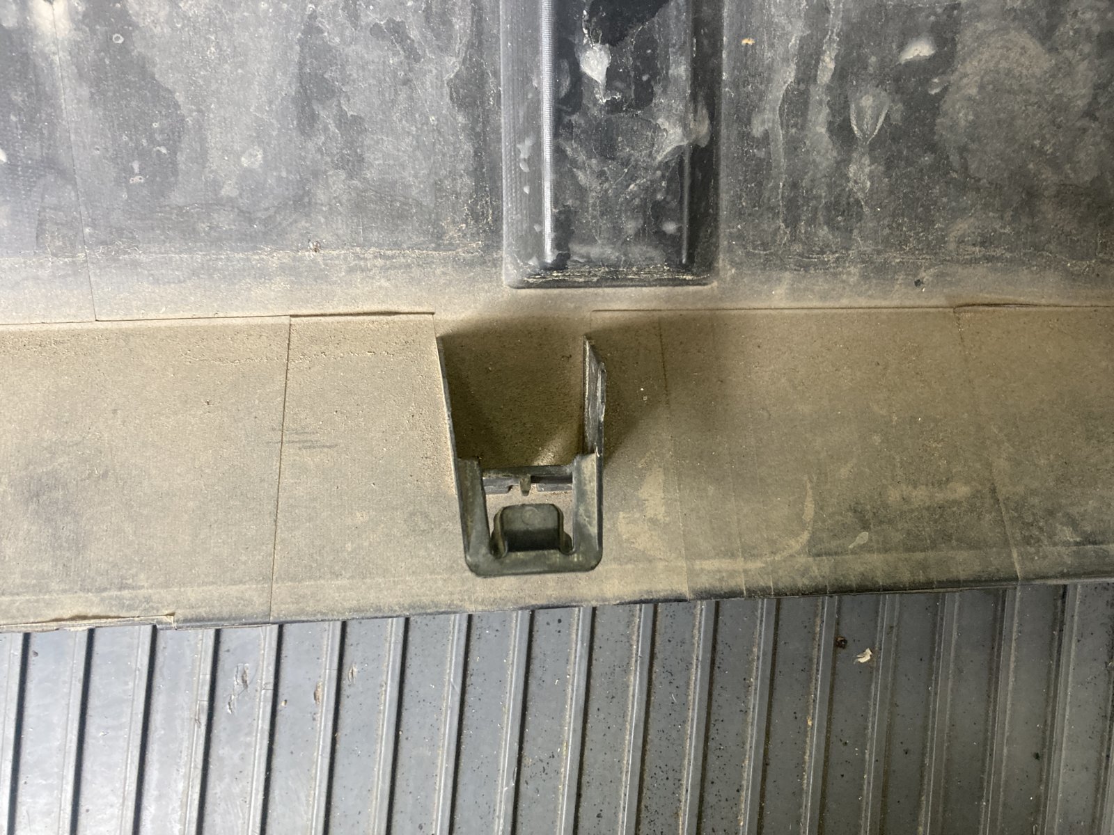

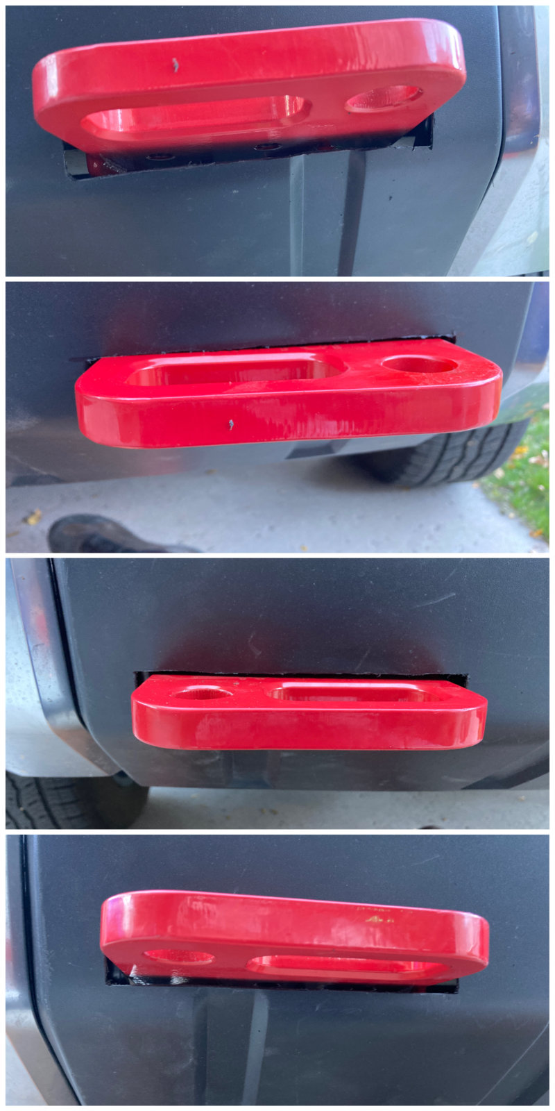

    Sorry for the delay. I've installed the plastic back over the front and the NYtop recovery points. Basically, if you never want a winch and this is a final version for you, I would suggest buying the metal cover. However it only bolts onto the recovery points. So it would look good and be better protection than the plastic but it's not really going to do a lot more to protect. But would be a lot easier. If you want a winch eventually or a fully bumper I would cut the plastic like I did or would just spend $200 more and get a covert style that holds a winch. I'm happy with my purchase of the recovery points, feel VERY comfortable in their ability to perform and am very happy with their follow up customer service. Compared to where the AFE option bolts on I like this a lot better. It is way more secure bolted onto the frame and crash bar with four bolts and on the front so I won't screw up my bumper.
    The install:
    My truck is not a show truck and I don't really care if things are perfect as long as I did them myself. So you know, hate away that the cuts were not perfect.
    Removal: Removal of the plastic was fairly easy. There are a lot of clips and there are two side clips under the mustache part you have to break off if you don't want to take more stuff off. I broke those off and on reinstall had not issues. This was called out in the install video I watched on YT from their product page.
    Install of the recovery points was super easy. Unbolt the brackets for the crash bar to frame and bolt on the recovery points.
    Putting the plastic back on was trickier. Nytop told me they do not have a template. Oddly enough the recovery points are not centered in the plastic. I believe this is because they go on brackets that normally are covered and so Toyota did not bother to center them. One is right against the edge of the bumper and one is slightly off the edge. You should be able to tell in the pictures what I mean. However I assume all Tundras must be this way or Nytop would not be able to sell the mass produced metal piece because it wouldn't match up. So I would ASSUME my measurements should work on your Tundra. But don't blame me.
    Having no good way to know where to cut I used grease on the recovery points and pressed the plastic against it. We measured the recovery points and we measured the sides of the rest of the bumper. My friend has a vinyl cutter so we made rectangle stickers. You could do this with graph paper and mark it as well. Measurements were 6.25 X .875 in inches because I'll measure in whales before I use metric. If you want to make your life easier make yours 6.5 X 1. One side I cut from the back but the bend was a pain. The other I cut from the front by drilling holes in the corners and doing a second marking on the front after marking the back. Measuring on the plastic from the side and the top the passenger side would be down 2.78 and over 1.4 inches. The driver side would be down 3.125 and over 1.625 inches. As I mentioned, not centered in the plastic.
    After cutting reinstall of the plastic was fairly easy. You have to be careful the clips go back in place. They are really flexible and it is easy to miss. I had to bend it some to pop it back in place because it is curved but it snapped back into place and is very solid. I've been driving around for a week with no issues including in snow.
    Feel free to ask more questions if I didn't explain it well.

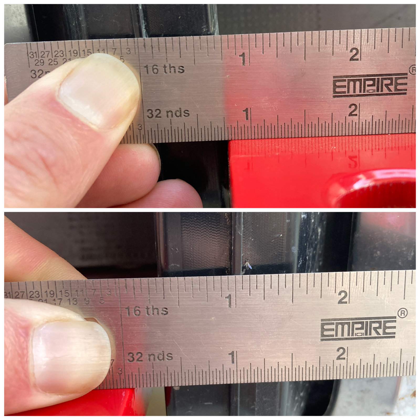

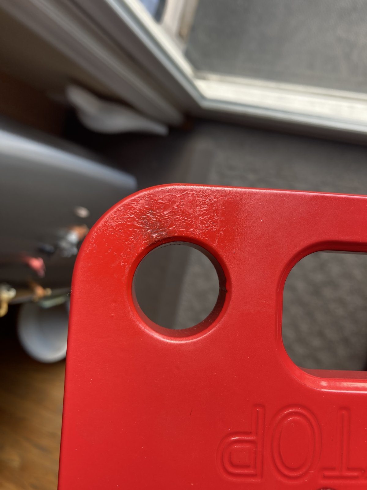

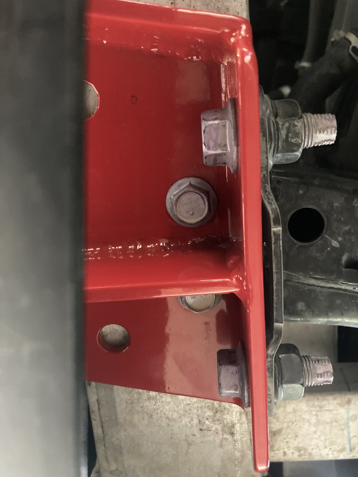

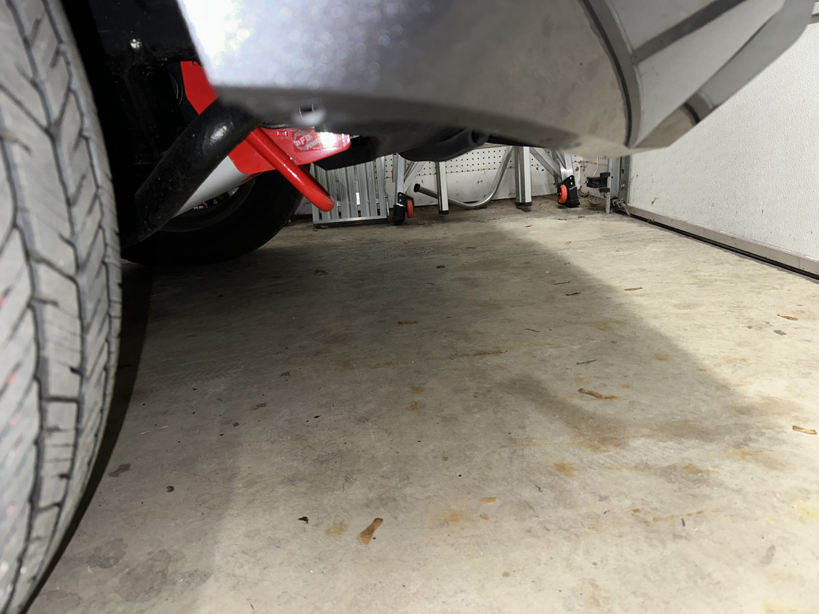

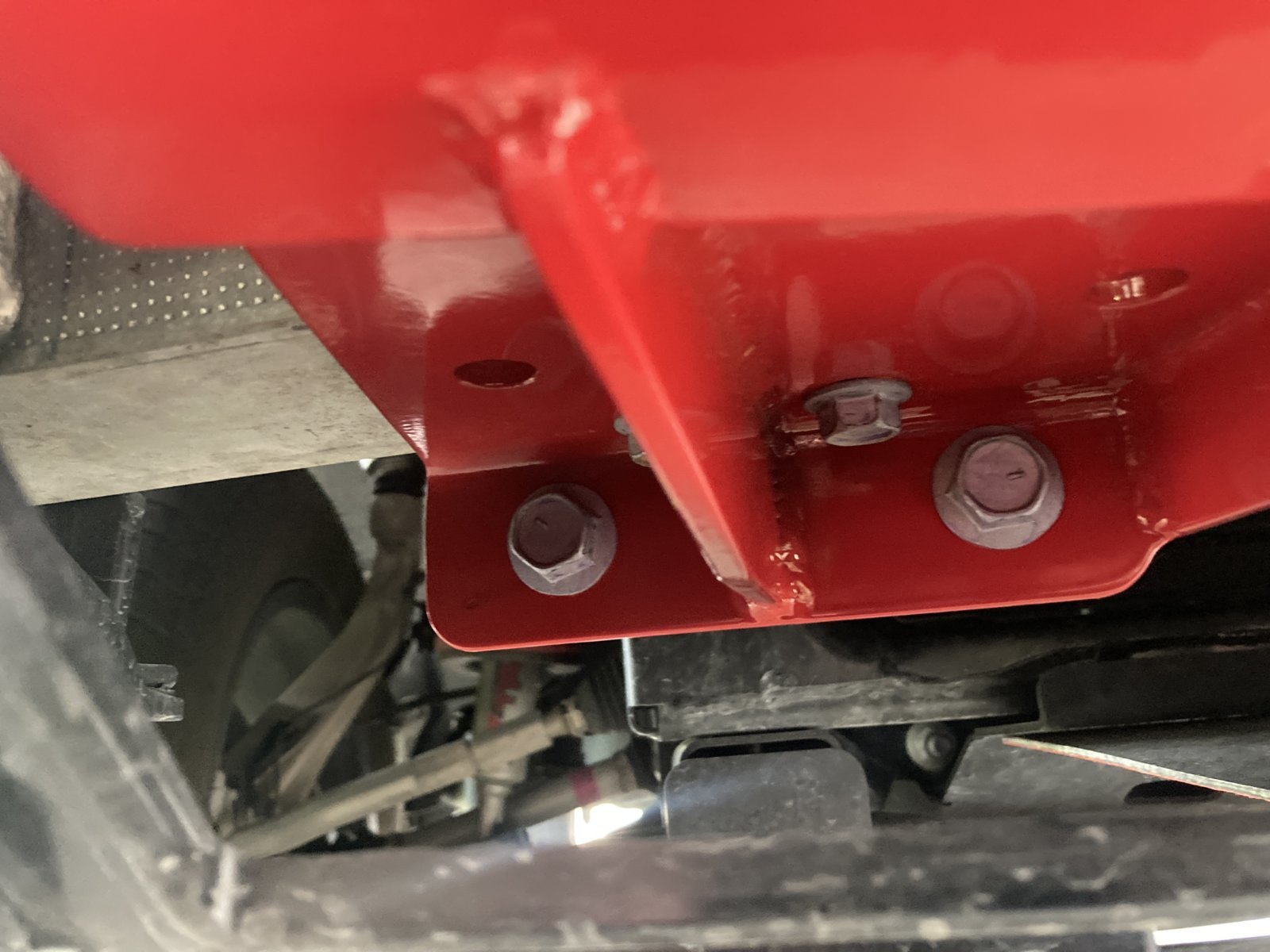

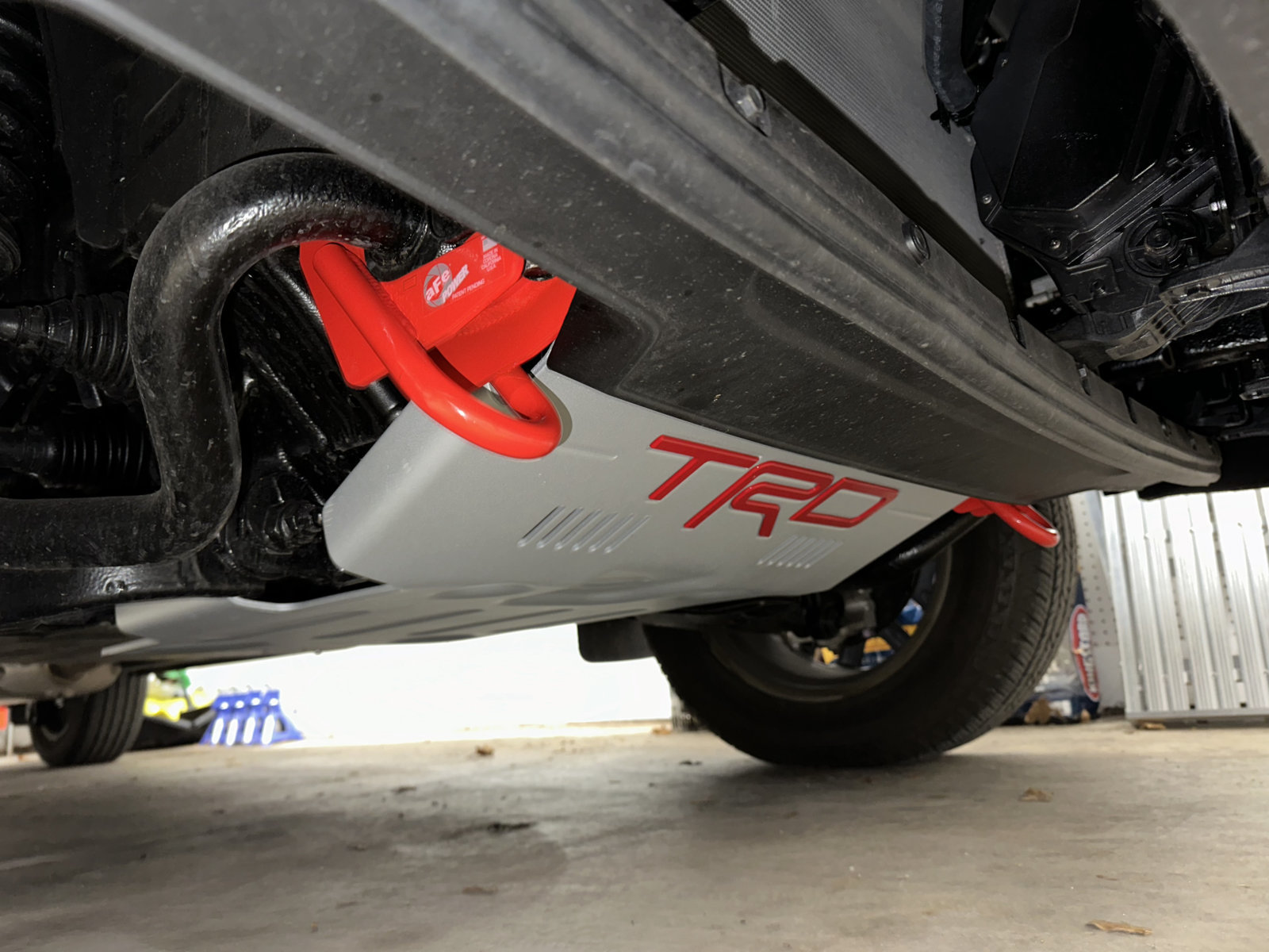

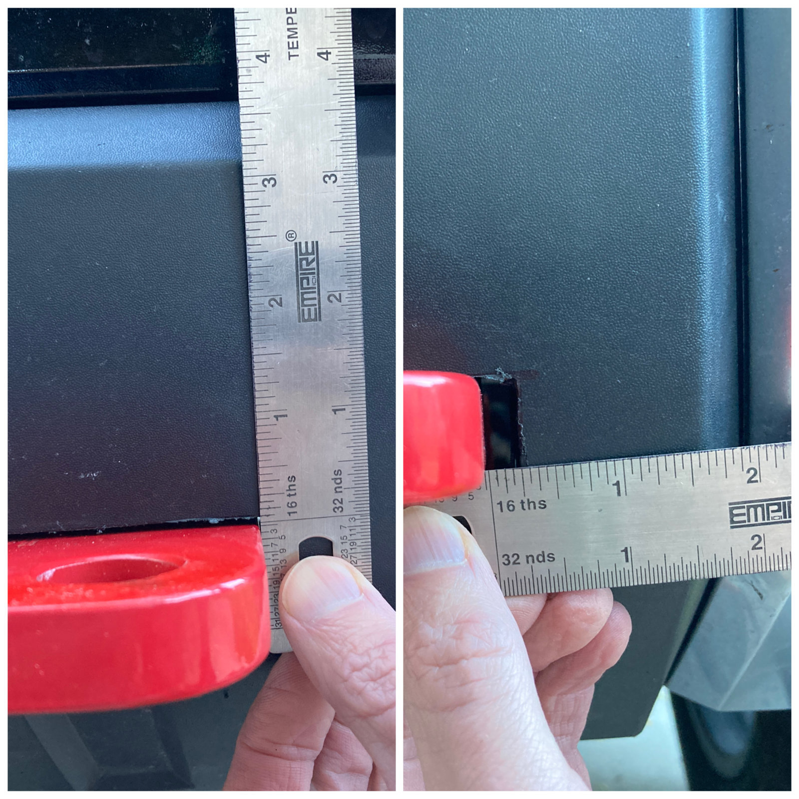

    I decided to go with the AFE tow hooks. Install is pretty easy. I would recommend removing skid plate first. Also, you have to bend back the factory retaining tabs. The front two just a little but the back one I recommend flattening it completely so you aren't smashing it down when you torque down the AFE tow hook.
    As far as pull angle, it looks like it is barely touching the valance at 0 degrees. At 10 degrees it is deflecting the valence a little. At 20 degrees it is deflecting it a lot. Above that you would probably have problems breaking the valance.
    Overall it is not too bad. They definitely did very well in the construction and the welds.
