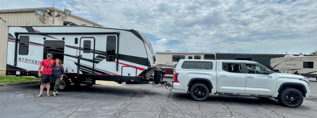

    For what it's worth, I added 10psi to my stock rear tires for towing my 7000# trailer with WDH.
    Really happy with how it towed on our memorial day trip. No porpoising. No sway to speak of.
