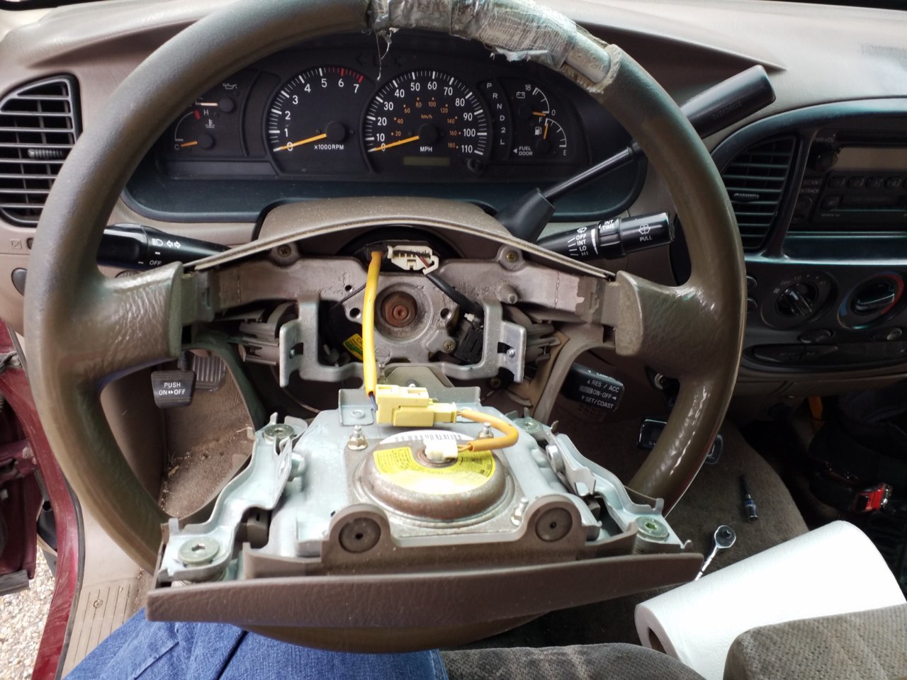

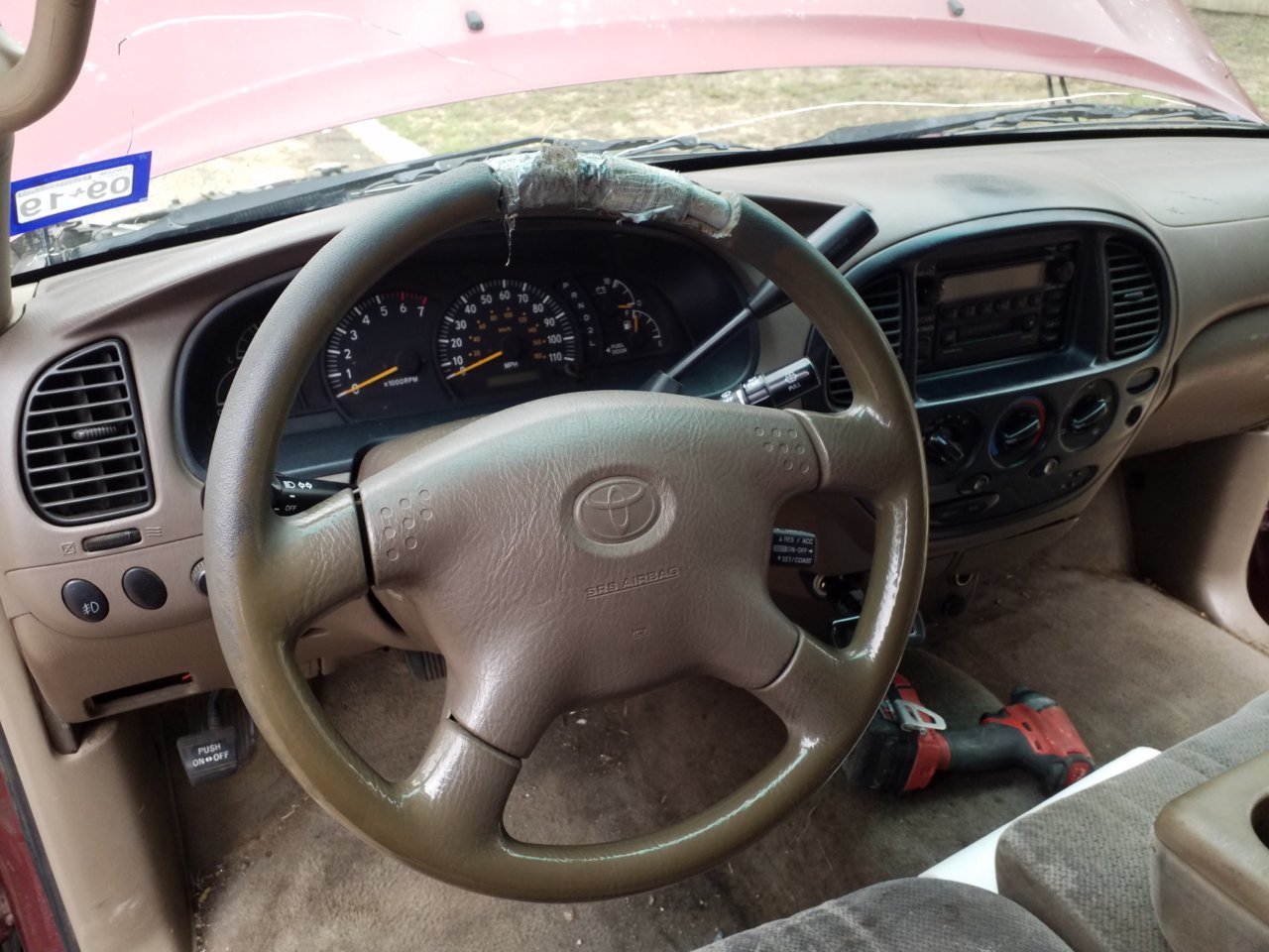

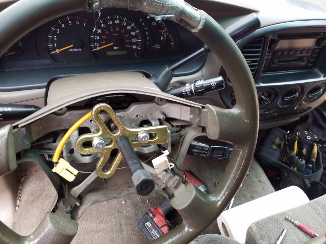

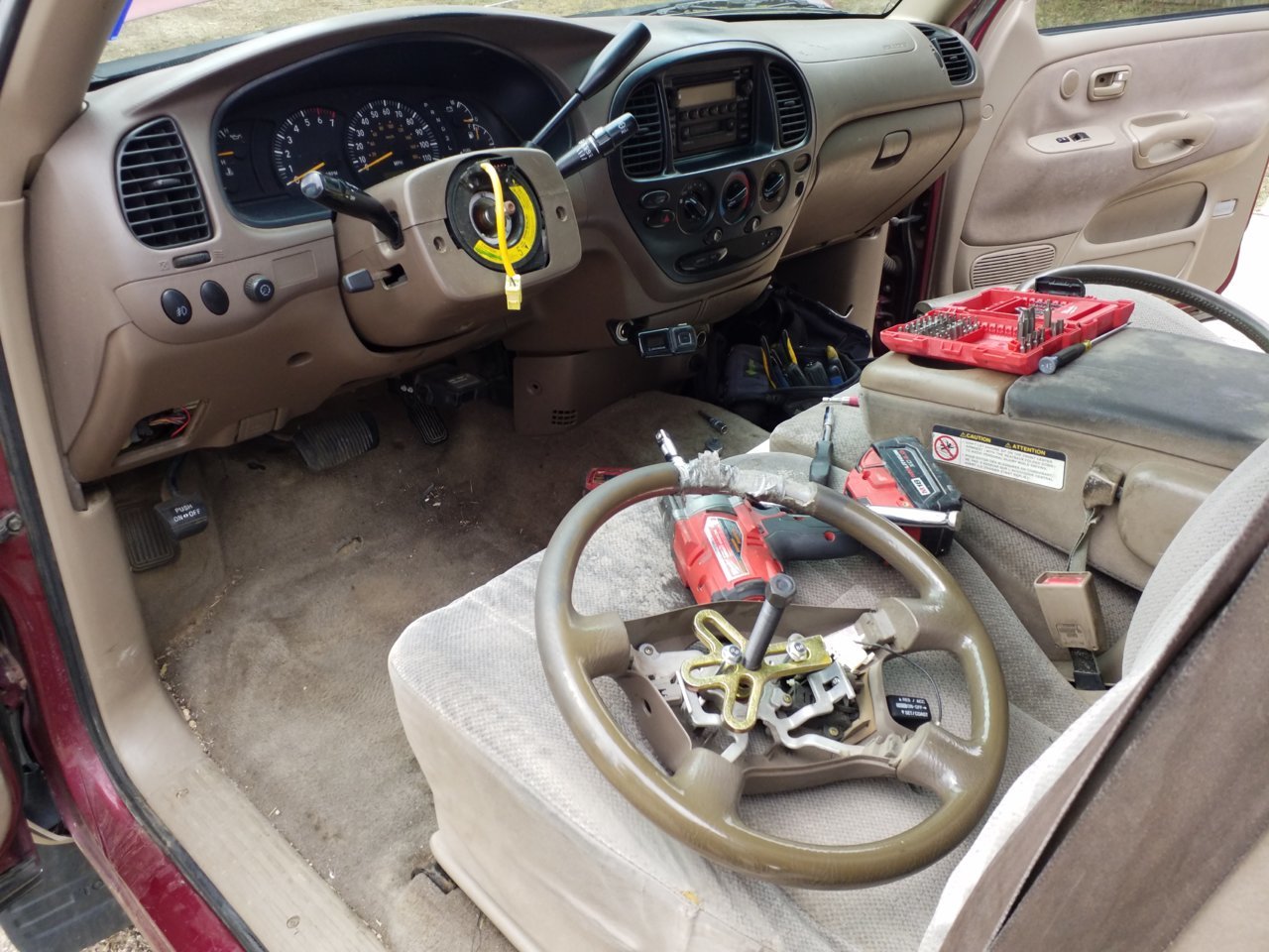

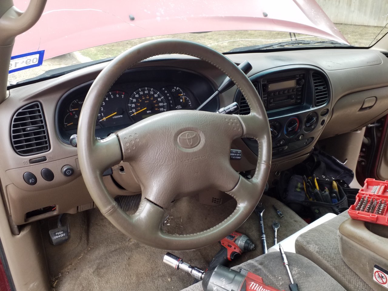

    I don't thing they necessarily wear out, just crap out. And yeah, pulling the wheel is easy, but those stupid t25s on the side suck to line up.
    Pics for anyone needing them.
    No need for a SST, crow foot works fine.
