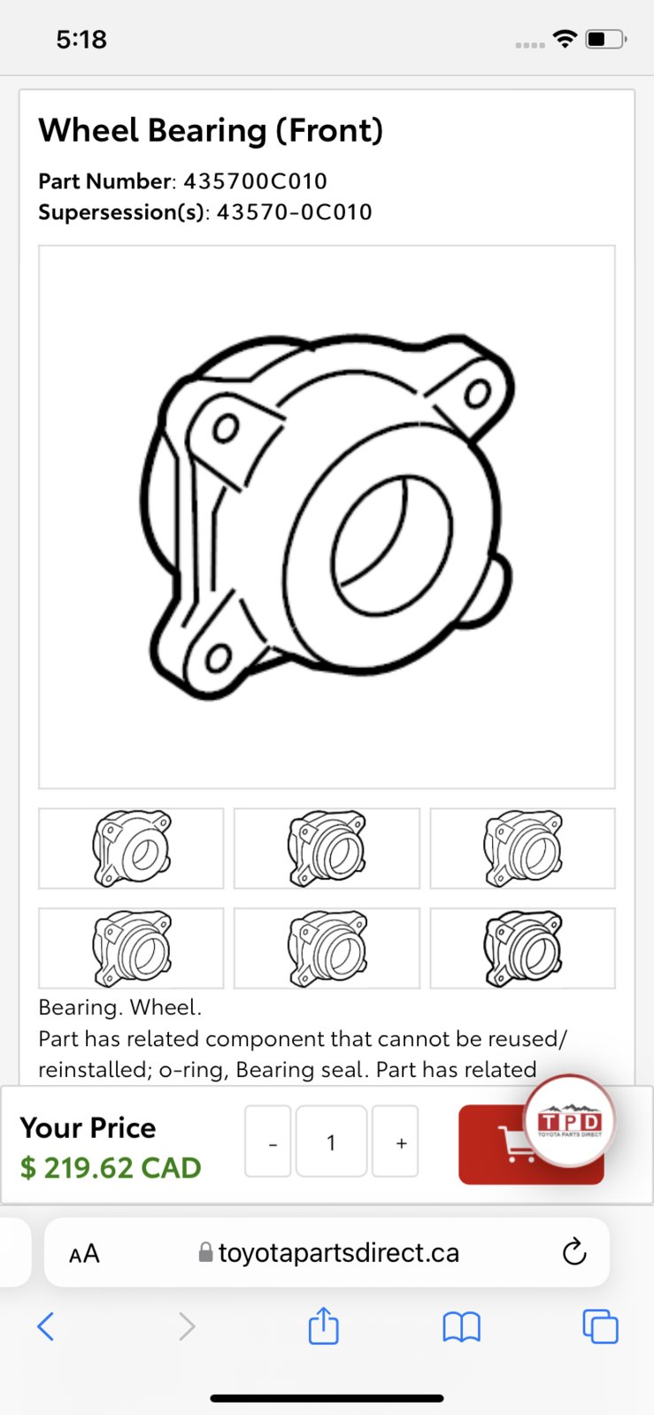

    Switched over to my summer tires last week and after a few kms, I noticed a strange grinding noise coming from the front left tire. Immediately thought I hadn’t tightened up the lugs nuts sufficiently. Went home and checked and they were fine. Was a bit perplexed, and checked it out a few days later. Finally determined the hub/bearing was no good. Ordered what I thought was a “hub assy” from the dealer and only got the bearing. Was wondering why it was cheaper than the one from CarQuest.
    Now I know why, as it is just the bearing. Lol!

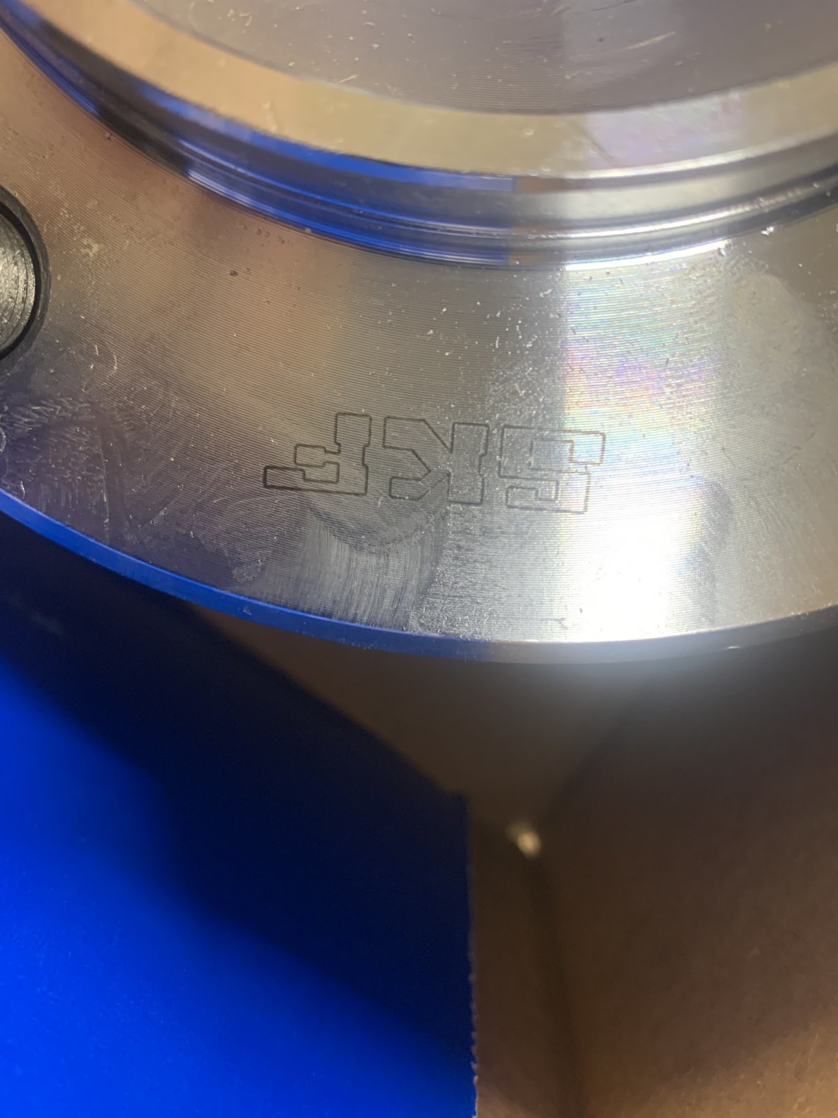

    I’d like to see his that would work. Just picked up a SKF bearing/hub assy up at NAPA. Comes with a 5 yr warranty. Glad I was able to get something other than some Chineseium one like the one CarQuest had. Was only $15 more, but doesn’t come with the o-ring. Does come with the seal though.

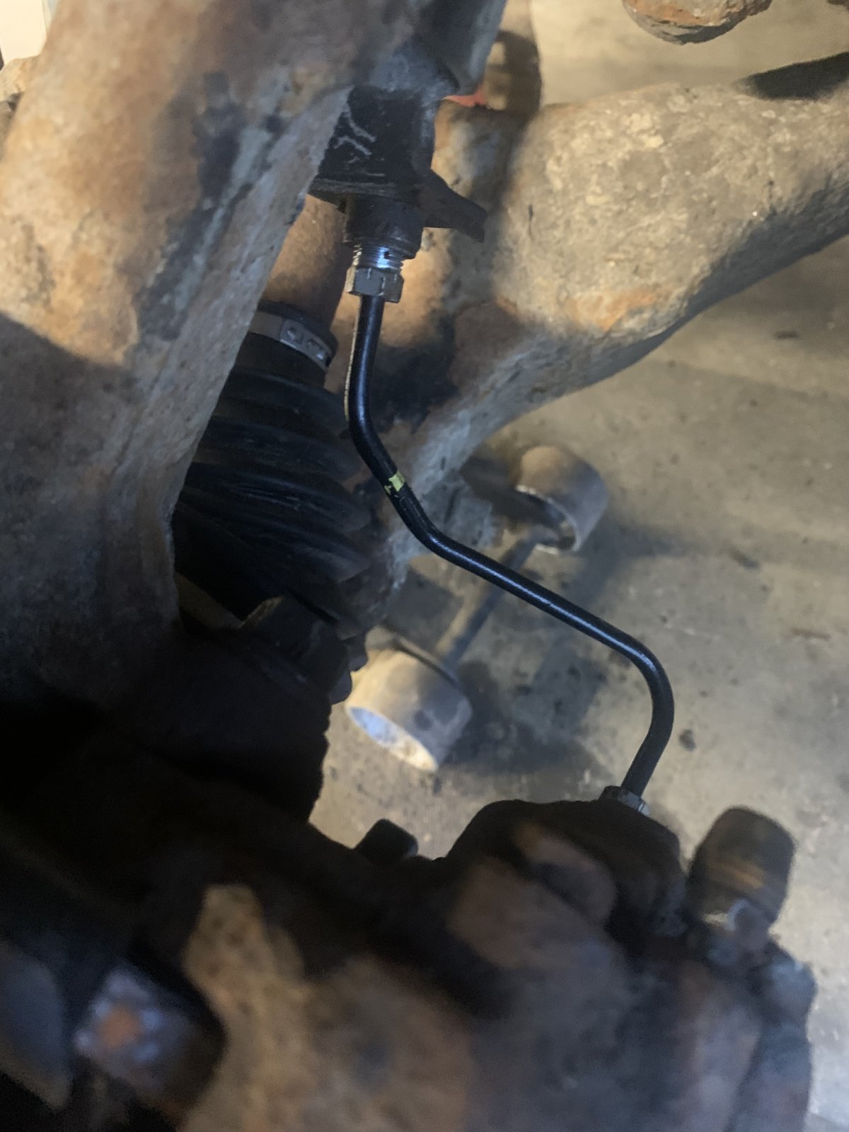

    I managed to break the hardline yesterday going to the caliper while hammering out the old hub assy. The caliper was supported with both a bungee cord, and coat hanger, but was resting against the knuckle. Ordered a new one from dealer yesterday, but went into town to get a generic line anyways as I wasn’t sure if would really be here today.

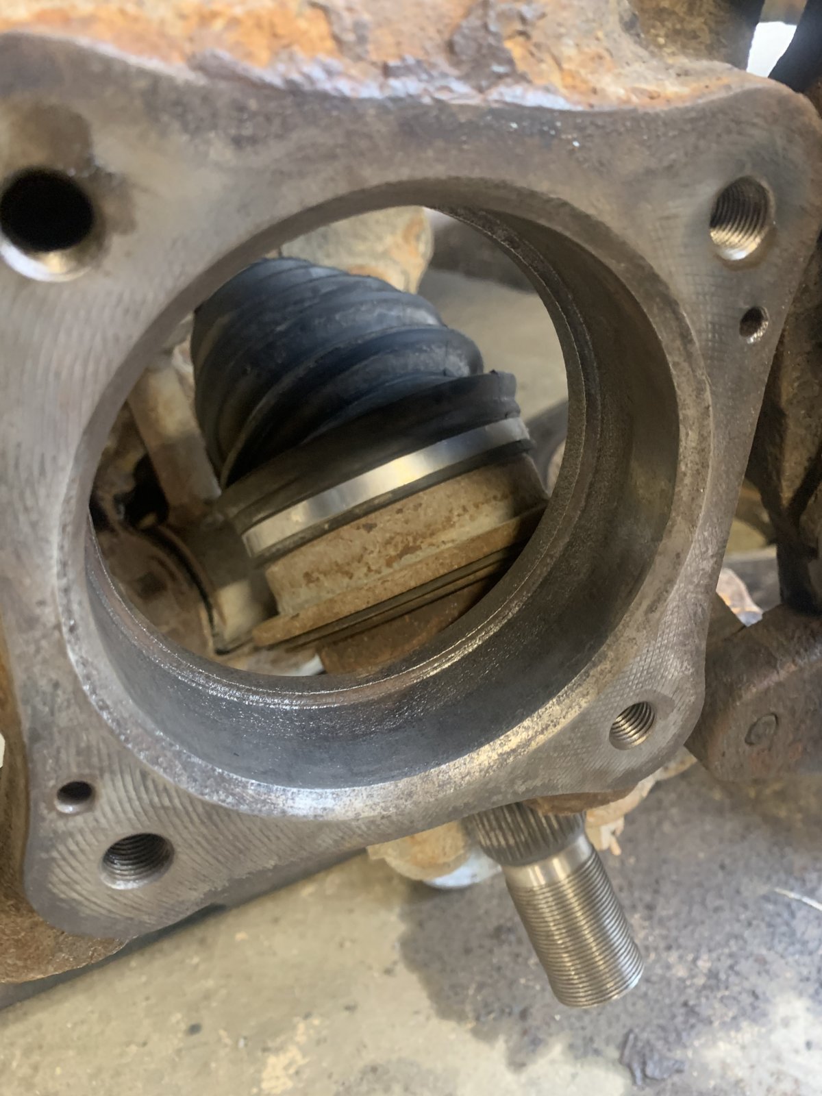

    Got the damn thing I stalked finally. The damn springs on the rear seal kept popping out every time I was trying to line up the splines on the CV shaft with those on the hub. Happened four times, and each time I had to remove the two bolts on the bottom of the knuckle so I could swing it out of the way, remove the CV shaft from the centre of the knuckle so I could snap the spring back into position. Finally I figured out to wedge a 2”x4” under tge CV boot to keep it centred in the seal/knuckle. Speaking of the seal, there was NO seal! Guessing that is why the bearing(s) failed. I had the thing apart last summer fall, and I’m sure I bought and installed new seals (did both sides - new tierods, ball joints, and dust shields). My daughter had taken it to a small local garage on Dec/Jan due to the 4x4 nit working. They determined it was the LF ABS sensor and said there was grease on it and that they cleaned it out. I know they messed with it because I could barely loosen one of the caliper bolts, and had to use my 3’ breaker bar to loosen it. I never tighten caliper bolts that tight. Thinking these buggers fooked it up. Also, installed the new brake line from the dealer.

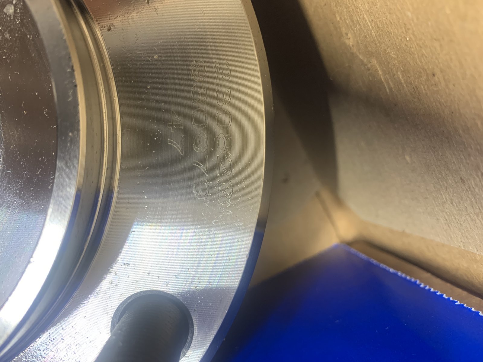

    Forgot to mention, after I installed the bearing/hub assy, I noticed on the box it WAS made in China! Damn! You even wonder these days if it is some knock -off. It was still over CAN$400!
