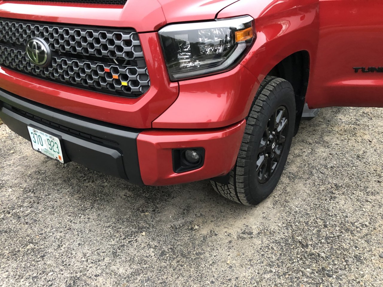

    Led Pro headlights, big difference driving in the dark.
