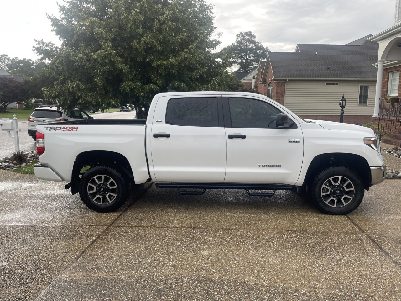

    Looks perfect, that’s the exact set up I have, trying to decide on 275/70 or 285/70. Do you have a pic with your 275/70 coopers by chance? Thanks!
