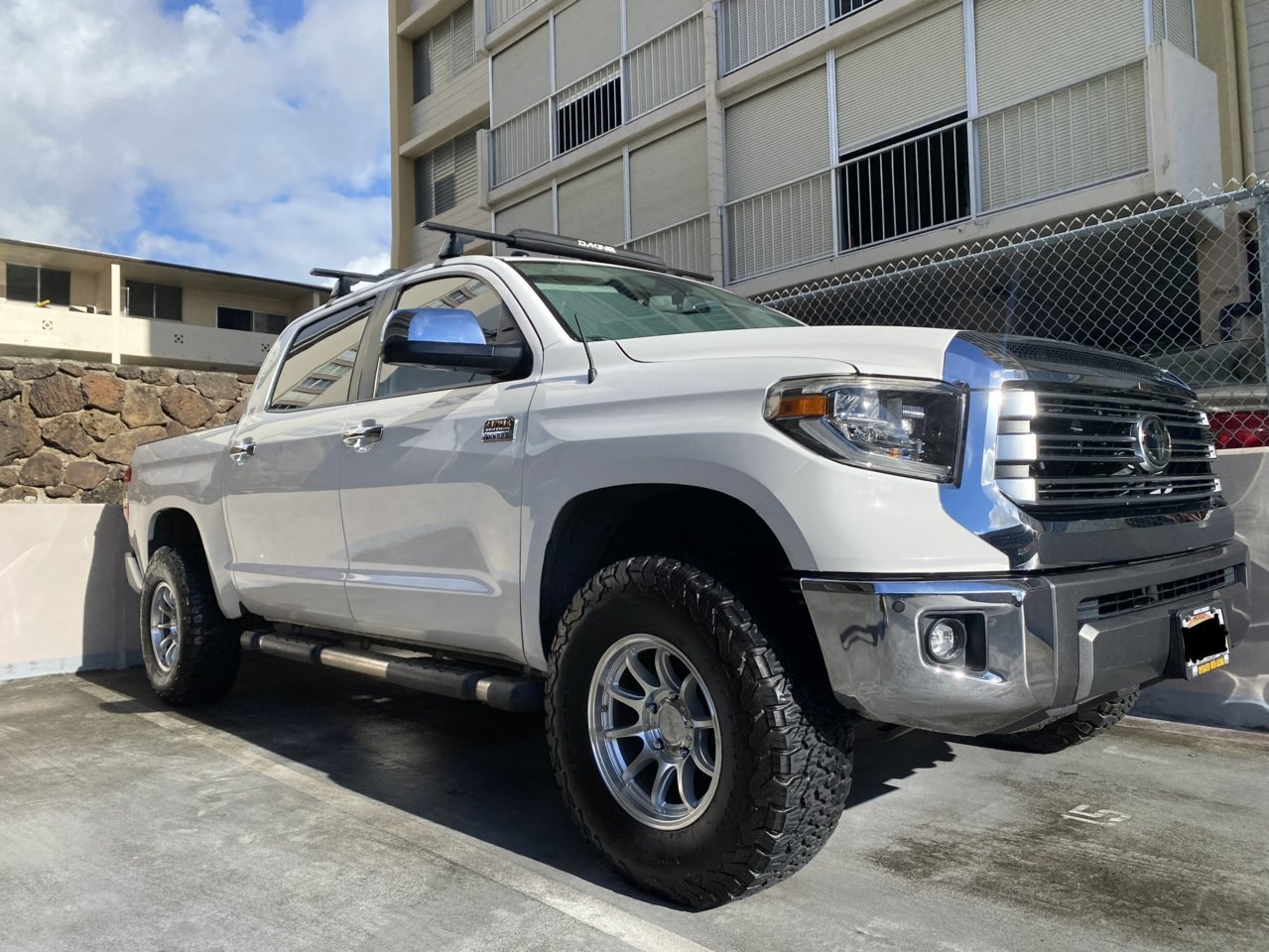

    1/2” coachbuilder shim drivers side
    1/4” coachbuilder shim passenger side
    +2 coachbuilder rear shackles
    SPC Upper control arms
    17x9 Summit Apex 0 offset
    315/70 R17 BF Goodrich All-Terrain
    I love the ride. I have about 1/4” of rake.

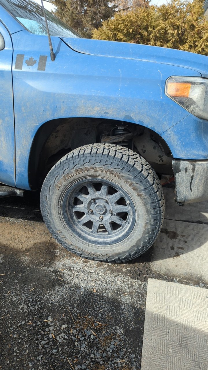

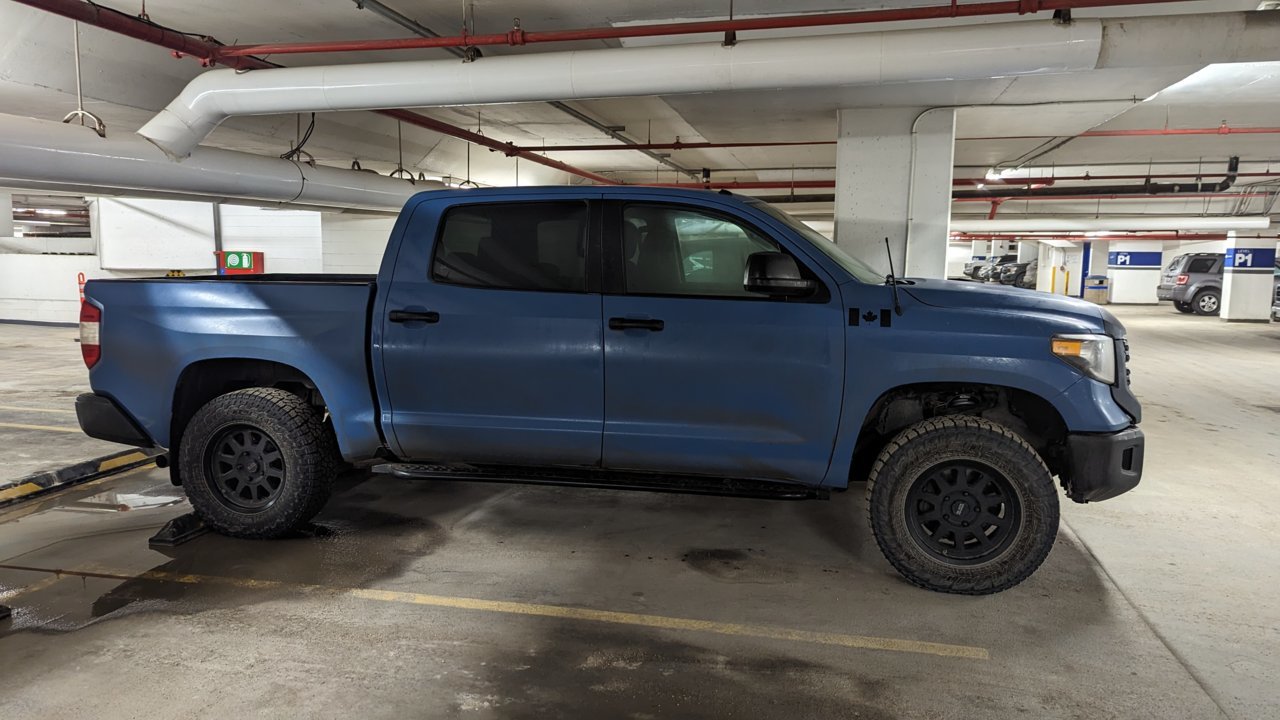

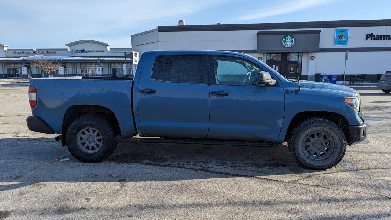

    Finally got mine on.
    A bit more tire clearance, fixed minor rub on full lock reverse and should hopefully absorb all the spring pot holes and get me ready for camping and fire road exploration.
    Before:
    After:
    Ebeast[OP] likes this.

    I'm happy with them, we don't do any major off-roading, so didn't need 2.5 or 3, more expensive suspension. Was looking for more tire clearance and the option to hit some forest roads when camping and fishing.
    We left the coilovers preloaded to however they were sent from Eibach.
    By my measurements, they are within 1/2" of the rear. They may settle a bit, which would be fine too.
    Now to see about adding front Timbren or SumoSprings etc. I don't know if they are needed, I still have to look into that.
