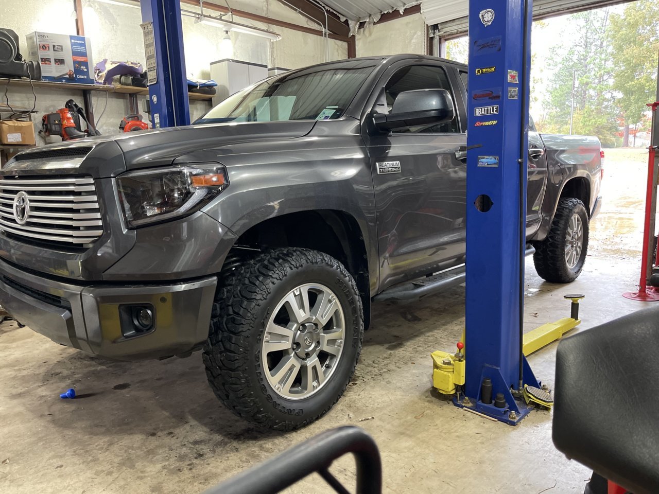

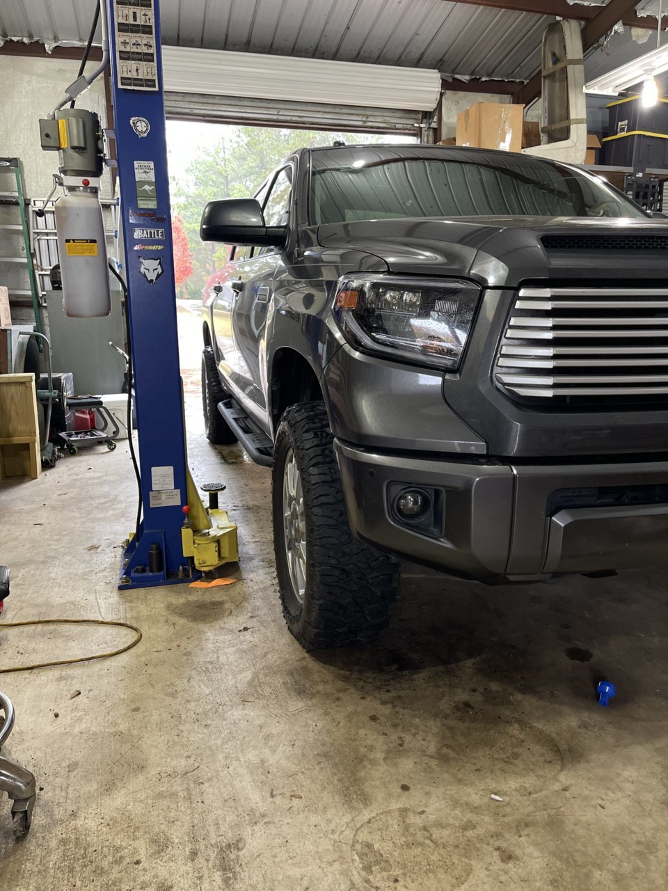

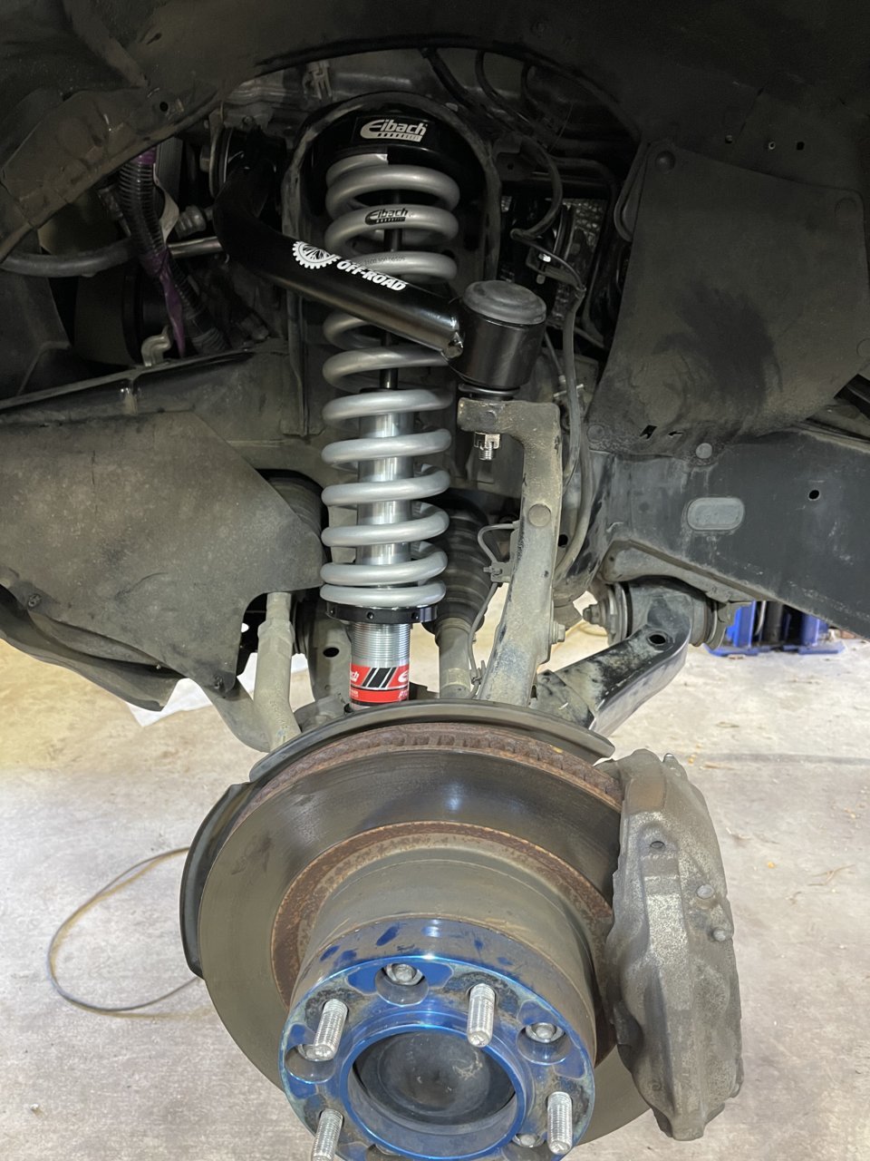

    Put these bad boys on. Man what a difference than that tired old level kit. Will finish dialing them in. Worth every penny so far.

    As noted by others those coilovers are SUPER cranked high. Hopefully you’ve gotten some resolution with re-adjustment.
    Also, what no one else has mentioned yet is your rear add-a-leaf setup that you have. That will really stiffen the ride up if you’re not consistently running weight in the bed (tools, cap, tent, or other glamping gear). If you consistently run an empty bed, shackles might be a better option for you to get some rear lift.

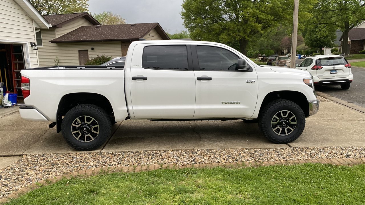

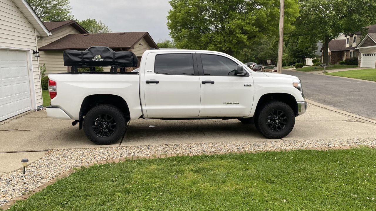

    At first the ride was a stiff, but since they settled it seems to be pretty decent so far. Its been over a year and I have added in the Decked drawer system and still feels the same with as if I have a empty bed or at least I just cant tell a difference anymore lol. as for the coils I did get them properly adjusted by a decent shop that deals with Off-road type vehicles. Started back at what Eibach was set from their factory and adjusted properly from there to give 2.5 inch lift on the passenger side and then a little more on drive side to account for the lean. that was probably like 8 - 9 months or so.

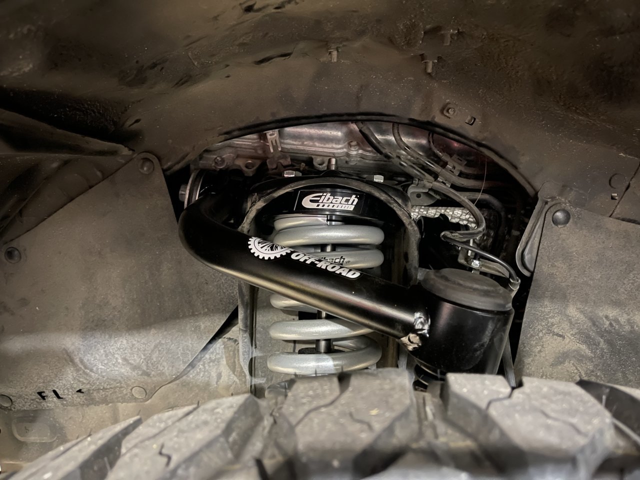

    very nice! how do you like that UCA? I am in the market for some officially now. I'm just worried because I'm still using the stock TRD wheels and if I need to run spacers to clear or not.

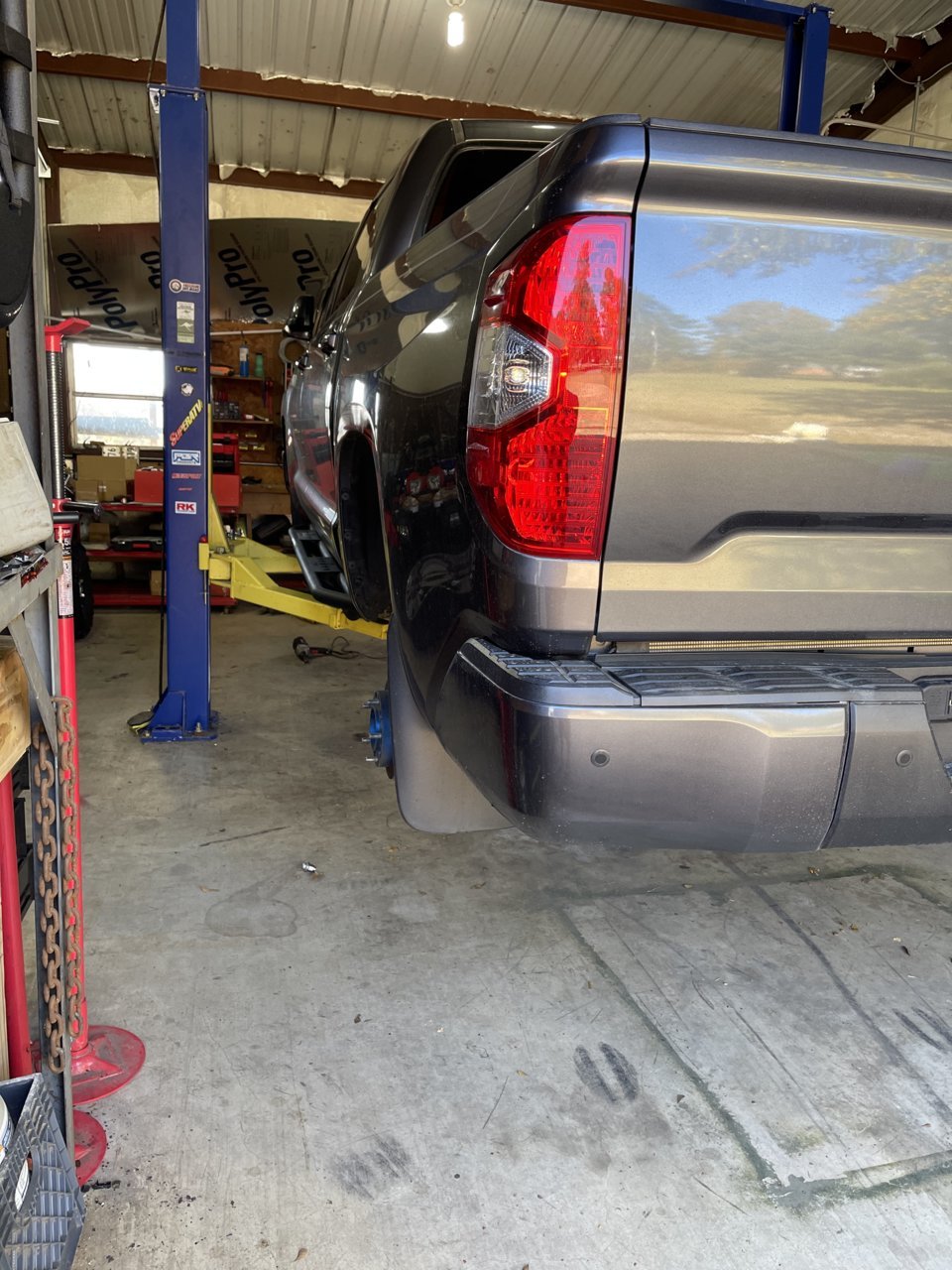

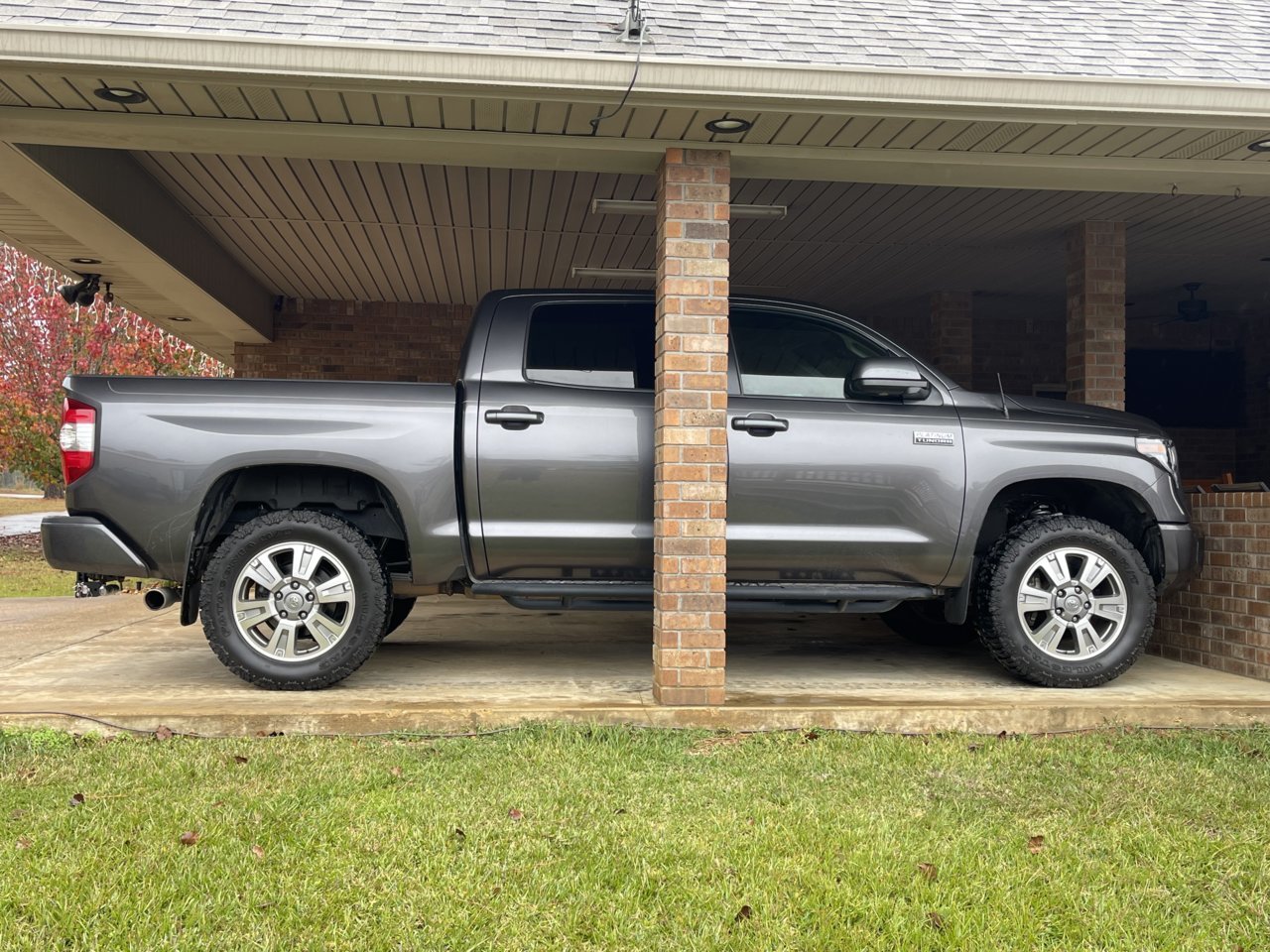

    Come back and dialed her in. Got about 1” rake.

    I am running spacers as you can see. Overall I am extremely happy with them so far. Going to drive it around a little more to see how it settles then take her in for alignment. The install on arms was the easiest part even. That long bolt was not that bad.

    Looking real good!

    Very nice! yeah I was hoping to see if I don't have to run wheel spacers if I get some Aftermarket UCA. Eventually my goal is new rims with a better offset. Question, what made you go with those UCA vs others? I was looking at JBA UCAs just for the multiple grease points and replaceability and of course with the positive feedback on performance from others on this forum. The only thing I don't like about them as they come in red only, which isn't a huge deal as I can paint them or have them powder coating something else after.

    My truck is 99.9 on payment. I read some good reviews on these arms. For the price point was a deciding factor also. I shot some grease in them this morning. Over all very happy with fit and finish. Real test will be alignment specs.

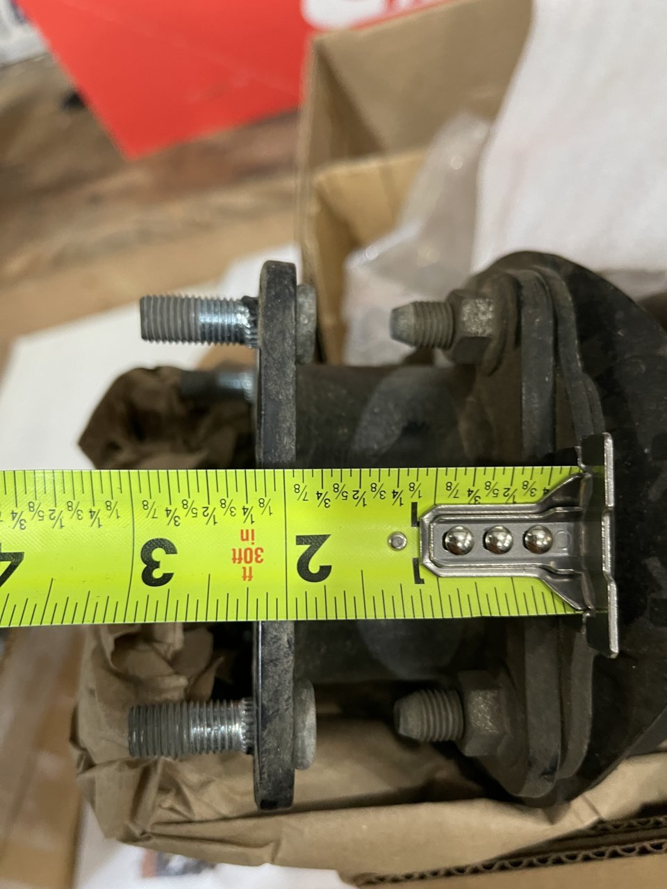

    My problem was I had a puck lift on there was about 2 1/4 of spacer. So guessing that was about 4” of lift. My tires always seemed to wear on the otter edge no matter how many shops are alignment. I am unsure how they even stuffed that dude back in the coil pocket. I will upload specs once I get it from shop. I have other vehicles to drive so going to drive it couple shorts runs to work, allowing it to settle. Love the fact with coil overs and rear air bags plumbed individual I can dial in suspension perfect on all 4 corners.

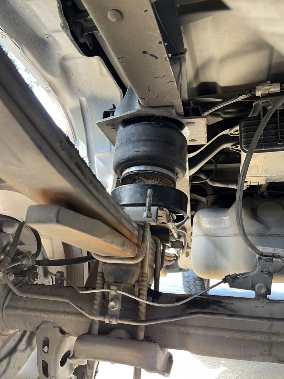

    Yeah running the air ride 5100 with cradle. Plumed individual so I can control.

    Very Nice! I am not sure how long you have had them on, but what do you think about them? how's is the ride quality? I've heard since it replaces the stock bumpstop that when it hits, it clunks real hard.

    They been on there for years just recently went to the cradles. I am very glad I have them when I do haul something heavy. Far as clunk not that I am aware of.

    perfect stance in my opinion - can you share the exact settings please? I've got this kit arriving next week and am wondering if I need to order the UCA's as well to achieve this
