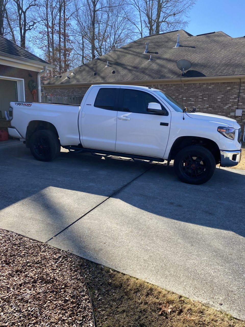

    Yeah I was watching this before was like shit does he just measure from the sticker or that small lip there. here you go for the side shot.
    This one is only minutes after getting back from the shop.
    Here it is after a couple of weeks.
    I feel sometimes when I look at it in my driveway its higher than what it really is. Could be me just being paranoid.

    Looks fine to me, nothing out of the ordinary. Not sure why you have so much more thread showing than the other setups on here.
    Without before and after measurements at the fenders its hard to say if you're too high or just right.

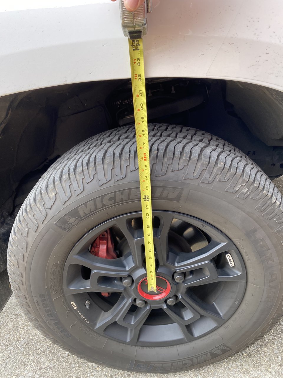

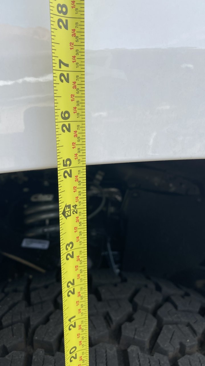

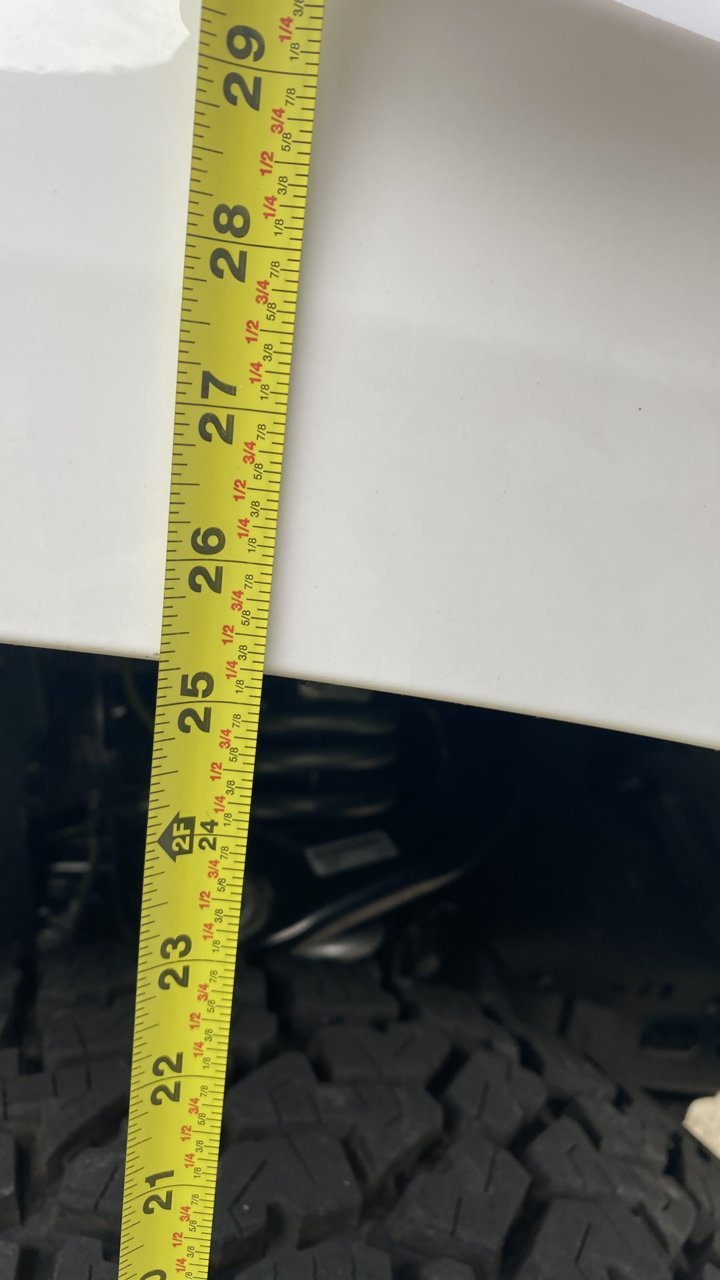

    Here is the measure from the center of the wheel to the fender.
    driver side:
    Passenger side:
  10. Jun 2, 2021 at 6:53 PM

    I measured mine from the bottom lip of the wheel, then subtracted the radius of the wheels width lip to lip.
    Basically mine measure 33.33" from the bottom of the wheel lip to the fender. The wheel edge to edge measures 18.5". So Im currently at about 24.1", making your lift about 1" higher than mine. Mines right around 2-2.5" so I'd guess yours to be 3".

    ah okay. so actually it seems that its slightly higher doing it what you did.
    so the stock trd offroad wheels are 19.5 width and halved that which is 9.75 and the bottom lip to the fender was 35 - 35.25.
    so the total driverside is 25.25 and passenger side is 25.5.

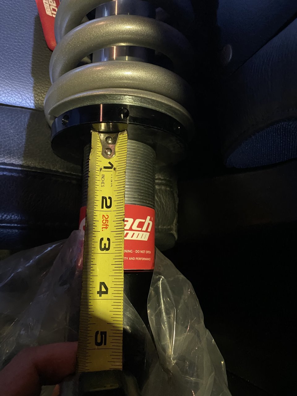

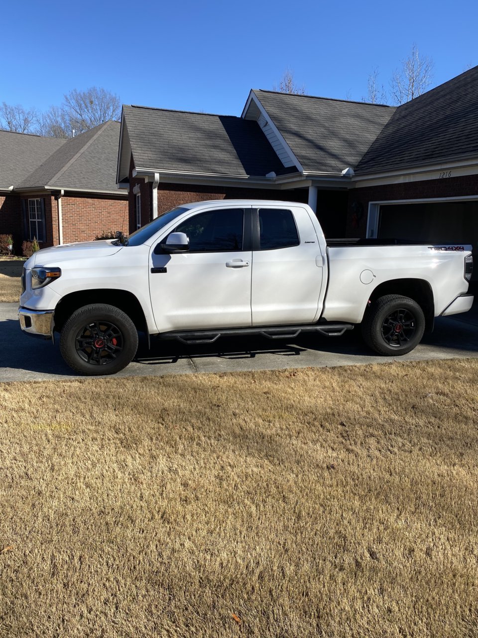

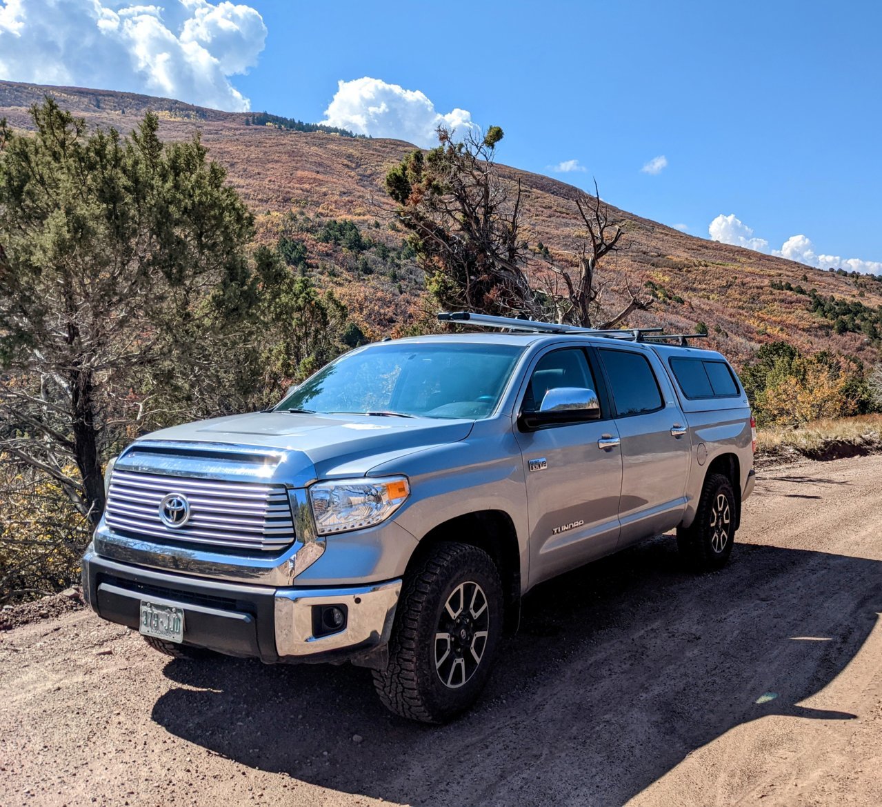

    Installed mine this past weekend with a buddy. Kept the fronts the same as they were out of the box. Added .5" shims to each side. +2 shackles on the back. Ended up around 2-2.25" in the front, and 1.25 in the back. We didn't measure before putting on. Only compared mine with a buddy who has a 2019 that he put an Eibach 3/1 on. Like it a lot. Rides great. Noticeable improvement. It doesn't pull, vibrate, or wobble, but I'm still getting an alignment tomorrow. 275/70 Coopers will go on Friday.

    Nice!! Looks really good! You wouldn’t happen to have any measurements of the threads while installed do you? Maybe that I can set it back to there and just add a .5 to it.
  16. Jun 30, 2021 at 5:08 PM
    #46
    Elduder
    Elduder New Member
    Apr 11, 2017
    #7206
    1,399
    Stock from Eibach, 3.25” of exposed threads.

    Thanks and sorry for the delayed response. Mine came from the factory set at 3 3/8”. I did not adjust any. Only added shims

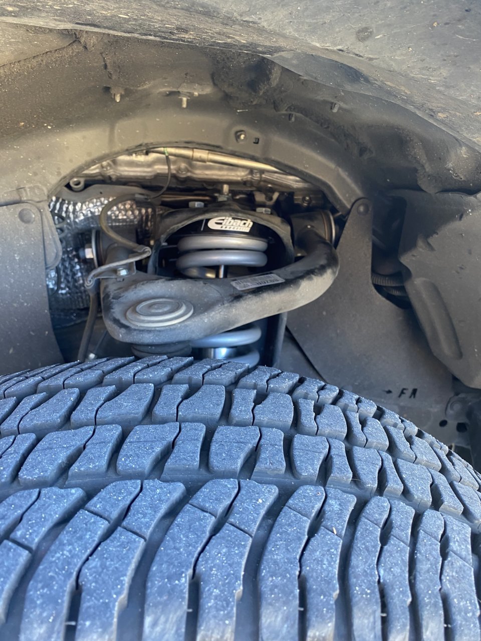

    Hopefully this is helpful, I couldn't find a ton of info on these when I was researching options.
    Just installed the Stage 2 coilovers and rear shocks with +1 coachbuilder shackles. 2016 Limited Off Road, blue and yellow Bilsteins with 75,000 miles. I was not really looking for a lot of lift, just better performance on rough roads. 275/70R18 tires that have been on the truck for about 5,000 miles. Really wanted to go with the Falcon tow/haul set up but those are not available till the spring and I have a couple of trips coming up so I went with Eibach. I backed them down a bit so I got about 1.5" of lift on the front.
    I am impressed, particularly with the damping. You hit a bump, the suspension reacts, and then you are back to normal - no more bouncing/floating down the road compared to stock (they did have 75,000 miles on them though). Hit a couple of gravel roads near the house and I can comfortably run 10-15 mph faster. Braking performance is much improved, no more nose dive and bouncing around under hard braking - the truck stays level and stops. Probably a combo of shocks and shackles but the bed now follows what the rest of the truck is doing rather than bouncing all over the place, this is what I am most impressed by.
    I had no rubbing on stock suspension but I had to bend my skidplate after install.
    Anyway, I think it is a great option for $1500 or so. I'm likely only going to have this truck for a couple of years so didn't want to dump a ton of money into it but I am happy.

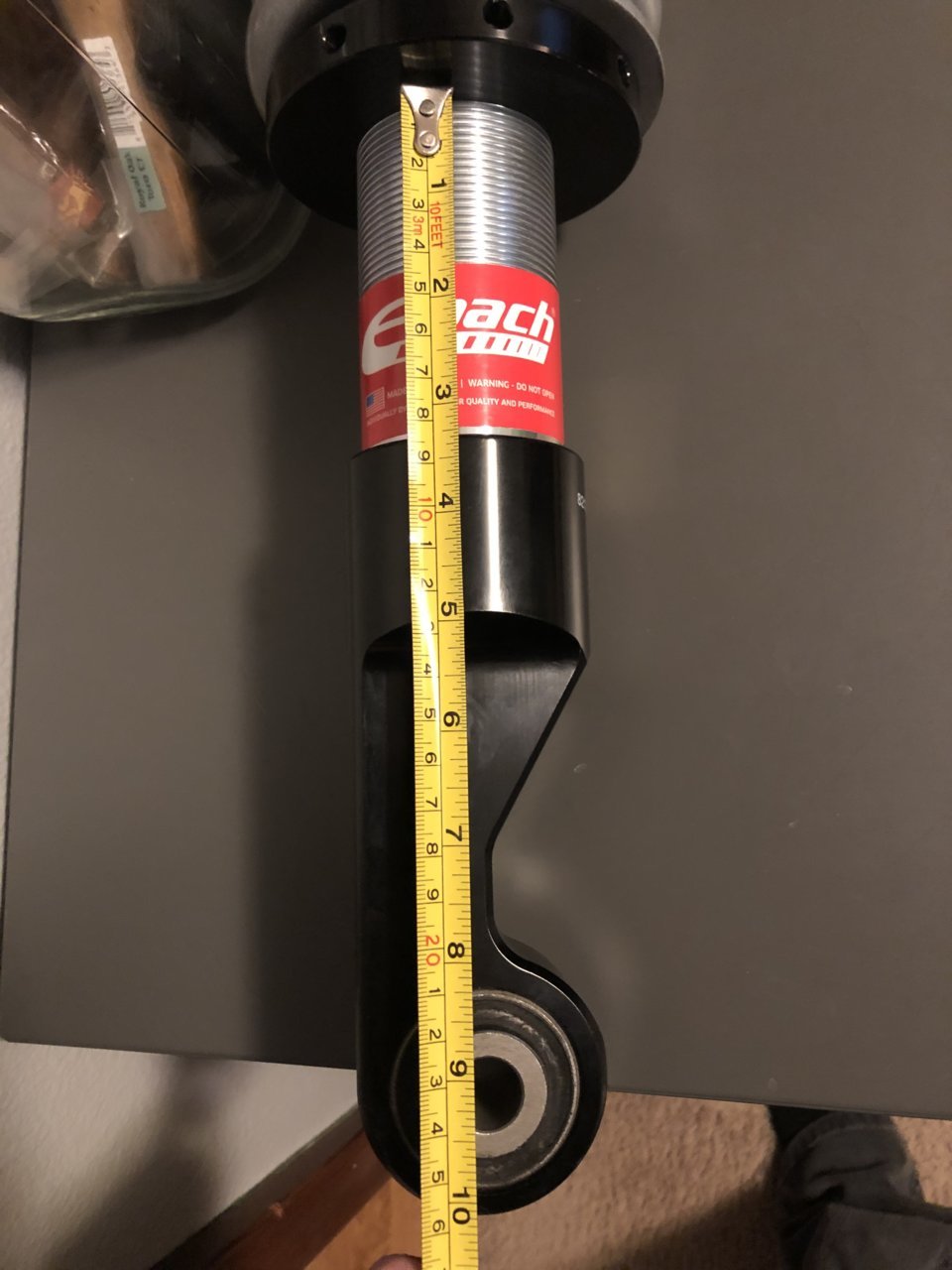

    Getting my Eibach 2.0 coilovers installed today. Mine measure at 3 3/8 preset on exposed threads. Hopefully will work out good with my +3 Coachbuilder shackles.

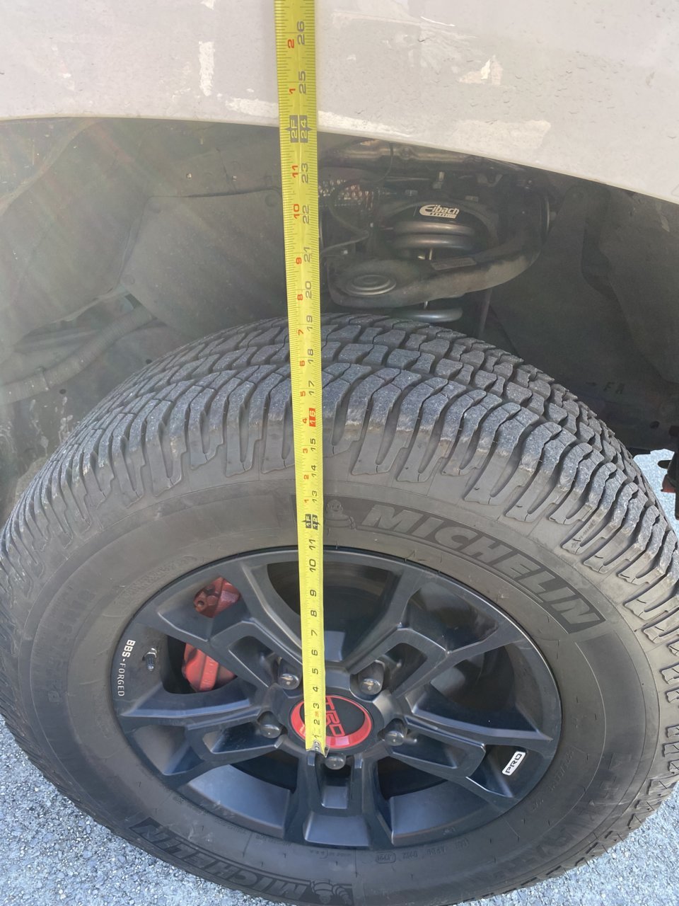

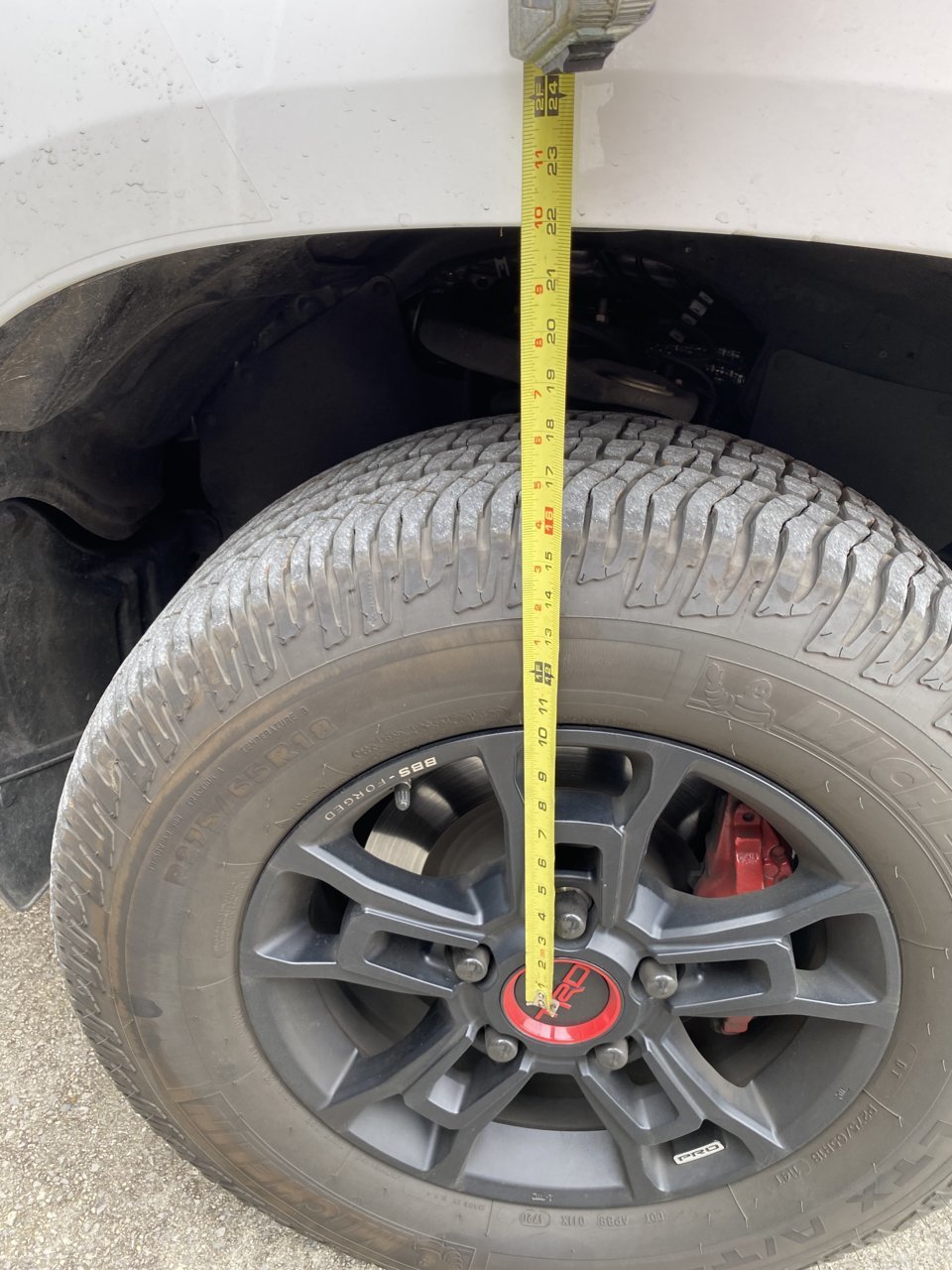

    Got some photos of truck on both sides after the install. Two inches of lift on both sides in the front. Coilovers were adjusted to compensate for the Tundra lean. I can’t even explain how smooth these ride. Well worth the money.
    Before:
    390F92FC-152F-4A64-8BAF-D8273519B004.jpgAfter:
    AF53547C-E942-4070-BFE2-0666617CCC86.jpg 07BBE59A-CCE0-4A92-B4C3-6101195889DF.jpg E7B05223-DC4B-49D5-91CE-DCC143C15DC0.jpg AEAE05C2-75D5-4778-9F77-1832338C9BFB.jpg
