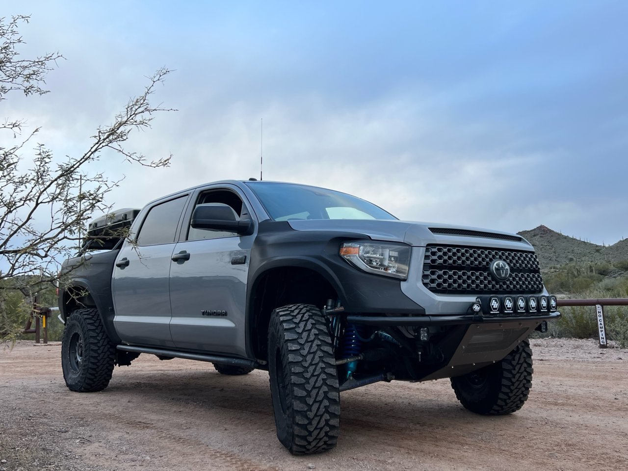

  12. Jul 26, 2023 at 12:05 AM
    #42
    BamBam2020Tundra
    BamBam2020Tundra [OP] New Member
    Jul 13, 2023
    #100192
    80
    Bam
    2020 Tundra TSS 4x4
    Stock
    Bad ass rig brother, love the look. I'm definitely digging the vibe of your truck.
    So any issues with the 17s and the huge break calipers on these '14 to '21 tundras. I want 17s for the added side wall and overall more rubber, but I feel it might be an issue when things are vibrating up and down these nasty lease roads I drive on out in the patch
    And what did you have to do to the wheel wells once you got the glass fenders and bedsides installed? Anything major? If so do you have pictures of what the inside of the wheel-wells look like post install? Fyi I really want the same methods rims you got in a 17" but a different color.
  13. Jul 26, 2023 at 6:11 AM
    #43
    Slag_Dynamics
    Slag_Dynamics Cut. Weld. Repeat.
    Nov 17, 2022
    #86871
    312
    Arizona
    Gone
    I’ve had No issues with the 17’s.
    The fenders and bedsides definitely take some work and there is no going back.
    You’re going to remove the old fenders and liners, fit, cut and drill out the mounting locations in the fiberglass fenders, body work them, body work them again and then paint. The fiberglass is going to be less than perfect and need work, at least in my experience. I also cut my pinch weld, ground it flush, and did an aggressive cab mount chop.
    The bedsides, I drilled out all the spot welds on the factory bedsides, then carefully cut about 1/4” down from the top of the bedside along the entire top rail and removed them. I then fit the fiberglass bedsides about 20 times to make sure everything lined up, removing small amounts of material along the way until they were flush with the top bed rail etc.
    Then I welded up stiffeners that mount to the bed and to the fiberglass bedside with fender washers to keep it clean. I tried to use inconspicuous locations that still added rigidity to the bedsides. You’ll also body work the fiberglass bedsides a million times, and then paint.
    I did all of this myself in my garage (aside from paint) but I cannot imagine what the labor cost alone to fit glass start to finish is at a shop. There were several times I questioned my own sanity during this process.

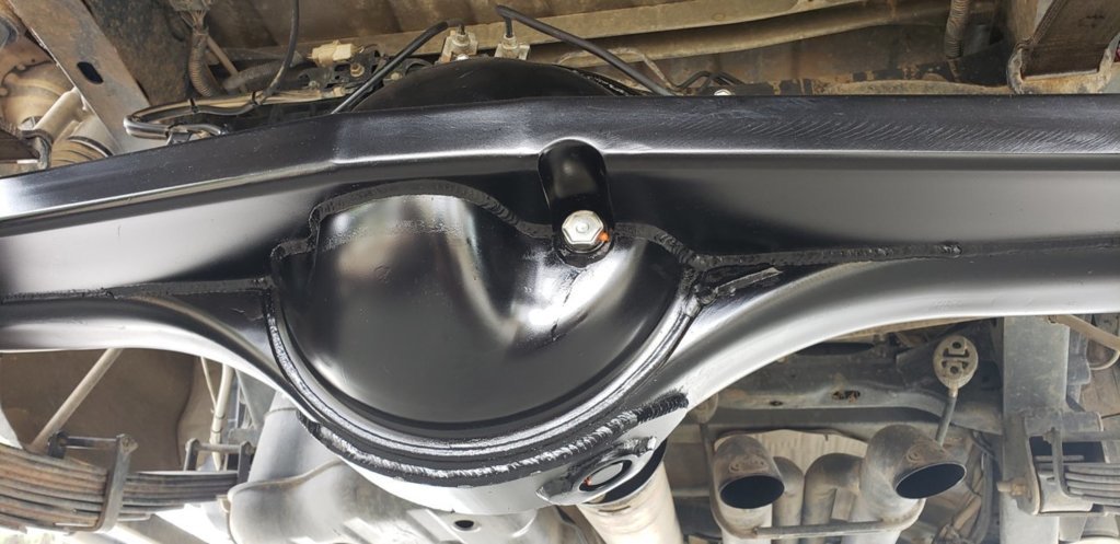

  20. Jul 26, 2023 at 8:02 AM
    #50
    reywcms
    reywcms New Member
    Dec 20, 2021
    #72040
    7,648
    Rey
    North Plains,Oregon
    2017 Tundra Platnium
    Too many mods to come
    The ford truss kit from Artec can be modified to fit the tundra. We did this on a buddies rig just an fyi.
  21. Jul 26, 2023 at 8:12 AM
    #51
    Slag_Dynamics
    Nov 17, 2022
    #86871
    312
    Arizona
    Gone
    Do you remember which kit?

  22. Jul 26, 2023 at 8:22 AM
    #52
    reywcms
    reywcms New Member
    Dec 20, 2021
    #72040
    7,648
    Rey
    North Plains,Oregon
  23. Jul 26, 2023 at 8:27 AM
    #53
    Slag_Dynamics
    Nov 17, 2022
    #86871
    312
    Arizona
    Gone
    Oh nice! I like that. Not too pricey either and probably cuts out some of the guess work.
