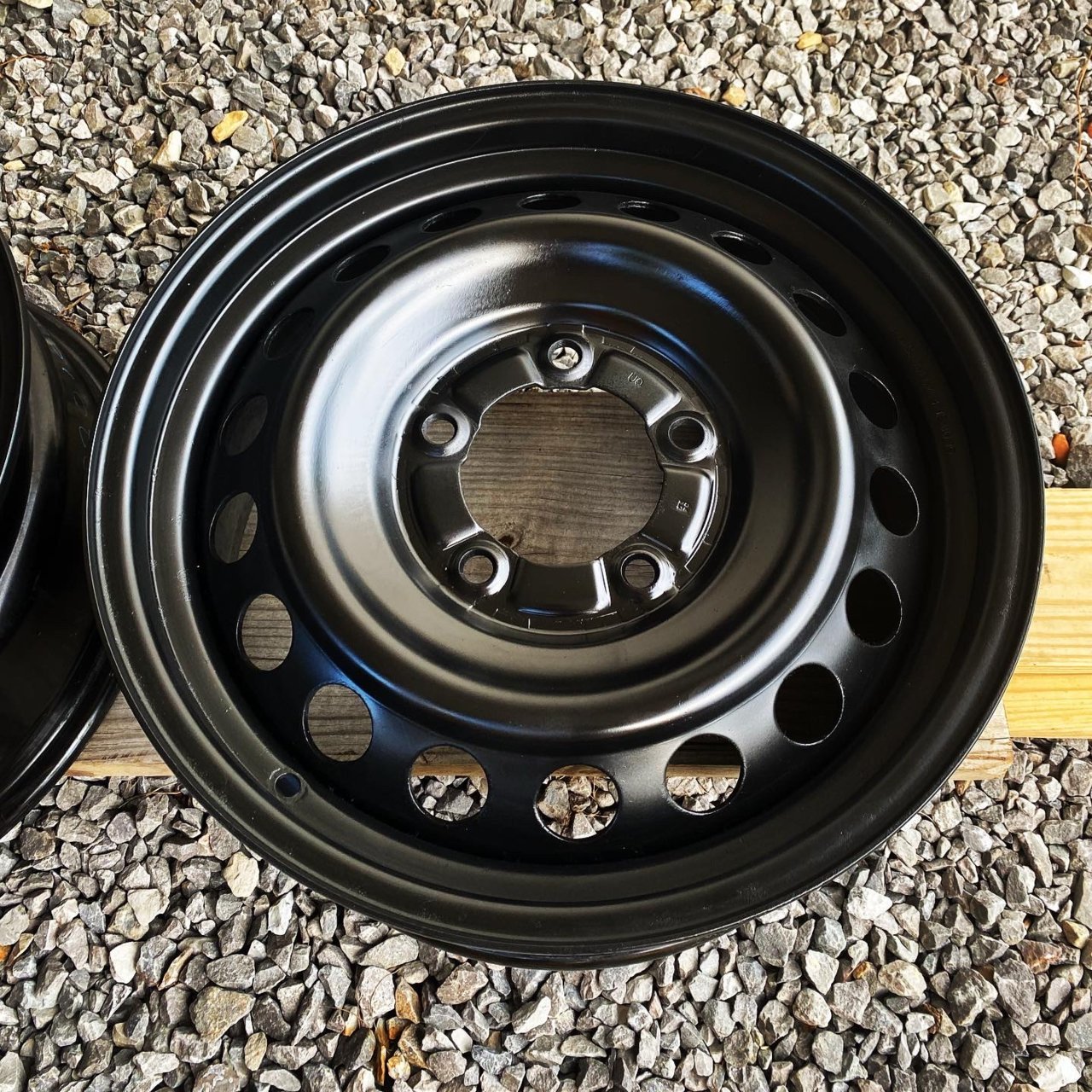

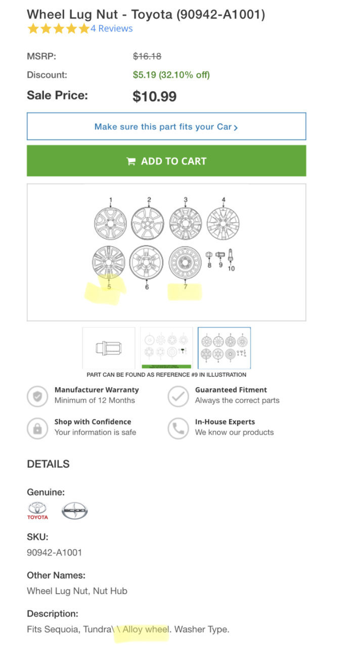

    I’m not sure what the difference or discrepancy is on the 90942 vs 90942-A is, but according to this the A is the same lug nut as OEM and shows it working on steel or alloy. Wheel 5 in the diagram is my OEM 20” Platinum and 7 is my steel wheel.
    Also common sense tells me that if the spare is designed to go on the ground using the same lug nuts, then they are good to go. Notice the lug hole in my wheels below. Same conical design as alloy wheels.

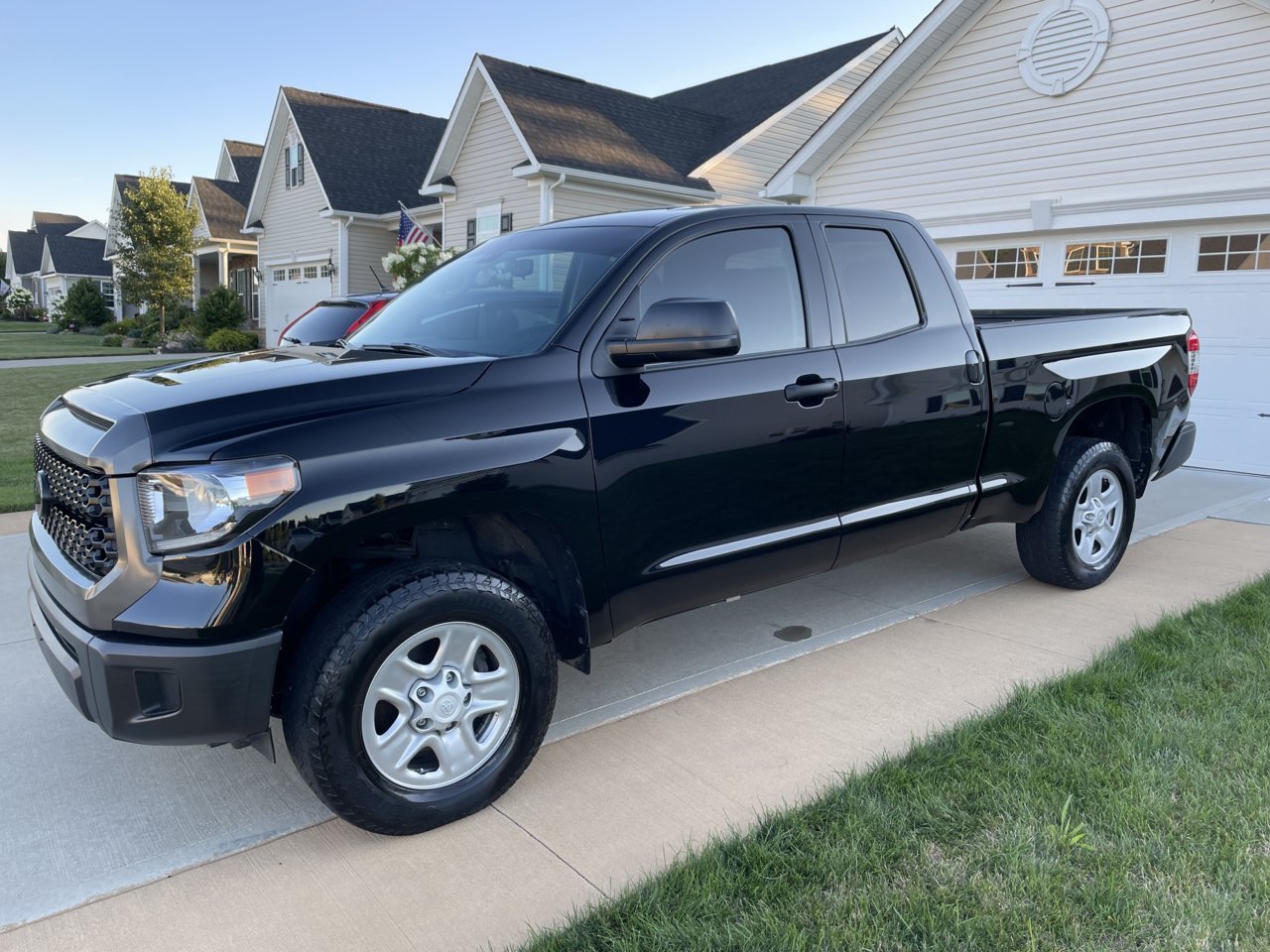

    Here’s my SR with the factory steel wheels. I’d like to upgrade to the 18” factory aluminum wheels eventually. I think the wheels look good since my truck is a base model and all blacked out, my only issue is they are rusting and I can’t stand that.
