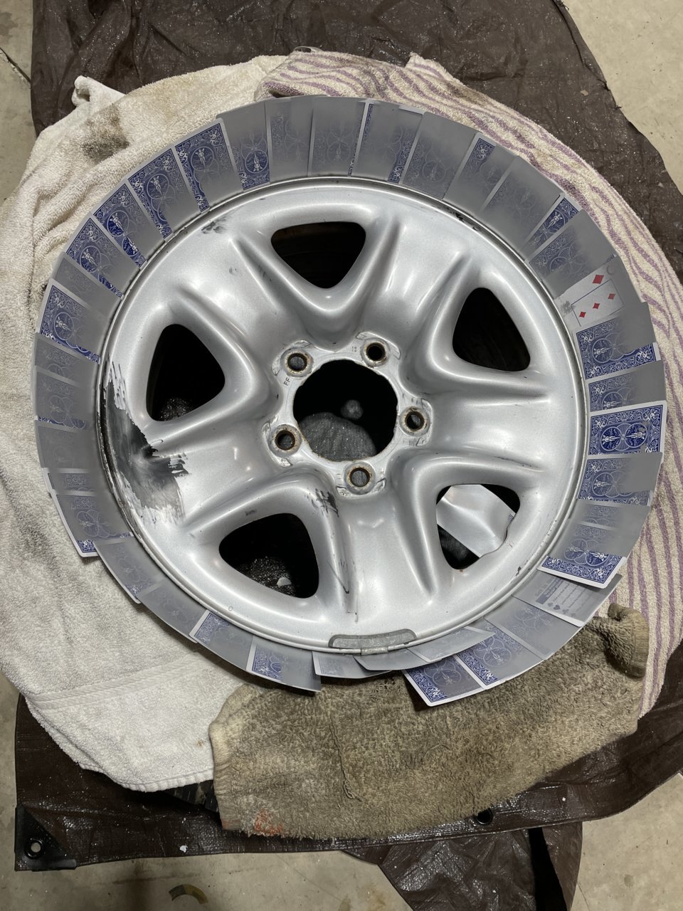

    Alright, I’m finally getting around to painting them with a rattlecan. Lol
    I’ll post it after I’m done… hopefully by Friday. The first two look ok, at least until they get mounted and salt hits them at which point, I’m not sure the spray can will be a good idea. I’d rather have the tires come off and have them properly powder coated, but I’m trying to retire and save money…

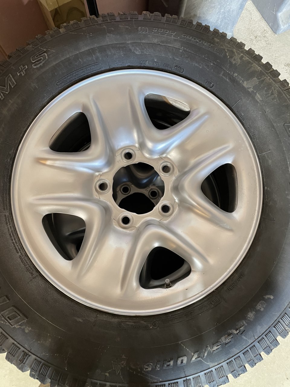

    Heres’s the pics… before, during and after the rattle can job….

    Here’s something I noticed: 1 of the old wheels had some of the original silver paint flaking off. Under it was what looked like a matte black treatment. If I could have found a way to get all of the original paint offf without damaging it, that might have been really cool. I tried though.. the stuff that was flaking came off easy, but the rest was adhered really well.

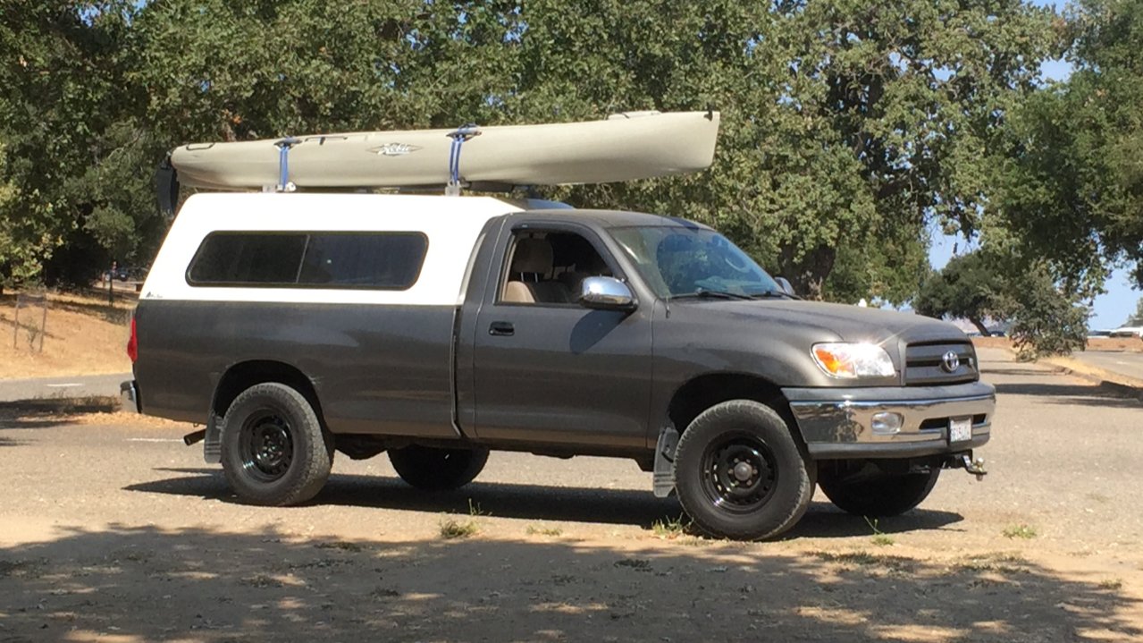

    I couldn't agree more! The steel wheels are where it's at. :cheers:

    Aircraft stripper . Just make sure it doesnt touch anything you dont want to permenantly remove everything from because it will lol

    Y’a know, I worried too much. The rattle can job looked just fine and it held up all winter. Just took them off a couple weeks ago and did an inspection… nothing flaking off or anything… still looked like I had just sprayed it.

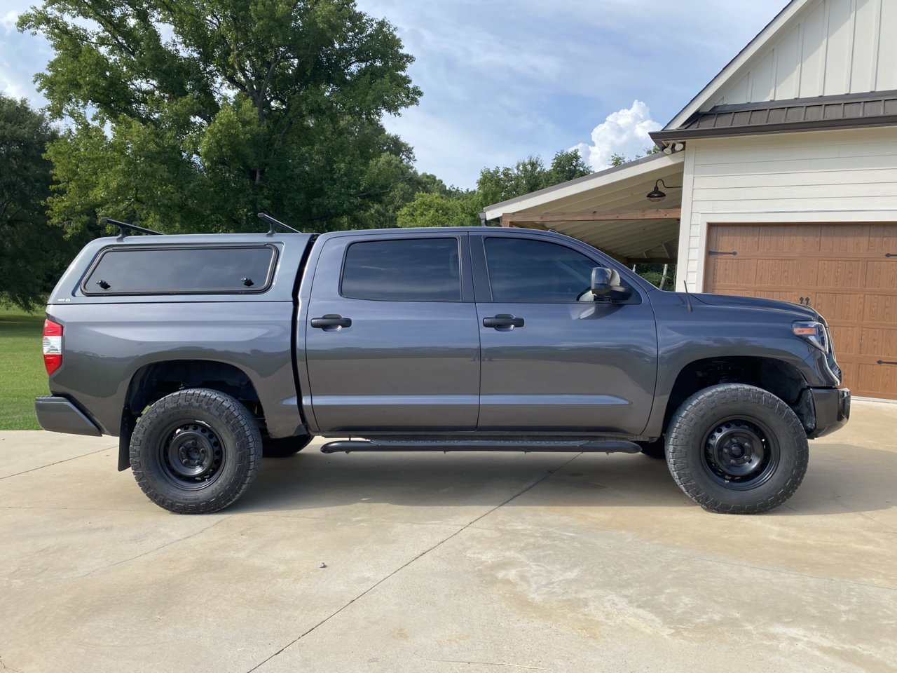

    This is the only applicable thread I could find on the forum when researching using steel wheels on my build, so I figured I’d update it with my truck.

    this really makes me want to swap my rims for these when I am due for tires.

    Side note… I do not see any tire weights? Was the tire shop able to add them else where rather then clamped on the lip?
    also how is the maintenance? Simply pull the wheel and respray it black?

    Thanks! The look isn’t for everyone, but I’m really digging it for now.

    The fronts only needed them on the inner lips. If you look closely the rears have them on the outer, but can’t remember if inner too. All in all they balanced really well with the Coopers.
    I spot hand sanded, used Dremel on really tough spots, and then scotch bright. Next I pressure washed really well, then used Krylon Satin spray paint to apply several good coats letting dry throughly between each coat.

    Nice? Can you post some more photos, including a regular, non-artistic pic from the side? Thanks.

    Those look great. What size are the tires?

    Thank you. They are 285/75R18 Cooper AT3 XLT

    If I didn’t buy SCS ray10 this is what I wanted. Looks great.

    i have this size tire. And on the stock size rim/offset I admired with @MSU Tundra they look perfect
