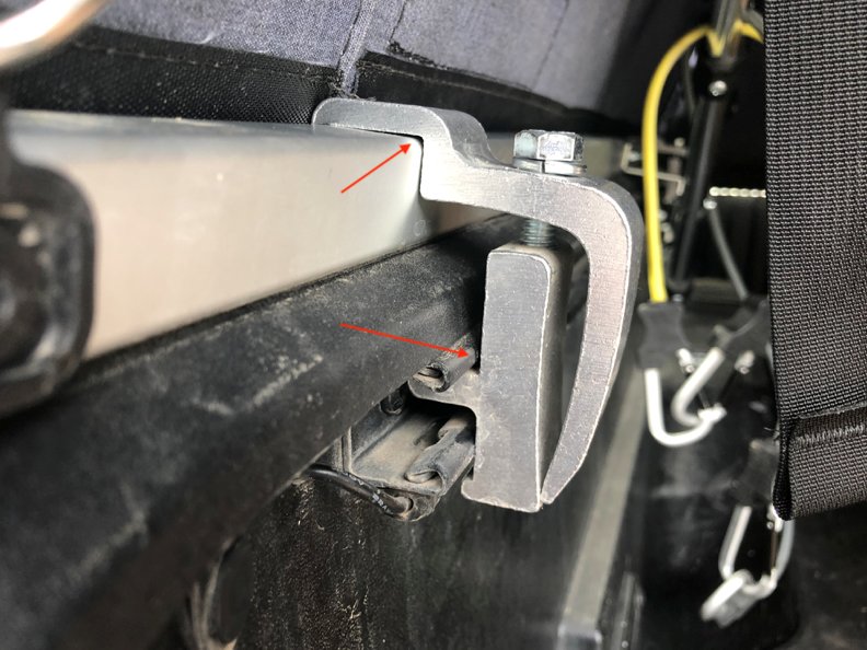

    @Softopper , can you address post #394? Is it normal for the bed rails to slightly lean inwards? I’m thinking of placing an order but would like to understand proper fitment. Thank you.

    @dadtrucklife Absolutely! It is ok to have a slight tilt to your bedrails. This happens sometimes with the utility tracks. It is important to make sure that the clamp is nesting on the flange correctly. The foot of the clamp should be nesting flush against the truck. If you have trouble with this, loosen the bolts on the clamps and place the clamp as it should be flush with the truck, then tighten them back up. Ensure the bedrails are inward enough. There should be NO gap at all between the clamp and the truck bedrail. If you do this and still have any gap at all, please loosen the bolt again and start with the top gap by pushing down on the clamp to close that small gap. Then while keeping that in place, push the clamp inward where the arrow is pointing to close the bottom gap as shown in the attached picture. upload_2025-4-3_8-13-49.png
    Also, the weather stripping should be compressed down and the clamps should be tight, but not so tight that they cause the bolt to strip.
    Most beds have a slight taper to them, so let the bedrail sit where the clamp wants to position it. Take the clamp apart, install the bottom portion into the utility track, and snap the top portion onto the bedrail and let the clamps determine the final placement.
    If you try the above steps and you still have tilting of the bedrails, we recommend allowing your Softopper canopy to stretch out for about a month. This will relax the fabric and decrease the tension on those bedrails.
    We hope this helps, if you have any other questions, please let us know!
    AZBoatHauler and koditten like this.

    Lol. Mine have been tilted for 10 years and 200,000 miles.

    Tilting, in most cases, won't impact the fit or function of the Softopper! Glad to hear that your top has held up for so many miles!
