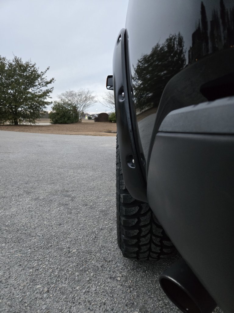

    Sorry guys if this have been answered million time but looking for quick assurance here as well. Bought my truck about 4 yrs ago and it come with some lift that looks like basic 2" nothing fancy just a block that is 2" tall in rear spring and about same tall spacer on front strut. Shocks are stock since I install new takeoffs to replace the original one that were slightly rusty. The wheels are 20" Fuel wheel with 305/50 R20 Terra Grappler. Based on reading through this post and looking the pictures it also looks like the wheels have 0 offset the way they poke out.
    Bottom line I never really like the look of the tire as the side wall seem way to skinny and I rather want more meat. This setup currently have very small rub on the frame driver side, but only under certain condition and full lock. Truck is also equipped with Iron Cross front bumper
    Anyway the time is finally here the tires are done and I was thinking rather than just buy tires to switch the setup completely. I do like the 17" look with taller tire wall and I do like METHOD wheels just not sure what is right for my setup to avoid rubbing.
    Based on this post I have these two on mind but dont know the outcome
    17x8.5 - 0mm Offset on 295/70/17
    - Will this poke more than what I have now?
    - Will this rub?
    17x8.5 +25mm Offset. 285/75/17
    - Will this look too flush since fender flares are installed?
    - Will this rub due to its tall side wall?
    or
    18x9 +18 wheels with 285/65R18
    18x9 +12 wheels with 275/70R18
    Here is few pictures of current setup and would love if anyone can chime in. Thanks

  3. Feb 12, 2025 at 8:31 PM
    #783
    jayhawknavy02
    jayhawknavy02 New Member
    Sep 4, 2020
    #51773
    94
    SOCAL
    2017 Tundra 5.7L SR5 Crew Max TRD Off Road 4x4
    Dirty Deeds 10” exhaust TRD Accelerator OTT Tune Sony XAV-9000ES Head Unit AJT Interior Upgrades
    +25 to +35 is the safest.
    The link I posted above is a great way to validate
    went through similar questions and you may find this helpful
    https://www.tundras.com/threads/gen...stener-first-time-caller.152823/#post-3808845

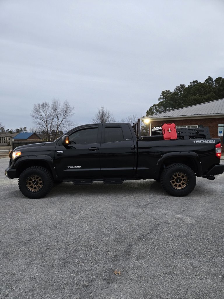

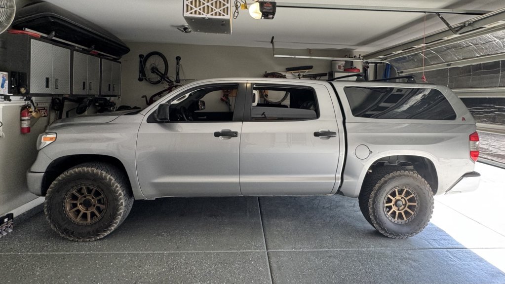

    Finally got new wheels and tires, thought I would share to help others out (and because it’s sexy!)
    Went from TRD OEM Black wheels with +60 offset and 265/70/18 Nitto grapplers to 17” Method Bronze 703’s. New tires are the Falken AT4W’s with 3-ply sidewall.
    Best part is that I was able to go up in tire size and because of the offset on the new wheels the 285/75/17 (34”x11”) Falkens fit on factory suspension, no lift. Guys at the tire shop weren’t sure but based off a bunch of research here I thought the +25 to+35 offset on wheels would be perfect, that really is the sweet spot. These Methods have +36 offset and are JUUUST right, a little poke, no rubbing and should still tuck up in the wheel well on trails when flexing.
    Bigger tires seem to have given me 1.5-2” extra lift per fender measurements from the ground, before and after.
    I’ll be doing a suspension lift as well, leaning towards the Eibach 2R front and back and maybe a RAS on the back too but super pleased!
    AT4-W’s are noticeably better in the snow than my worn down Nittos, no big surprise there.

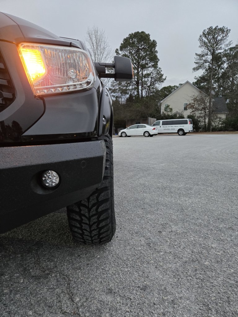

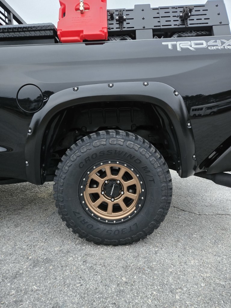

    Wheels are in they look better in person than on the picture , tires will be here today as well must be on different truck. If all goes well I might install them this Saturday.
    17x9 +12
    jayhawknavy02, equin and Gaston like this.

    Looks good! Do you have pictures at different angles? I am thinking of using 285/75/17 tire size also but afraid it might be too skinny. thanks

    Thanks, I'll try to get more pics, had a couple requests already.

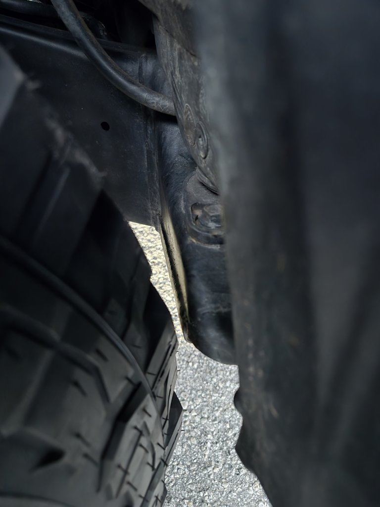

    2014 Black Tundra Limited
    Yep the current wheels 20x10 -18 and 305/50 barely touching the frame (bought this car wit it) + 2" basic lift (spacers). Car also already had aftermarket front bumper so there was never issue really. This is the only rub I have now at full lock so the new setup should fit as well
  22. Feb 18, 2025 at 12:38 PM
    #802
    Gaston
    Gaston New Member
    Jan 7, 2022
    #72748
    620
    Gary
    SE MI
    2021 White Tundra SR5 CM TRD Sport
    Ok, got it, so that is the body mount I was referring to.
    yes still new to all the terms I guess they call it here BMC mode... in my case trying to avoid any chopping, I can do many things but welding is not one of them :( and after I got married and new job got out of the car scene and lost all the contacts that I had...

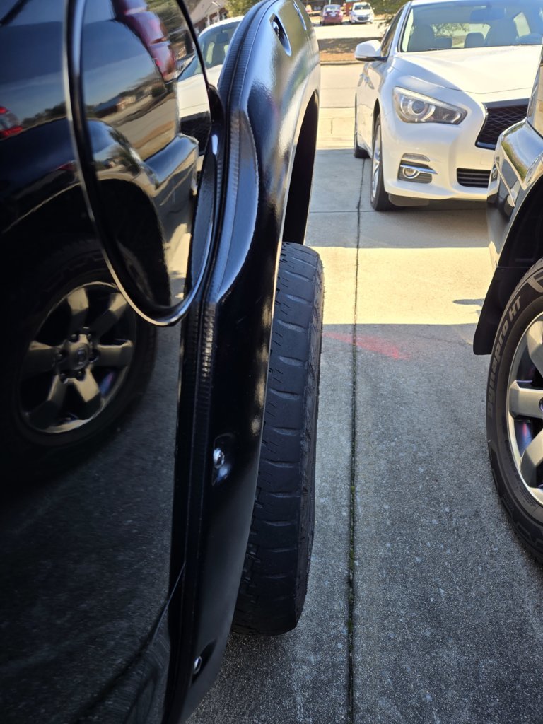

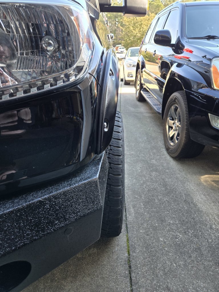

    What a pain in the butt got to my friend shop first we realized the wheels I had on my car had this stupid TPMS senors that look aftermarket so I had to run and buy universal valve stems and had to use bit of superglue as I was not convinced they will stay "click" on the stem as the advertisement said. Going to buy OEM if these will cause me any trouble down the road. Then we had trouble to find right adapter for tire balance machine and lastly aliment rack was not working something about the targets, the rack was not able to find them so I will have to swing by other time once we figured out what was wrong with the rack :-(
    BTW: this is Mercedes dealer they dont have cheap stuff but I guess not prepared for big ass hub bore wheels, Anyway here is the result and I love the look.
    Before
    20x10 -18 Tires 305/50
    Slight Rub on Body Mount at full lock Wheels poking about inch outside of flares.
    After
    17x9 +12 Tires 305/70
    2" Lift, Aftermarket Bumper, Fender Flares
    No rub anywhere and tires are almost even with the flares maybe ever slightly poking out.
