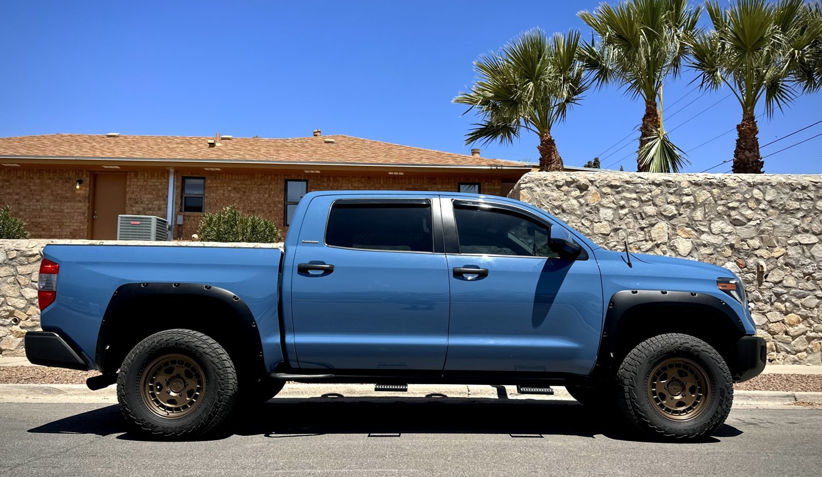

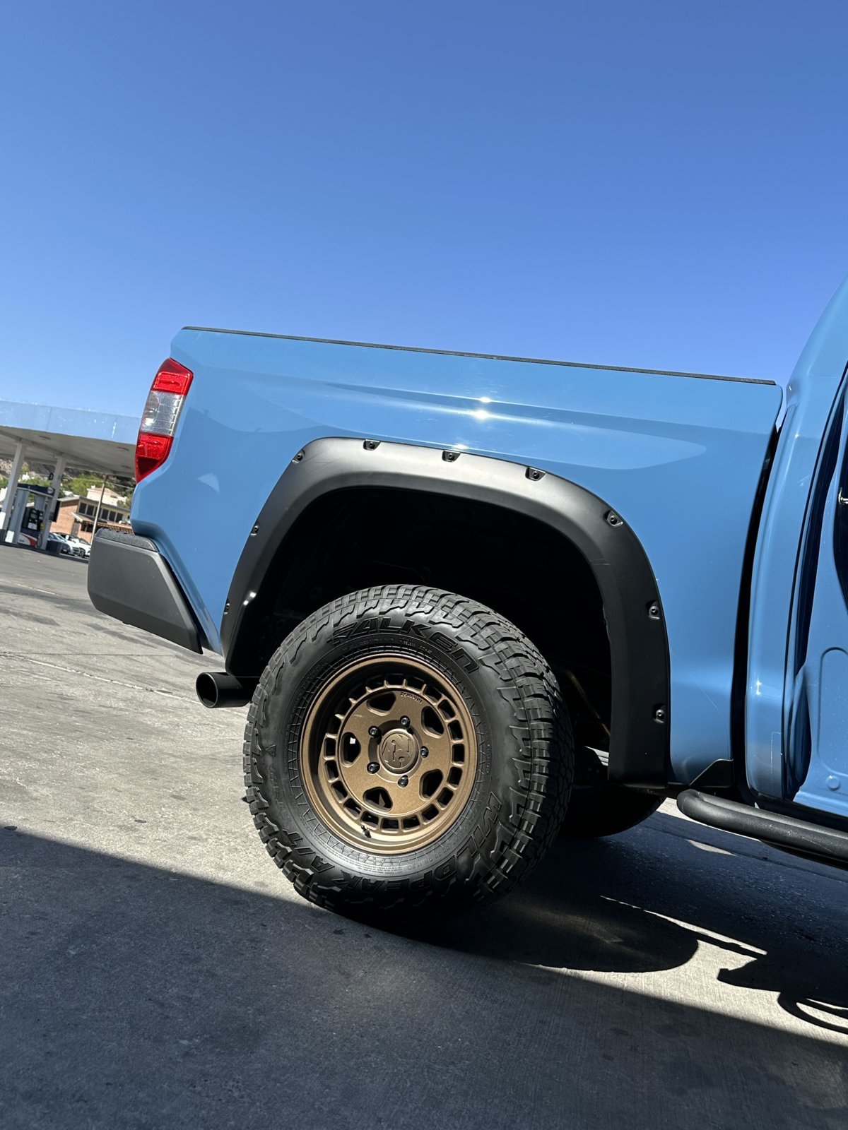

    285s on 17s with bilstien 5100 all around and Toytec shackles. The wheels are bronze fifteen52 turbomac with 0 offset

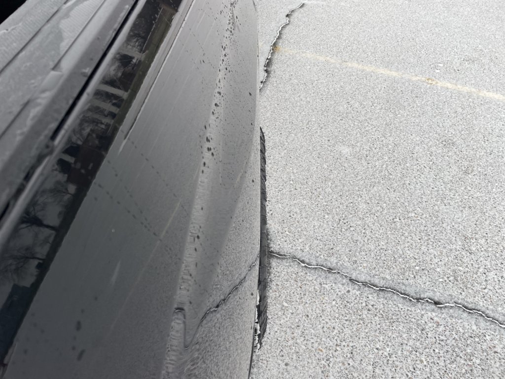

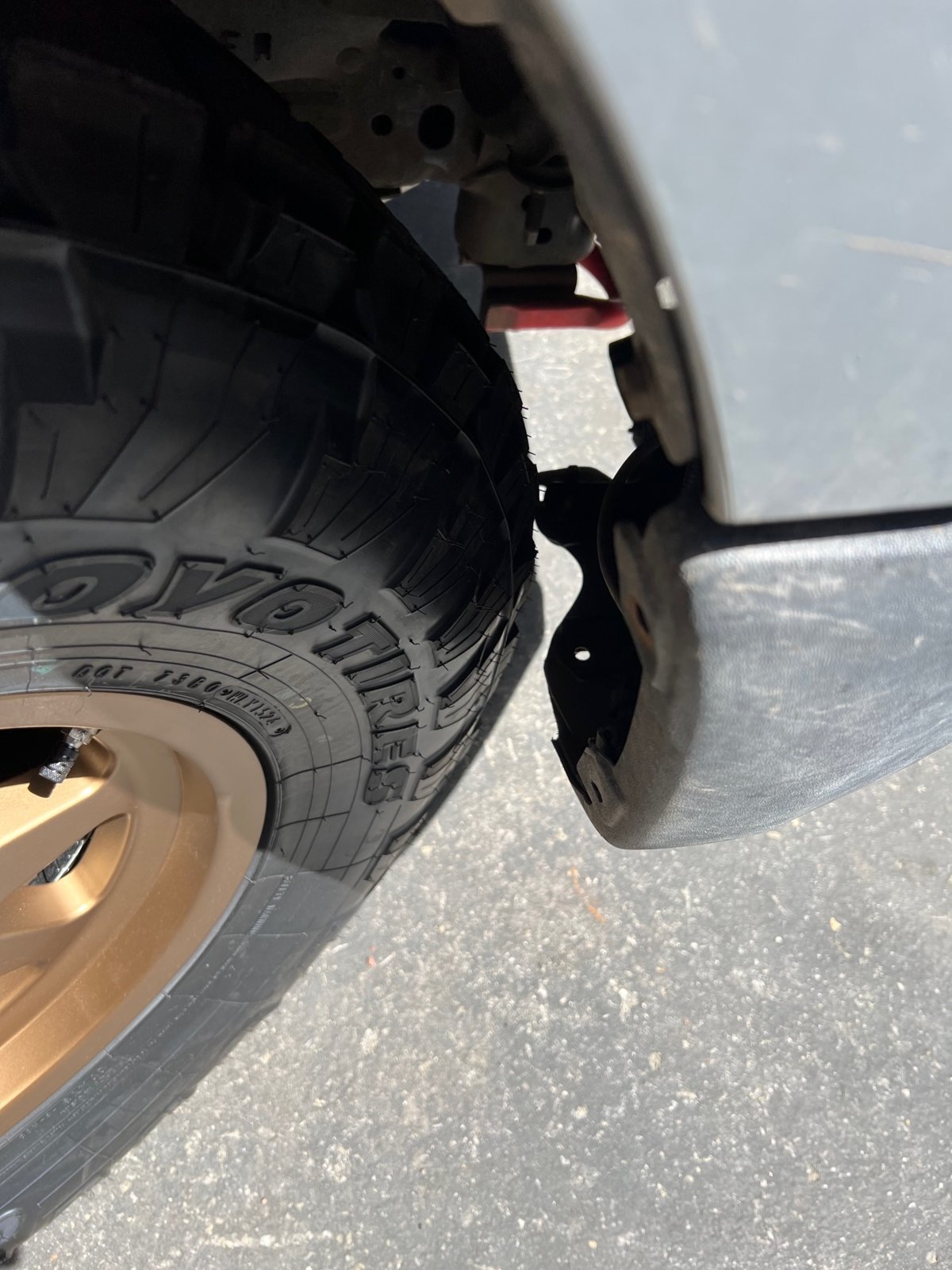

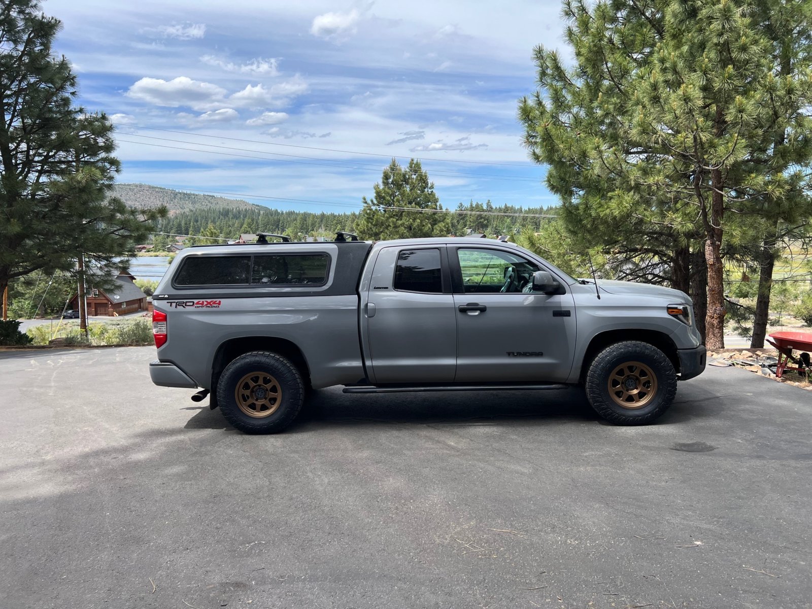

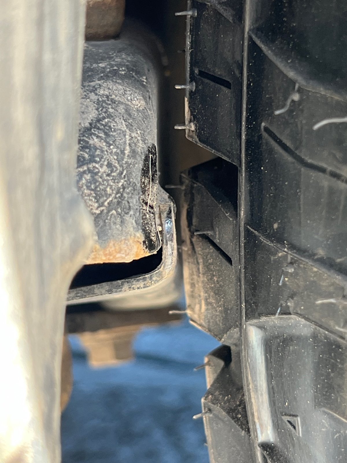

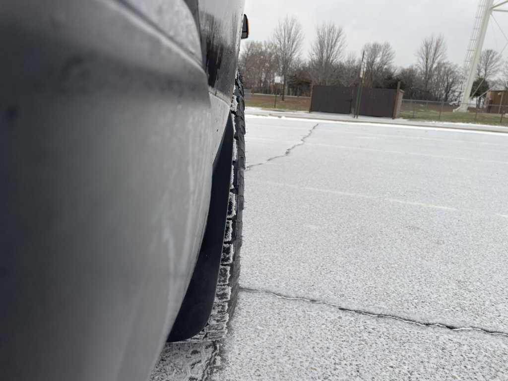

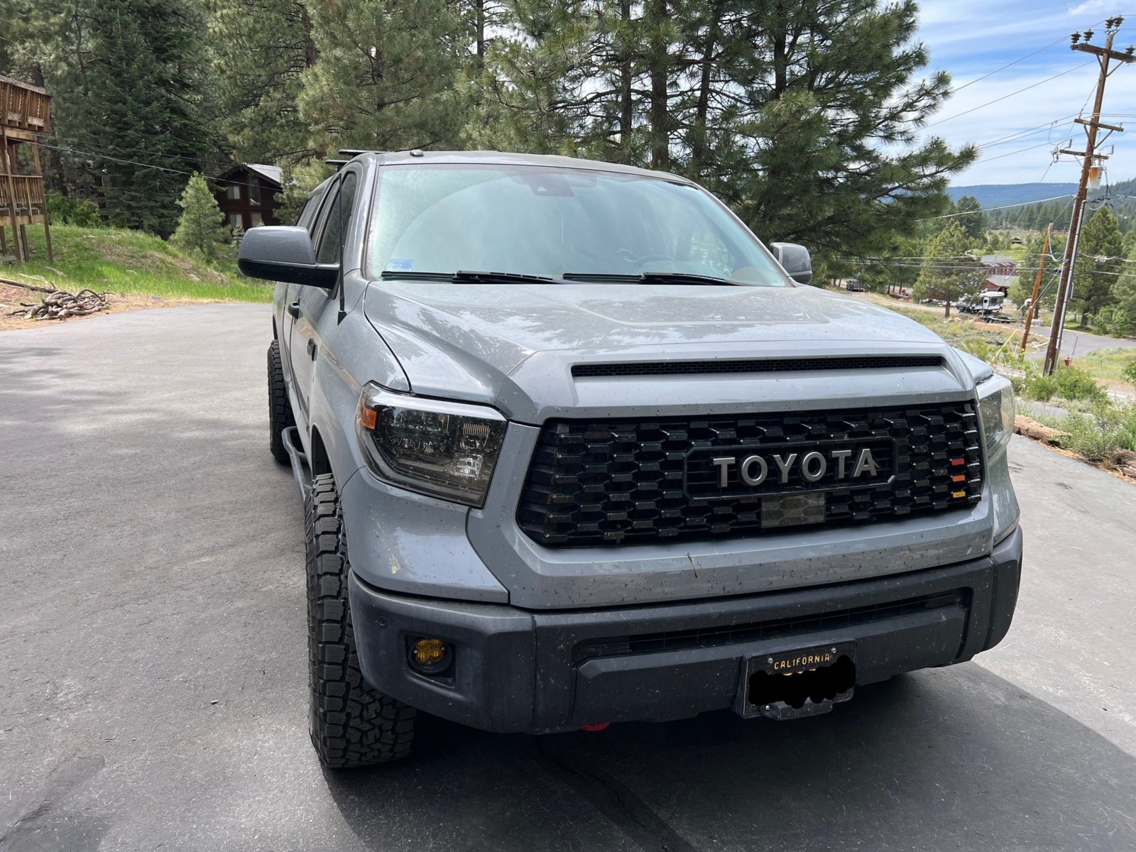

    285/75/R17 Toyo OC AT3s on Method 701. TRD off-road suspension, stock height, no lift.
    it was tight and required removing all the front wheel plastic. really close to needing a BMC, but it's not rubbing.
    just the right amount of poke and fill the wheel wells nicely!

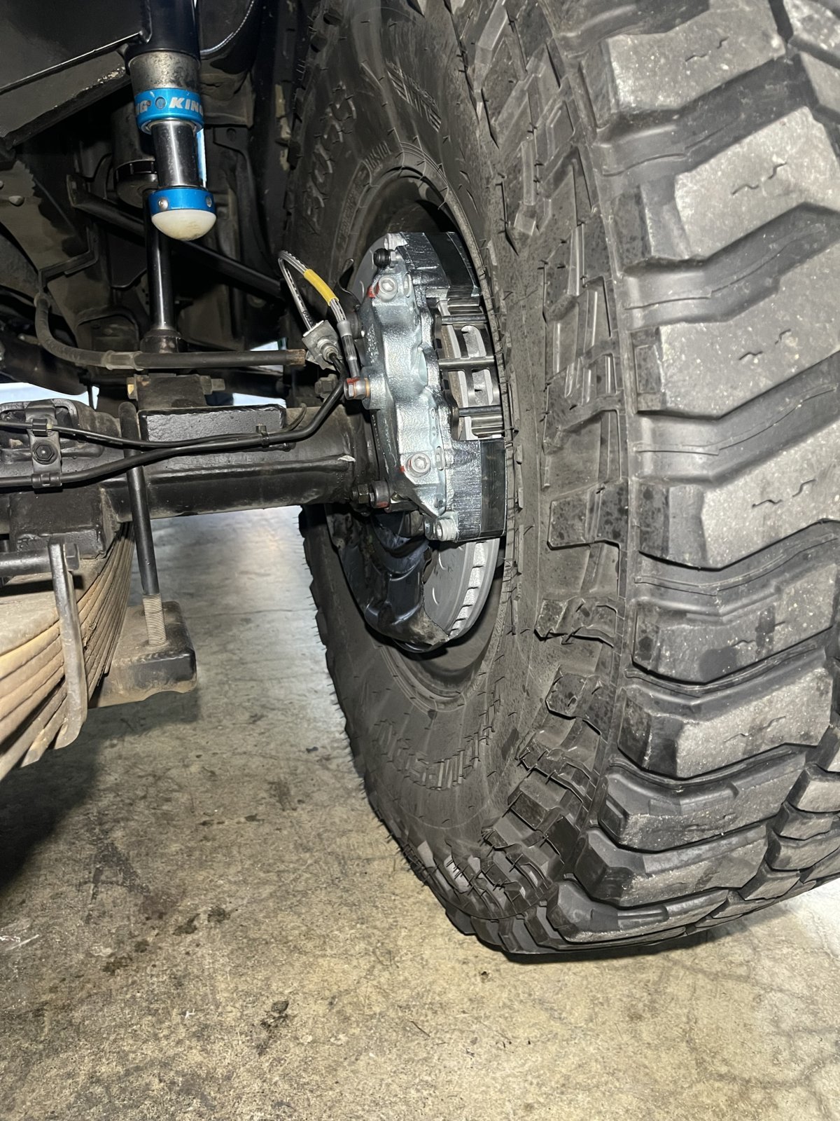

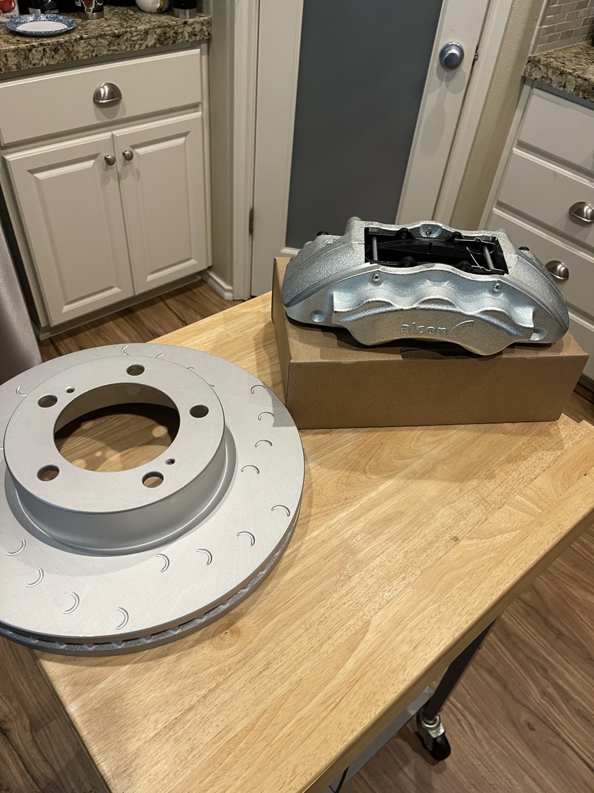

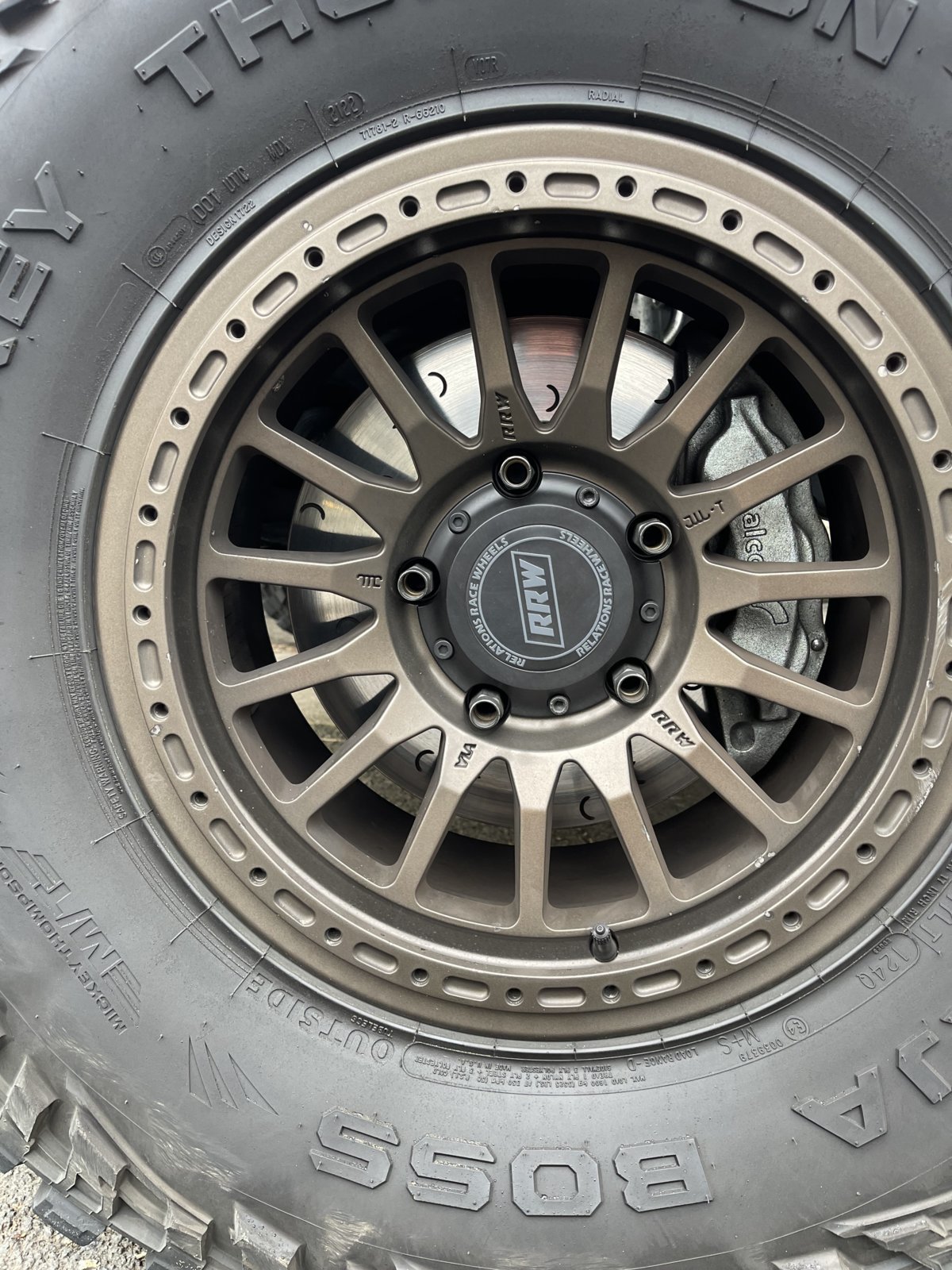

    My kit is the Alcon kit front and rear and it does fit 17s.
    https://alconkits.com/products/toyo...ear-complete-brake-kit?variant=47592848523572

    No comparison. Massive difference in performance. Like sports car stopping power

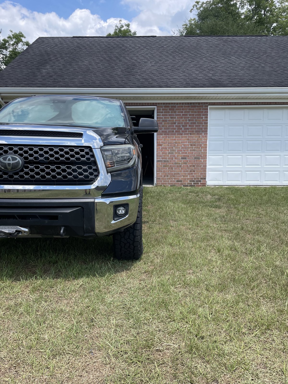

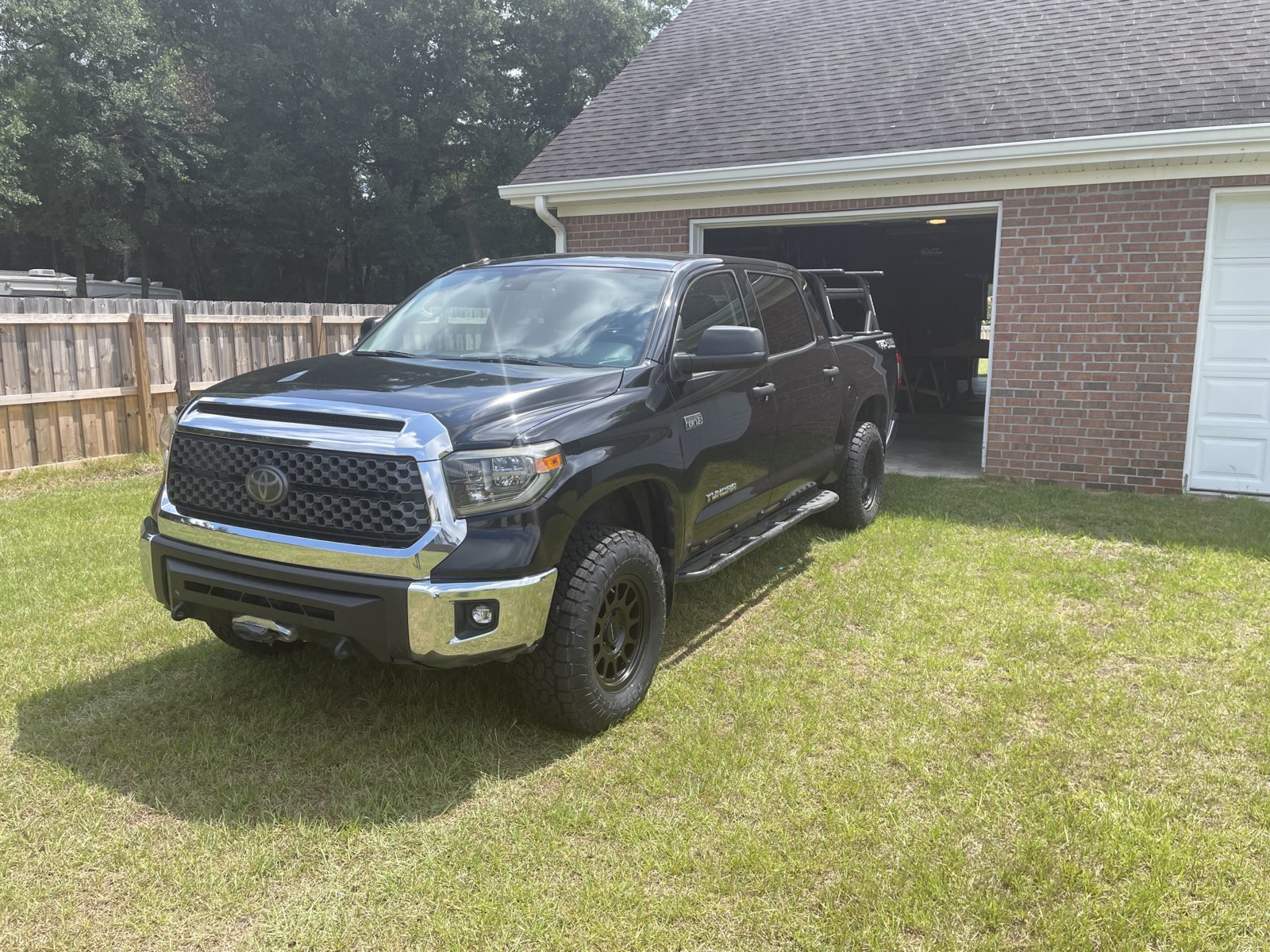

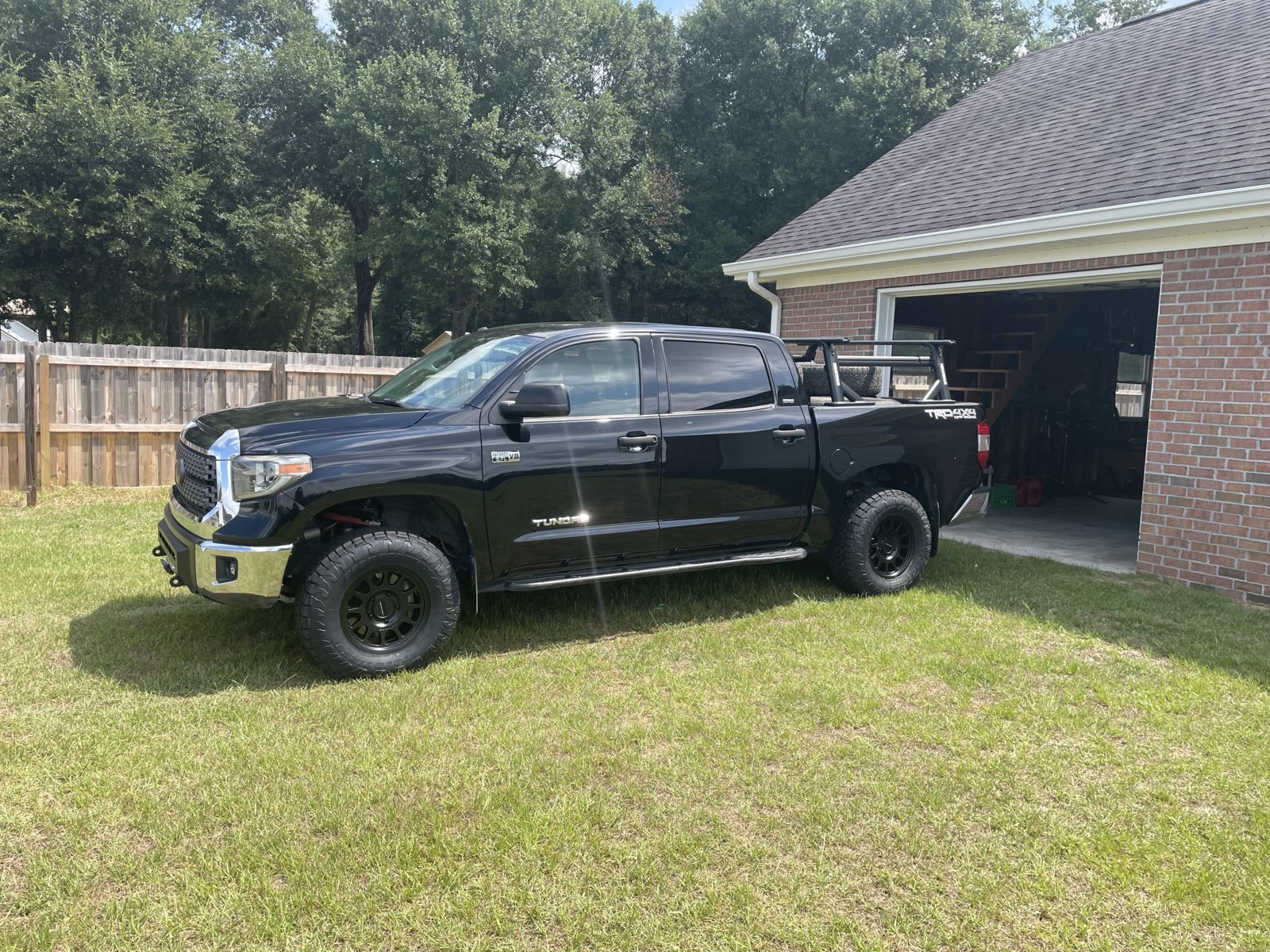

    Method 703 17x8.5 35mm offset. Toyo AT3 285/70. OME BP51 with Dakars. Approx 2.5” lift all around.

    Is the front higher than the rear at 2.5 inches?

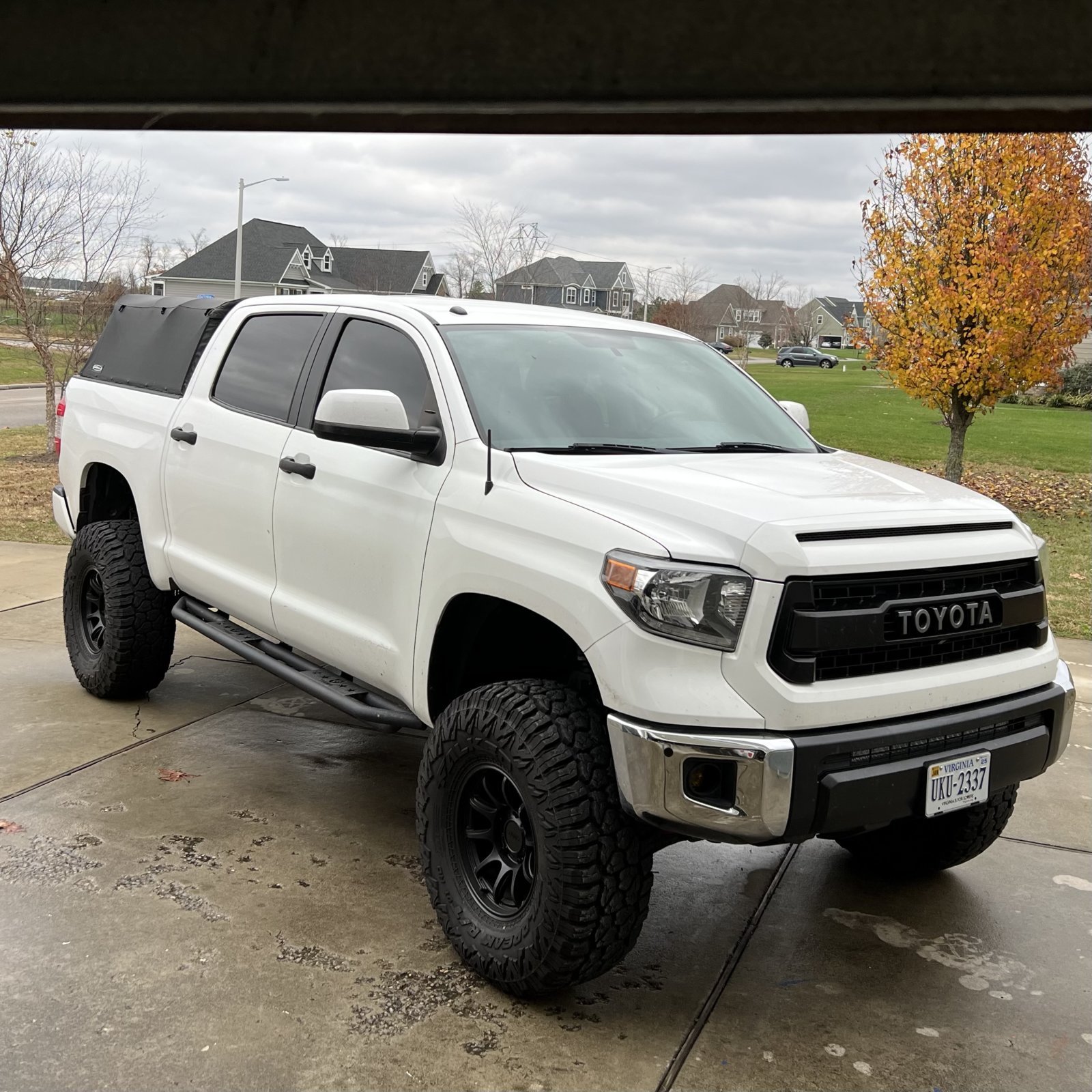

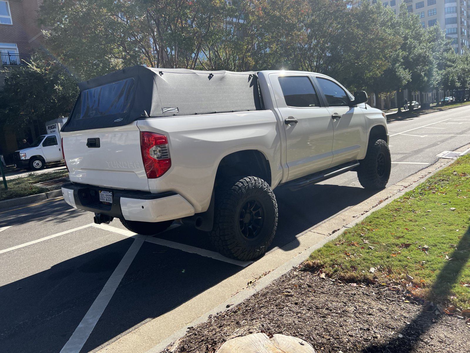

    Need to take new pics but here’s a few

    Whats the offset on your wheels. Are you running spacers?

    0 - No spacers
