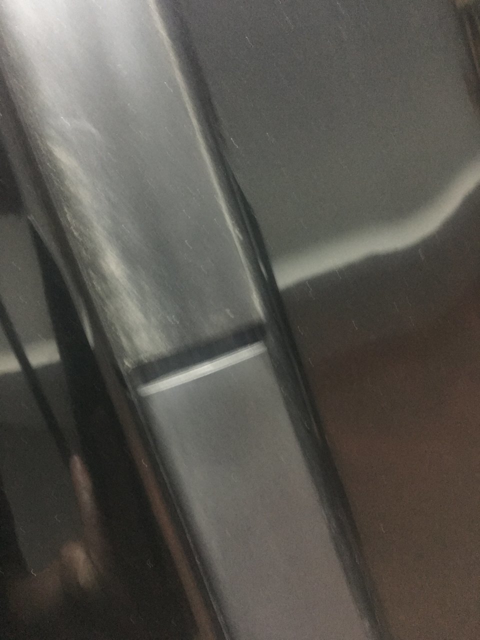

    UGH!! .... I just noticed my passenger side roof top strip is missing as well, who knows when this came off! :annoyed:IMG_3085.jpg

    pretty nice size gap there!
