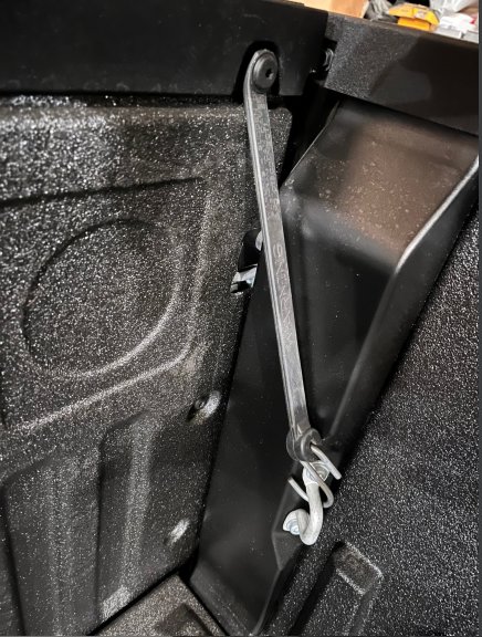

  21. Apr 16, 2024 at 1:14 PM
    #51
    Old_Geezer
    Old_Geezer New Member
    Apr 16, 2024
    #115426
    2
    2024 Tundra Limited Crew Max
    Just used a standard black tarp strap probably 3/4" wide and about 12" long, trimmed to length. I pull fairly tight (will stretch a little over time) to judge the length, trimmed a radius, and drilled a hole. The stock tailgate cover sheet screw worked good to keep in place. After I installed the strap the fob in my pocket accidentally opened the tailgate one morning, and the strapped saved it from hitting my garage sink. The strap only allows the tailgate to open about 1/4". Not fancy, but saved my tailgate!
    Mattedfred likes this.
