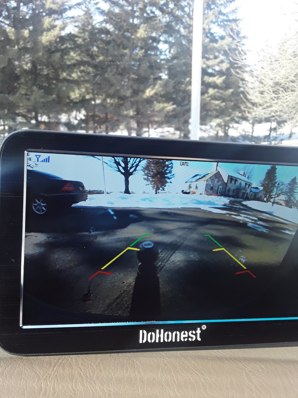

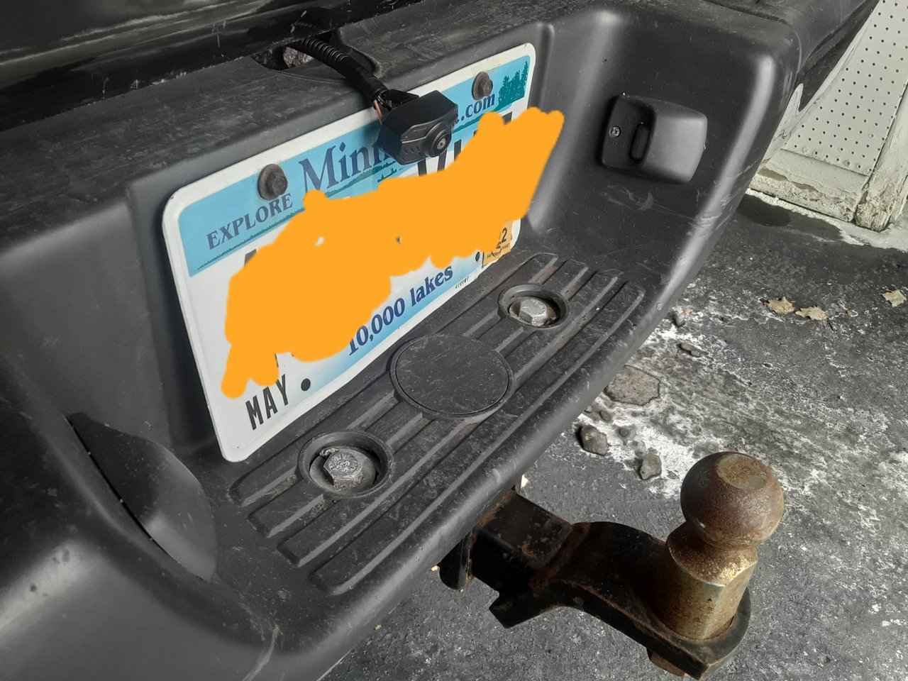

    Picked a wireless one up on Amazon for $100.
