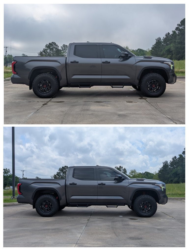

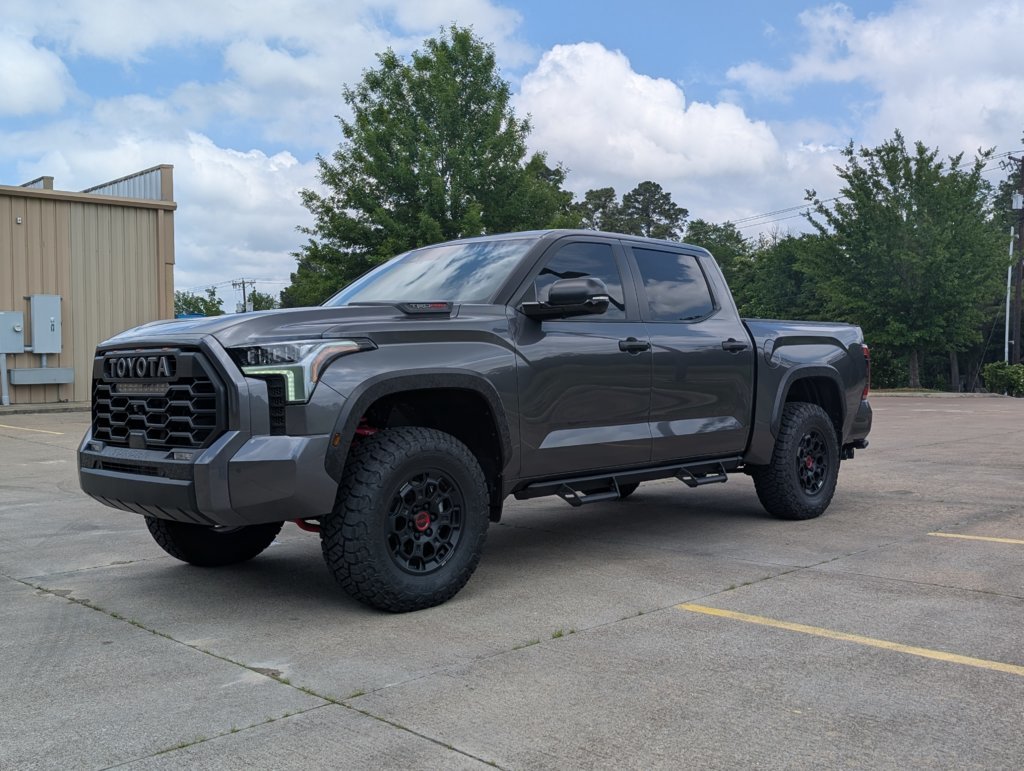

    Done. Before and after. Subtle difference, but it looks better now.

    So nice

    Front is about 1/4" higher than the rear as expected by the tape measure.
    The 2-1/2" springs would have the nose pointed at the sky.

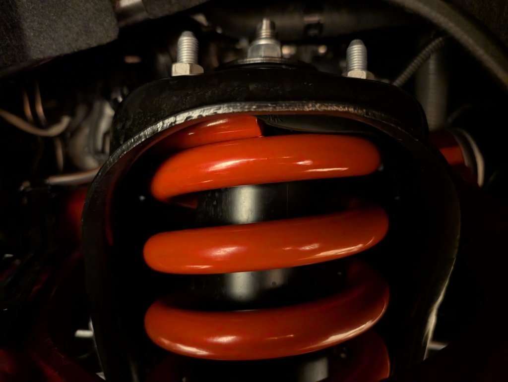

    I just wish he would have turned the struts 180 degrees so this spring end is out of sight inside the coil bucket.

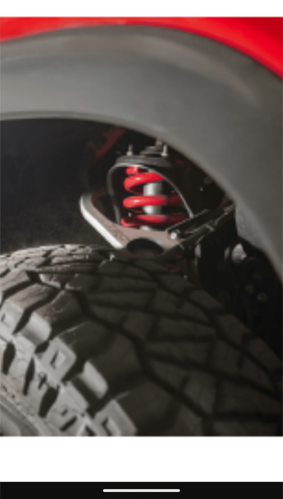

    Found this picture in the advertisement for the 3" lift on Toyota's website. I guess it's normal for the spring end to be facing out like that...I've just never seen it (or noticed it) before.
