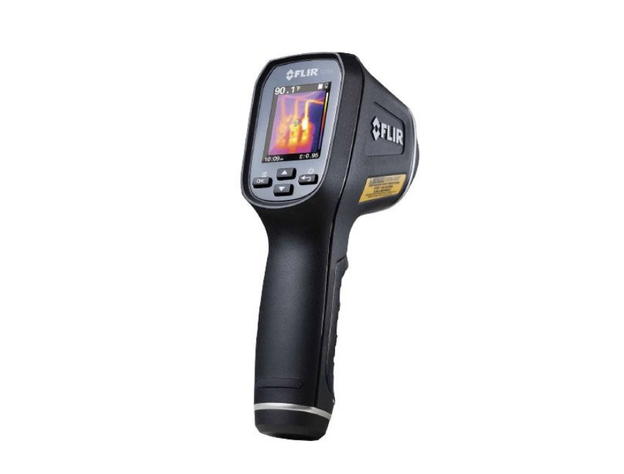

    Do you have a thermal gun that you can point at the seat and get a temperature reading. This will help to explain to the service techs that there really is a problem as most of them just look at you like you have just landed on this planet when you explain the issues! ;)
    This is what I have for my work (sort of pricy) but something that can read heat when you aim it would be very useful.

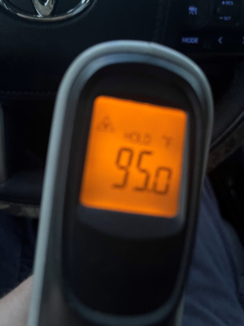

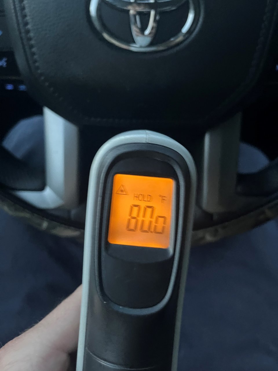

    It happened again on my way to work this morning and I was able to get a temp reading. Ill upload the pictures, though they may be a bit fuzzy. The passenger seat back was reading around 79-80 degrees and the driver seat was reading between 95-96 degrees.

    Wow! Thanks for taking the time to do that and upload it. This will help me out when I take it to the dealer, I wonder what's causing it to engage?
