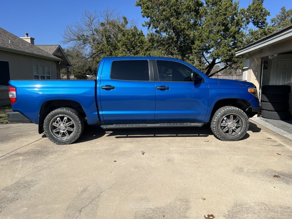

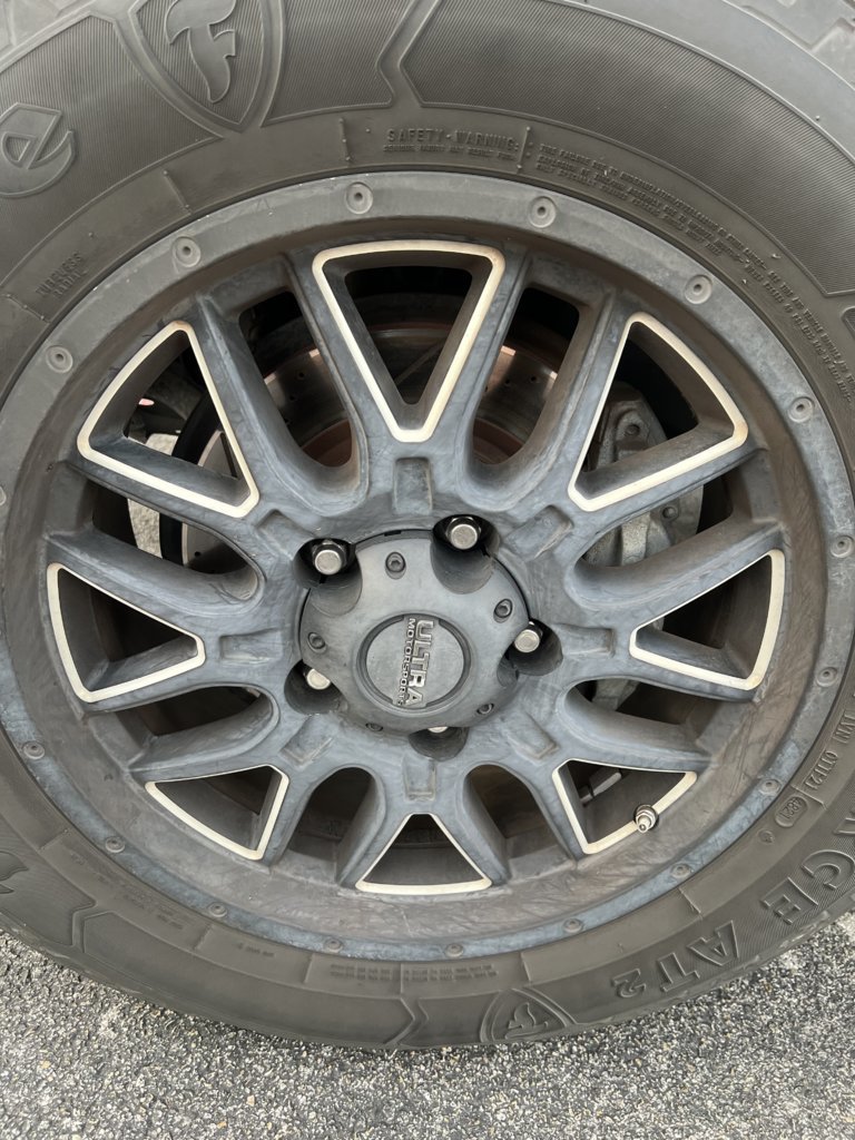

    Ya I picked the wheels up from a lady in burnet off of fb. The tires were given to me from a buddy.
    Here’s what I have now.

    Yeah, the finish on those are bad.

    Finish is bad and I don’t like the style. I like the TRD style.

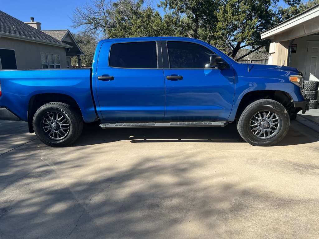

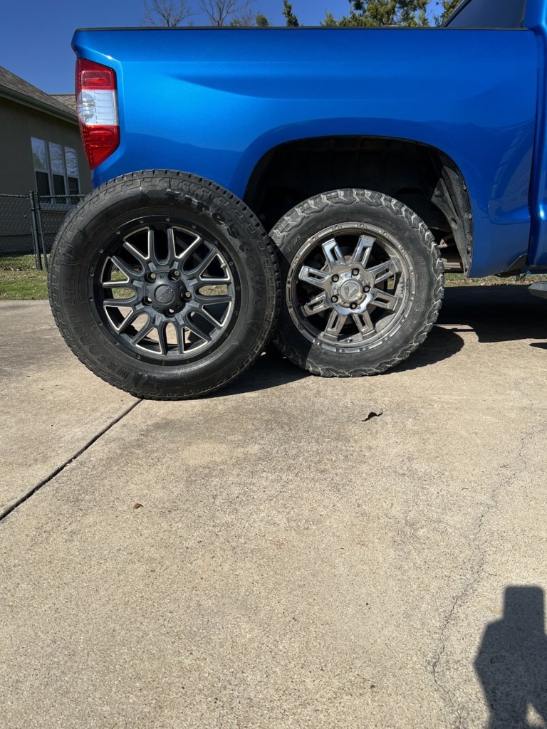

    Slowly working on this. Went to mount the test set and the lug nuts I have are just that much to big to fit in the Toyota wheels. So had to go buy new ones. I’ll get these mounted tomorrow.
    Fun note, the aftermarket wheels with the 34’s weighs 86.5lbs. The factory Toyota wheels with 32’s weighs 88.5lbs.

    Truck dropped right at an inch from ground to fender. Test everything this week and see if there’s any difference in mileage and performance. I’d really like to see how it tows but not sure I’ll get that chance.

    Been a week driving around on the little tires and wheels. Switched back to my regular ones today due to a 6hr road trip and noticed some interesting observations.
    First, mileage around town between the 32’s and 34’s was the same 12.5mpg.
    This is interesting as second observation was engine load dropped 20-25% while accelerating between the 32’s and 34’s. On the 34’s the engine load (which is read by my head unit through the OBD2 so don’t put stock in the exact numbers as much as the difference) is between 70-78% accelerating up to 55mph. With the 32’s it was between 50-57%. Cruising at 55 the difference was between 10-12%.
    Third is the noticeable difference in acceleration. At no point did the engine lug at low rpm while on the 32’s and accelerated easily no matter the speed or gear it was at. I didn’t really notice this difference until I switched back to the 34’s. The exhaust is noticeably louder on the 34’s than the 32’s and I attribute this to engine load being dropped.
    Now my dumbass didn’t even think to do some data logging with HPT so I’ll do that on my trip home on the 34’s and throw the 32’s back on and do some more there.
    I have decided that my next set of tires are going to be a 33”. The 32’s are to small on the truck and I don’t need 34’s for a pavement queen. Plus I can find some 40-42lb 33’s easily which will only help the performance.
