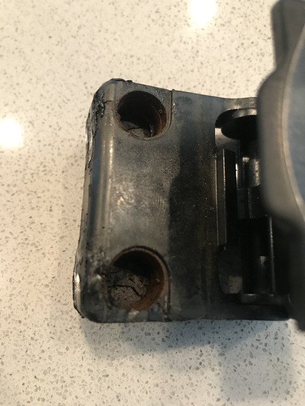

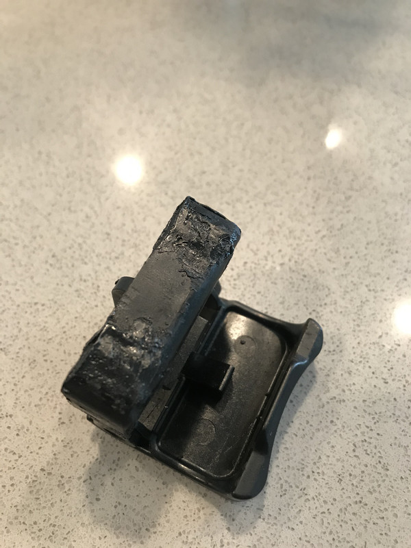

    About 3 years ago the hood catch release handle inside the front grill of my 2002 broke. The plastic piece that holds the release rod broke. I rigged it with some wire to get it working and attempted to get a new handle but was told by the dealer that the part was discontinued. I was also unable to find it online.
    That repair lasted until last week when more of the plastic broke. I repaired it this time with some super glue and a washer but would like to find a better solution. Has anyone else had any problem with their handle breaking? Is there another handle that will work?

    Are you talking about this piece? I know because I’ve looked too and it’s been discontinued and mine broke too lol.
    They are on eBay or junk yard. Mine broke when I removed the grille to replacement because the bushings/nuts were rusted solid to the bolts. After trying to remove them, they began spinning inside the handle. I had to break it off to finally get it removed. To open the hood, simply push the rod that connects to it up toward the hood and it works like normal. I’ll try and make a video tomorrow.

    Yes, that is the piece that I have been repairing. The first time the rod holder part broke I attempted to remove the handle assembly ( hoping to find a new one) but the first bolt broke off when I tried to remove it. The other bolt did not break but did not come out either, it just spins now but does not come out. It's a mess that I keep repairing and I would love a better long term solution. At this point if it breaks beyond repair the only option I know would be to use a wire to pull the latch through the grill but hopefully it never comes to that.

    Took a pic today of the other business end. My clip had broken as well but still remained mostly intact. I Zip Tied that end up tight with the remaining Plastic. Holding nicely 2 years plus. Lube it all nicely.
    Sounds like its best not to try and remove this release handle two bolts without a major back up plan.

    Based on my experience I wouldn't touch the two bolts unless you have no choice. In my case they weren't the problem until I tried to remove the handle.
