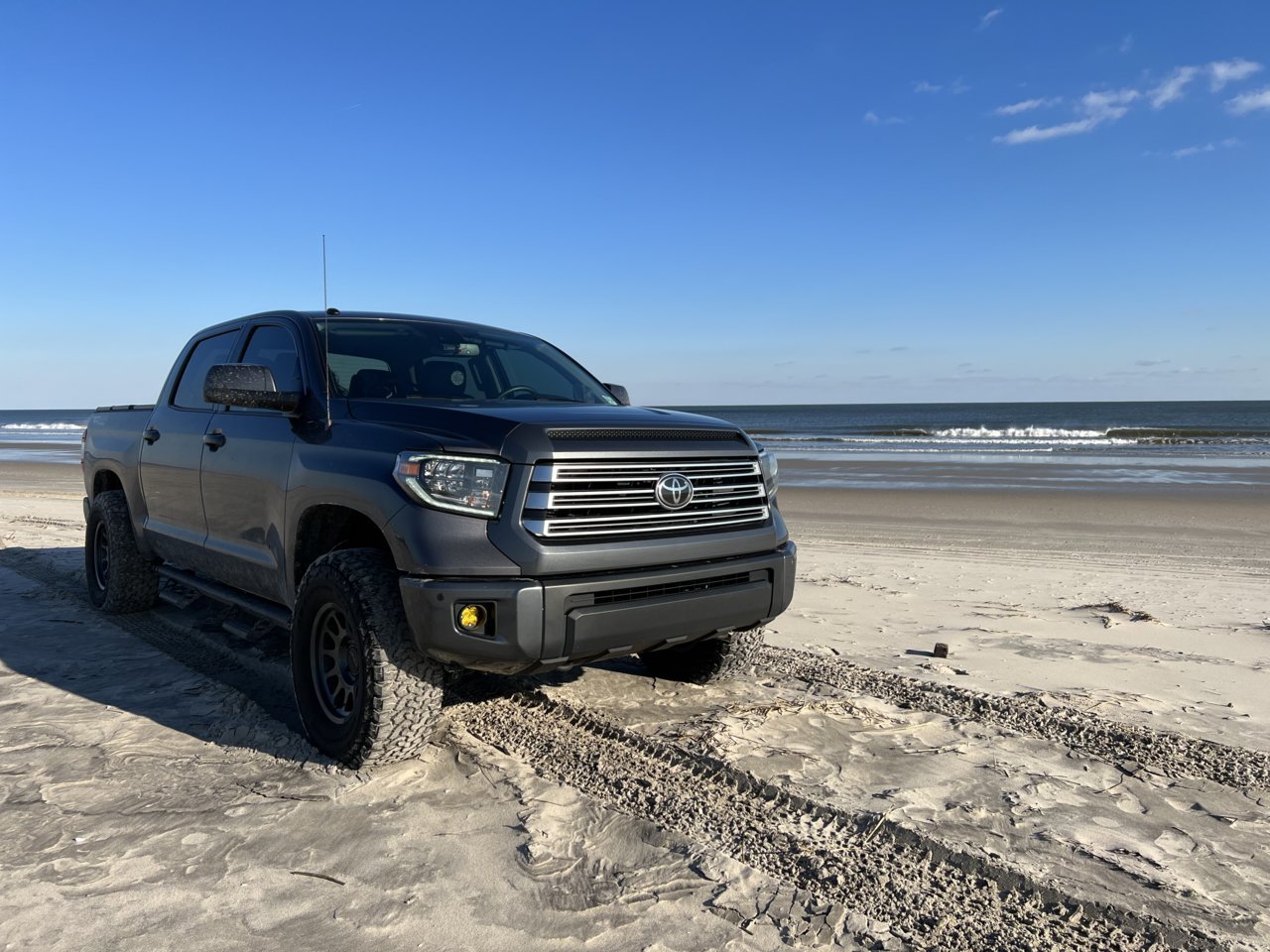

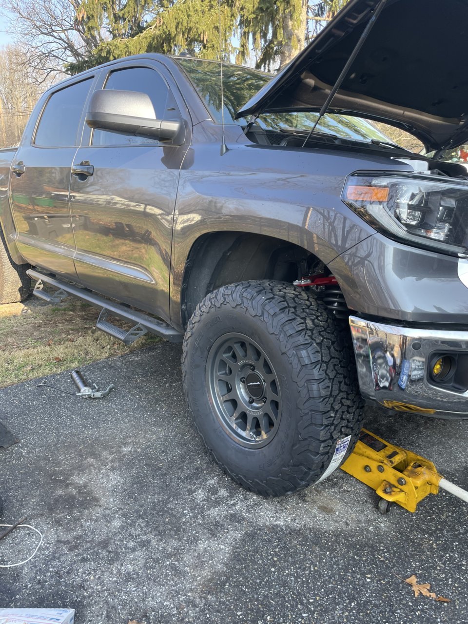

    7FF30B02-DDC8-4A80-97AA-9FE38307225A.jpg 48BE3530-C55C-4817-B012-0CD374659463.jpg 9421CC5F-E870-4868-993C-68F0C2A85F14.jpg

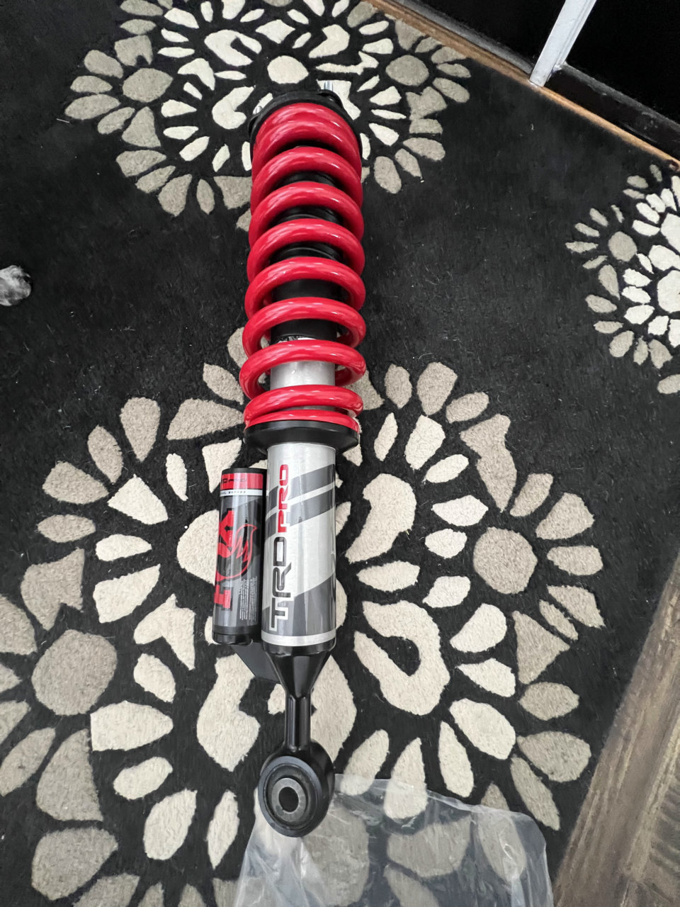

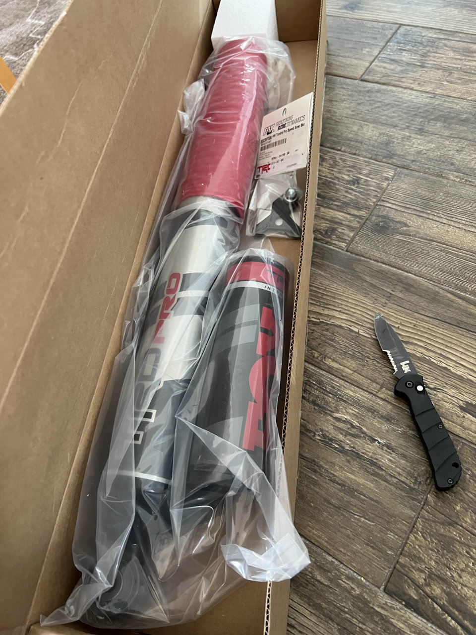

    Well parts are here, getting installed next week. Must say I am pretty excited! FD1DE360-350C-4291-BEE9-2F60AFE3B0A4.jpg 7C99F824-BA9B-477F-86CC-BF60E14049A7.jpg 54381300-683C-4DAE-904E-9D64BF1F238A.jpg 96C61FC2-160B-4CA6-91EB-54AF02AA8825.jpg

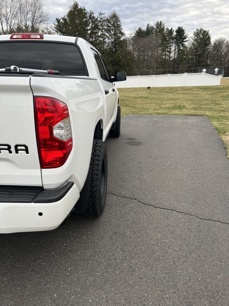

    Yes all installed. They do stick out but look great. I love the suspension. It feels solid but much more road compliant. Soaks up pot holes like they are not there. Have not taken it off road yet.

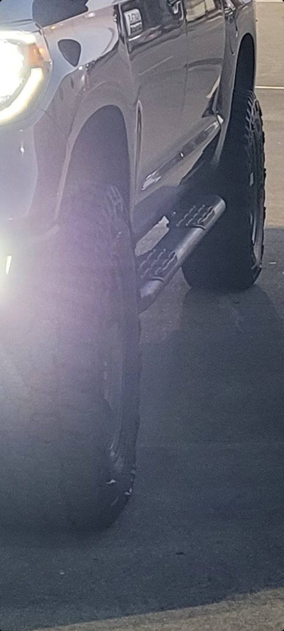

    @Sumo91 was your allignment shop able to get good caster/camber out of those Bilstein UCAs?
    Also, how close are your tires to UCAs?
    I got a set of 8112/8100s on order, looking at UCA options. Bilstein didn't publish recommended rim backspacing maximums for their UCA. Called them and no help there. I'm looking to use some method 17x8.5 +35mm which is 6.2" backspacing. Some other UCAs specifically list 5.75" backspacing maximum.
    285/75r17 +35mm would sit 0.19" closer to UCA than your 295/70r18 +25

    Bilstein 8112/8100 3.25in lift Dobinson leaf springs 2.1in lift Level8 MK6 wheels Big ole dent in bedside
    I believe I have plenty of clearance, ill have to check it out. My rims are +12 (?) Offset, they stick out an inch or two. My tires have a very aggressive sidewall as well, that probably sticks out another 1/2in or so.
    Here are some pictures I have that might show the offset a little betterScreenshot_20220427-225528_Gallery.jpg Screenshot_20220427-225458_Gallery.jpg

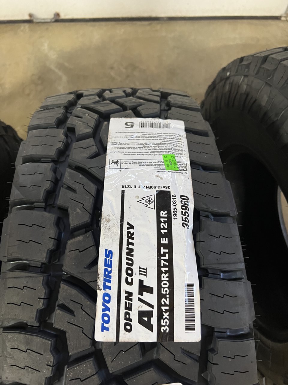

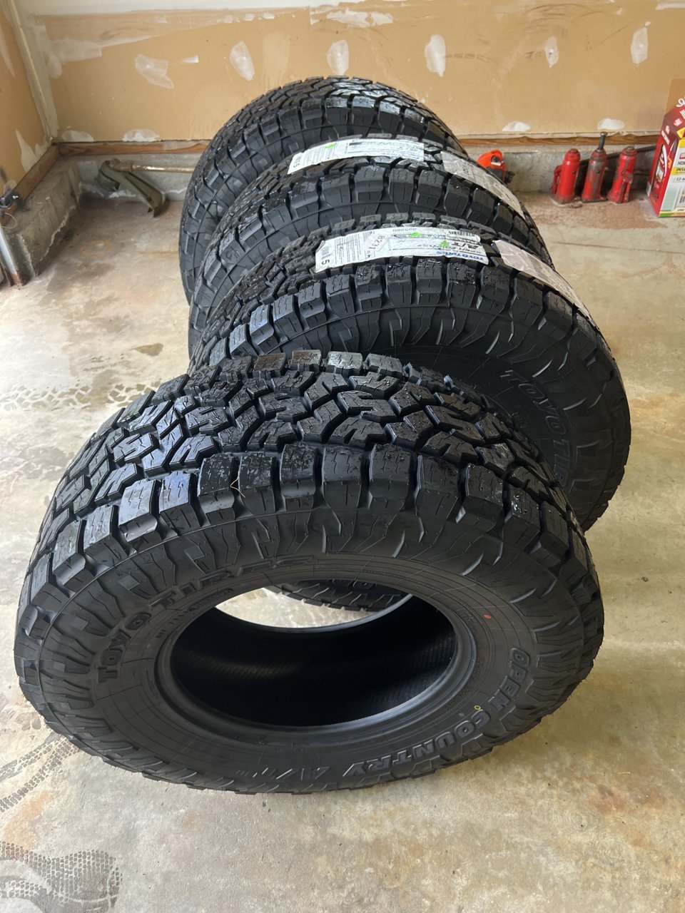

    Out with 285/70s in with the 35’s. Scored a new set on Facebook market place!637D1746-481E-41AE-8BA9-EDB714AB6173.jpg28798F47-318B-473A-8F2C-44B44E152F62.jpg

    It ain't the coils ya gotta worry about it's the knuckle on your spindle. If you're stock then you're good, but certain Readylift spindles are incompatible with SPCs

    How high do you have the front set at @SoJersey ? You're running the 8112's with the JBA UCA's?
    Any others installed the 8XXX setup since the posts in 2022?
