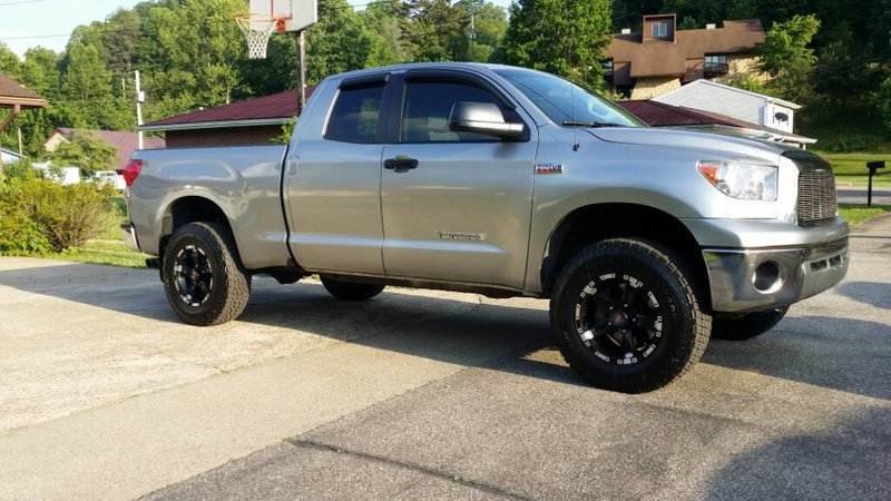

    Thanks for the info guys, it made things easier.
    Got everything on last night at about 1am. Front end aligned this morning.
    Cleaned it up today, got dark before I got any pics. Will post some tomorrow.
    I am VERY happy with the way it all turned out.
    Going to put on the hypertech speedo calibrator tomorrow.
    Here is one pic from yesterday eveving when I started.

    Here are a couple of pics.
    The front view shows how much tire is outside the fenderwell, which turned out the way I wanted.
    I will take some measurements and post soon. Been very busy.
    The OME full lift made the ride 10x better. Instead of a leveling kit, I recommend getting this. Several hundred dollars more but very worth it.

  8. Jun 1, 2014 at 7:42 PM
    csuviper
    Jan 6, 2014
    #38
    15,727
    Brian
    Broomfield, CO
    2019 TRD Sport CM 5.7L 4X4
    Looks awesome. Good work.

    :thumbsup: Looks great man, what size tires you running?

    295/70/18 on 18x9 rims +25
