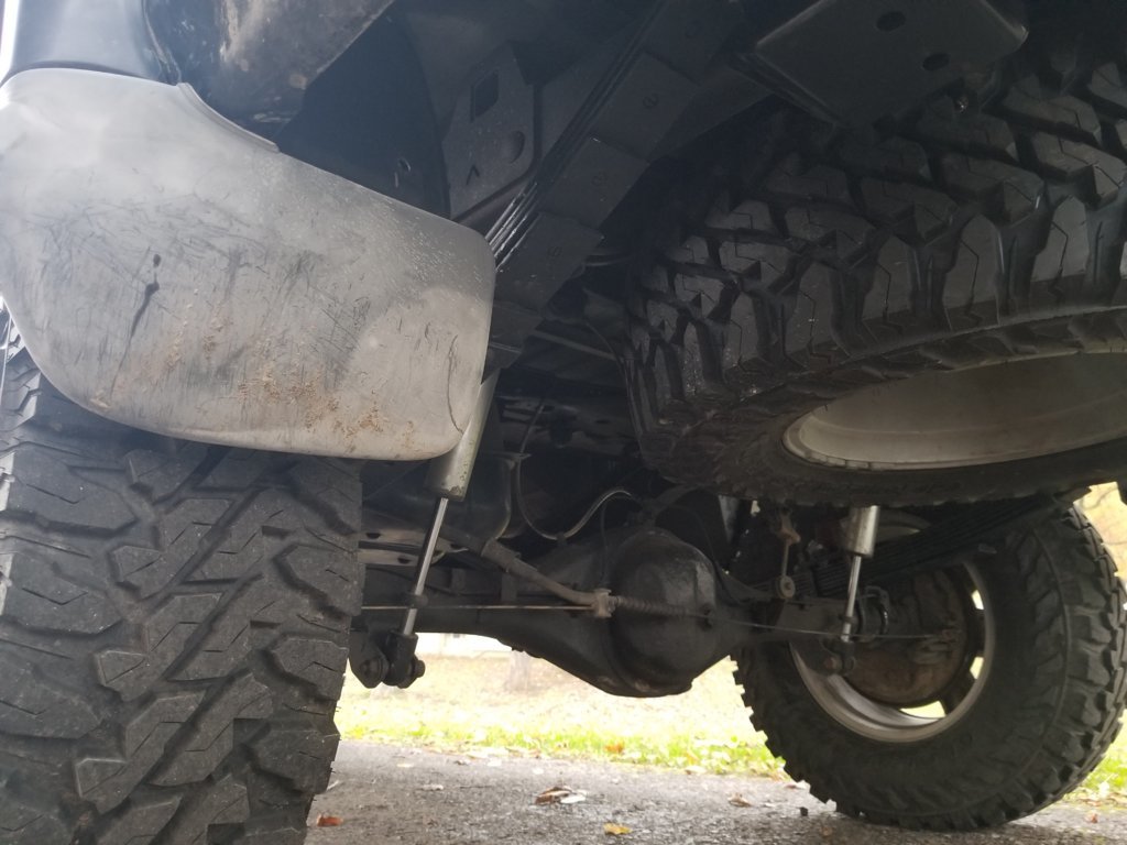

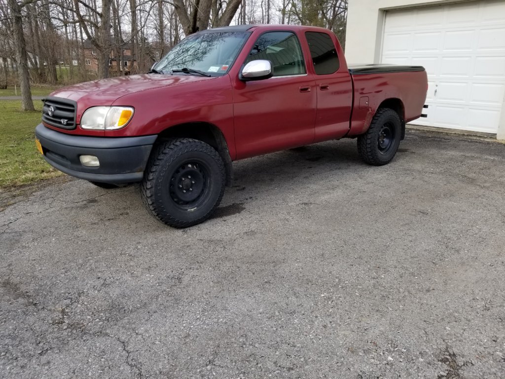

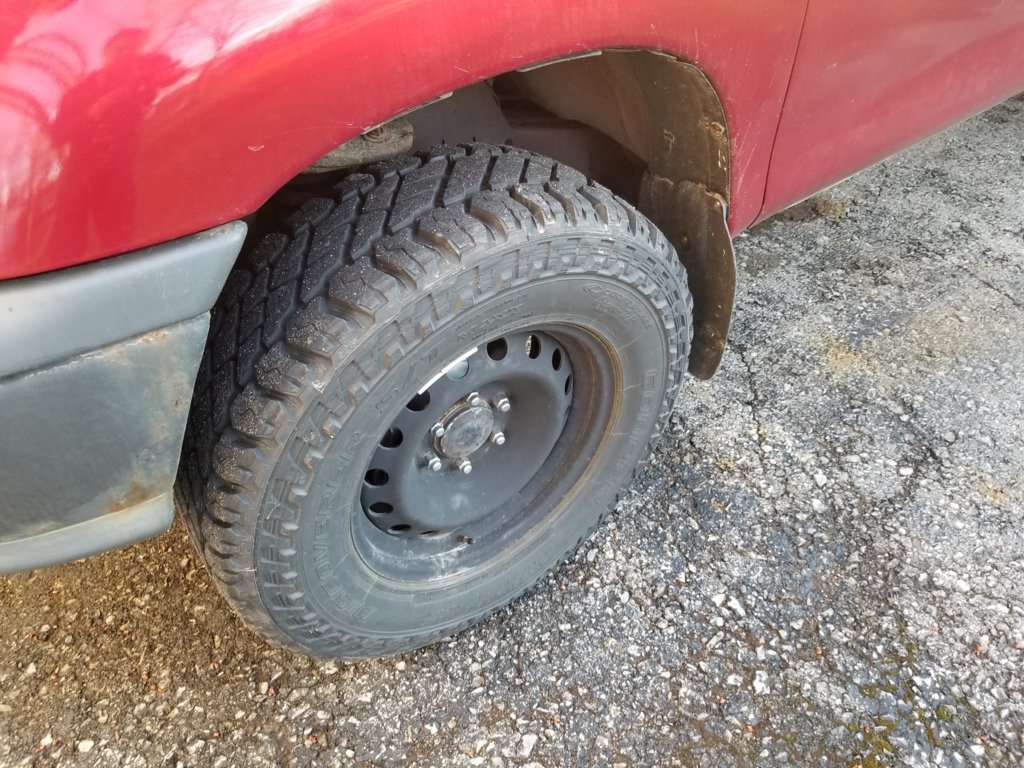

    Both fit in spare tire well on AC. As for mounted fitment, I had 255/80-17 32.8" Cooper ST Maxx on FJ steelies, (same as stock Tundra 17×7.5 +15) without a spacer. Cleared UCA fine as I remember, might have rubbed frame a little.
    Gearing sucked with 3.9s.

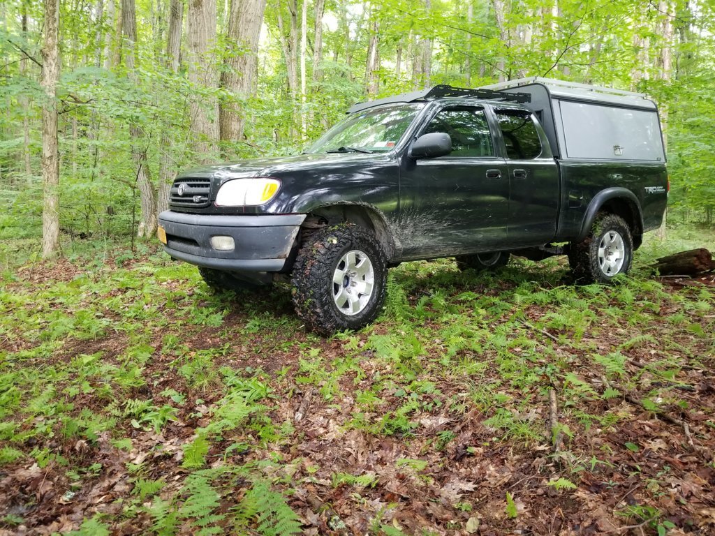

    Later I ran 285/70-17 32.8" Yoko MTs on FJs and combo required spacers.
    255/80-17 Cooper ST Maxx
    285/70-17 Yokohama MTs

    Rancho quicklift w/ ~1.5" front lift came on it, (terribly soft valving, don't recommend). Rear suspension was Archive Garage Ultimate package
    Same truck, I got a southern bed (black), painted cab black. I sold it and missed it ever since. Might buy another 1st gen soon, such good trucks.
