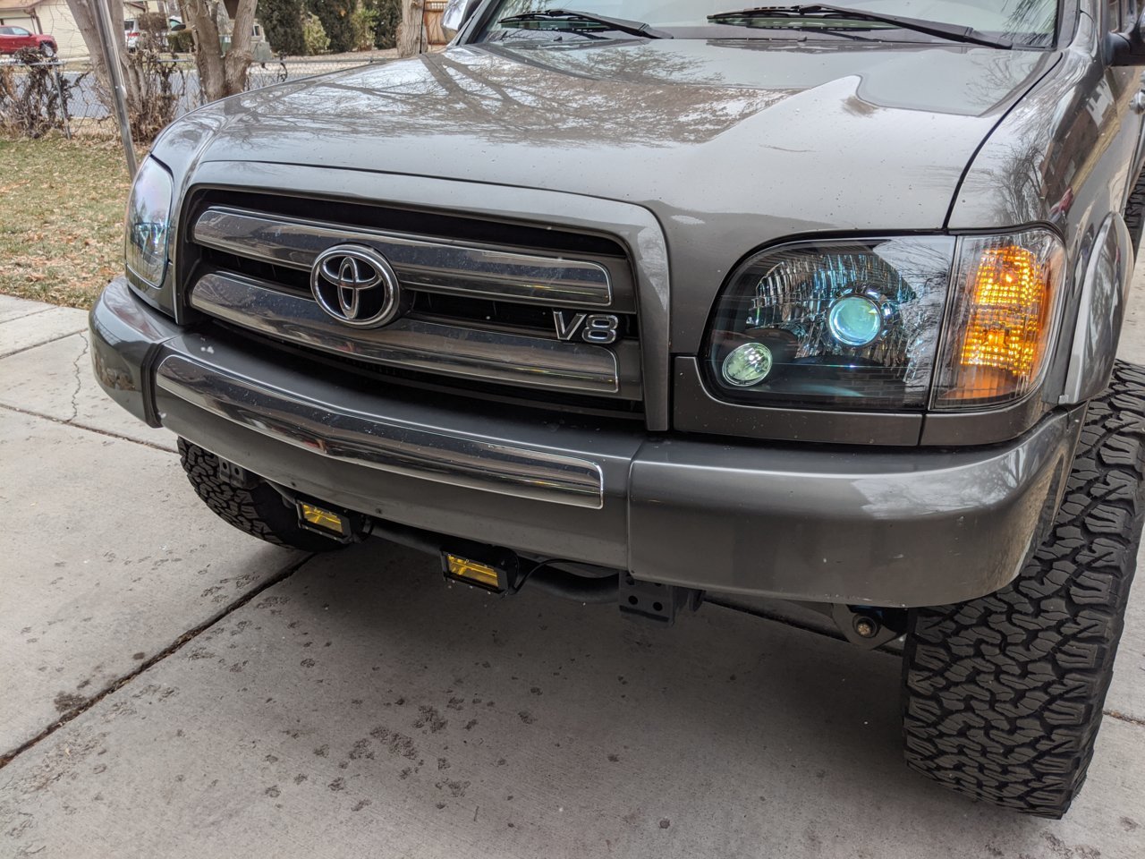

    Like you I couldn't find any quality upgrade headlight solution for my 2002 Tundra. I finally upgraded my 2002 Tundra Limited access cap headlights to Xenon HID's and have been extremely happy with the result for the past two tears. I used the Morimoto D2s projectors and 35 watt ballasts and their wiring harness which plugged into the original headlight harness for control and directly to the battery for power. I used Osram Xenon lamps in the 5200 Kelvin range because I didn't want super white or blue light. The project went very easy and could be accomplished in a single day. All products were purchased from The Retrofit Source and they were super helpful and have video help online. I also upgraded the fog light bulbs with their high lumen LEDs and used Lamin-X yellow film over the glass for better low road and fog contrast. The lights actually outperform my 2019 Tundra Platinum and with my 68 year old eyes the 2002 is my go-to vehicle for night driving. Even my wife prefers the 2002 at night. It has a very wide beam that lights up two lanes and the shoulder but a very sharp cut-off to prevent blinding oncoming traffic. I won't go back to the originals.

    Got a complete replacement from HID retrofit. Did the projectors. Lighting is okay bit as great as I would hope for ~$650 or so. Still better than what I had. And if I really need the light there’s always my light bar. Still need to wire up the halo and turn signal (halo will flash yellow when blinker on).
