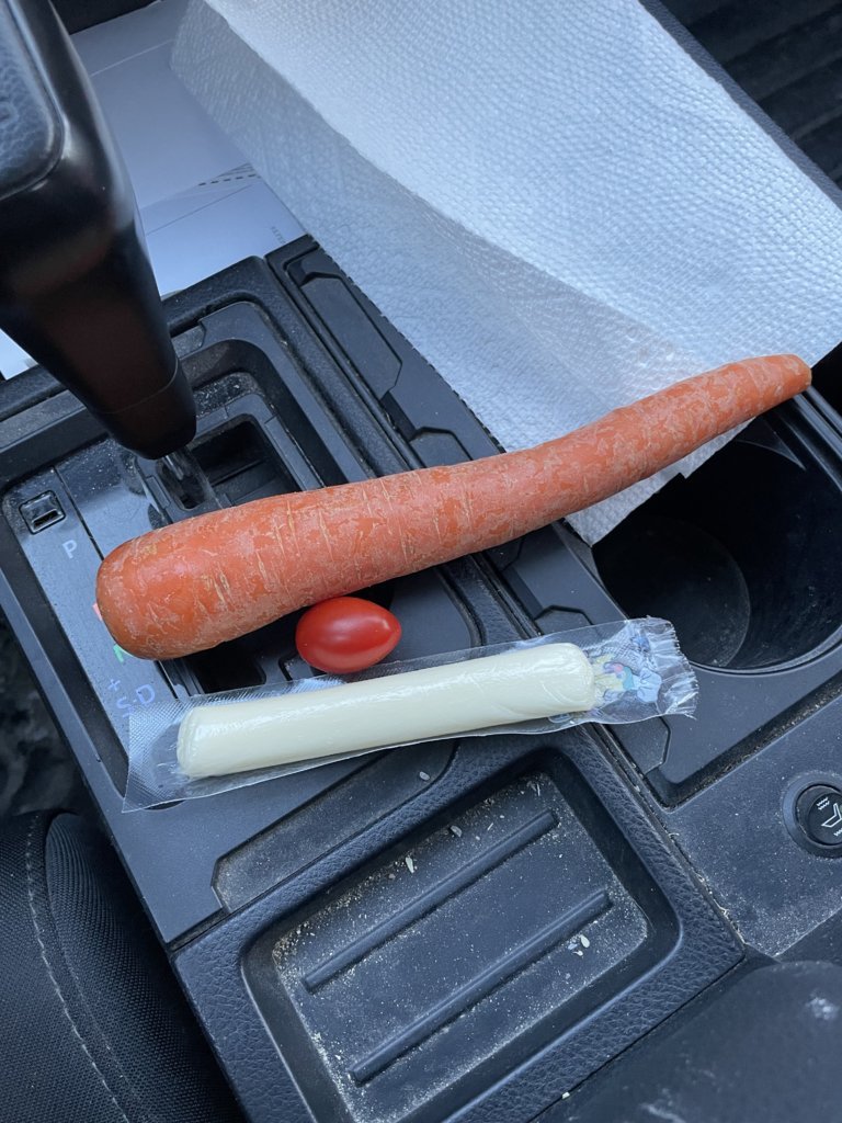

    Gonna need to see you do a carrot or something in there, like they were doing with the cybertruck trunk at first.

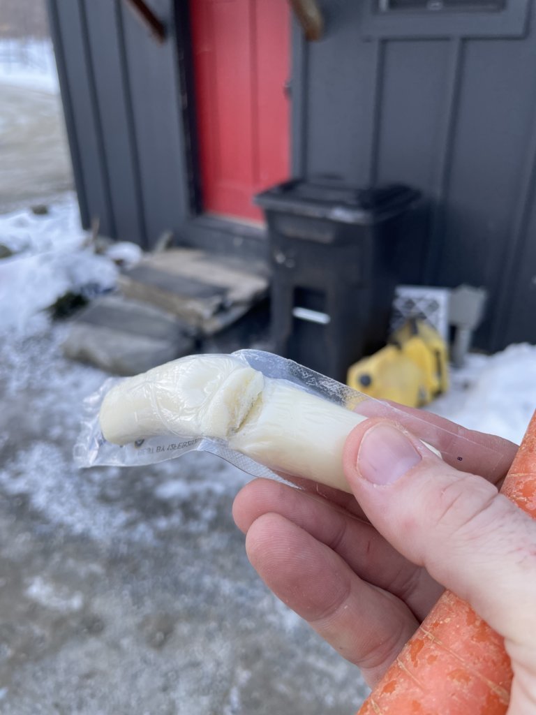

    I have them, I am being lazy, I might just mess around and shoot a video for you guys tonight. Do videos load on here or just photos?

    Be careful, side auto glass is very weak at the outer edge. Would make for an entertaining video though.

    I'm going to maybe try something softer then first. That's a good warning I do not want to shatter that in the middle of winter. What a nightmare that would be!

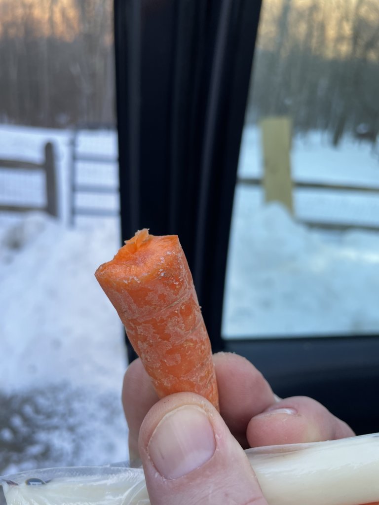

    I do it for the people :humble:
    That cherry tomato had me a little worried, it was the longest I could find:rofl:

    Funny sh!t. :thumbsup: Thanks for the laugh.

    You should post that in the sticky thread so members know how strong these window motors are.

    Would be interesting to see those same tests with the stock switches to see at what point the window stops and reverses.

    The stock switch which don’t have auto up would not reverse if you held the switch and the glass meets an obstruction. The optional auto up feature on Toyota vehicles reverses with very little resistance. If you just bump the window downward with your hand as it is going up it with reverse.
