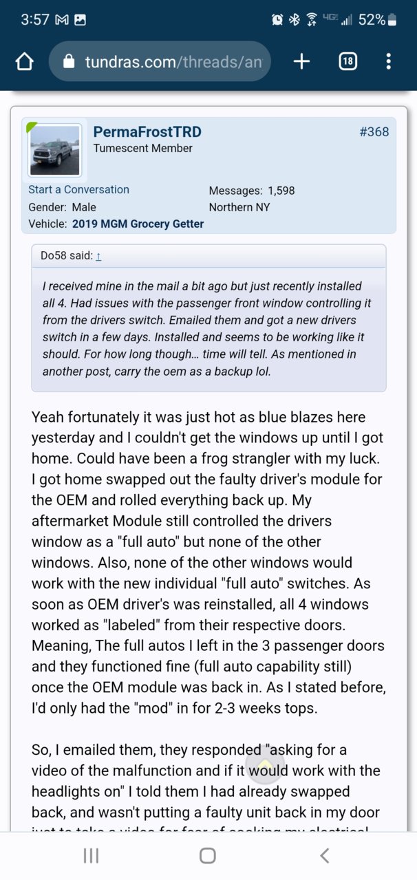

    Yeah fortunately it was just hot as blue blazes here yesterday and I couldn't get the windows up until I got home. Could have been a frog strangler with my luck. I got home swapped out the faulty driver's module for the OEM and rolled everything back up. My aftermarket Module still controlled the drivers window as a "full auto" but none of the other windows. Also, none of the other windows would work with the new individual "full auto" switches. As soon as OEM driver's was reinstalled, all 4 windows worked as "labeled" from their respective doors. Meaning, The full autos I left in the 3 passenger doors and they functioned fine (full auto capability still) once the OEM module was back in. As I stated before, I'd only had the "mod" in for 2-3 weeks tops.
    So, I emailed them, they responded "asking for a video of the malfunction and if it would work with the headlights on" I told them I had already swapped back, and wasn't putting a faulty unit back in my door just to take a video for fear of cooking my electrical system. Haven't heard back, but from the cadence of the emails, it sounds like they're on the other side of the world. I'll continue to update as things progress/ change.

    Update:
    received an email last night saying they will ship me a replacement and return label as soon as possible. :thumbsup:
    just a little patience due to the time zone thing but it seems like they’re trying to stand behind their product. :cheers:

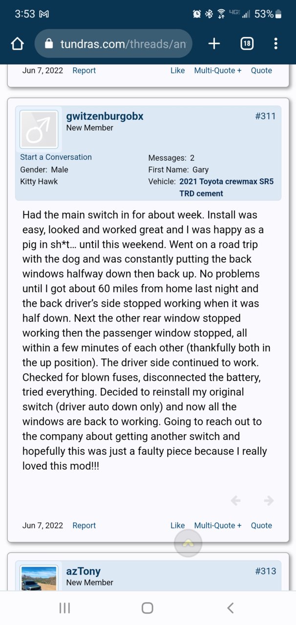

    I just received my replacement after having the same issue a few weeks back. They asked for a video as well but I had already switched mine back to the OEM. After a few back and forth emails they eventually agreed to send a replacement. I plan to install it this weekend but Im going to keep the OEM in the truck just in case this happens again and I need to switch it out on the road. But I would suggest to anyone else that has issues with theirs to take a video before switching back to the OEM. It will make getting a replacement a little easier and probably a quicker turnaround.

    As promised - update to my part exchange:
    Got the new drivers module in today. Well packed and quick!! (Less than a week). Just installed and works as advertised. Let’s hope this one goes the distance instead of a 2 week lifespan. Very impressed with the customer service of cartrimhome.com

    Actually the 3 passenger switches worked as full autos even with the OEM back in this last week. They didn’t work at all with the faulty drivers module.
